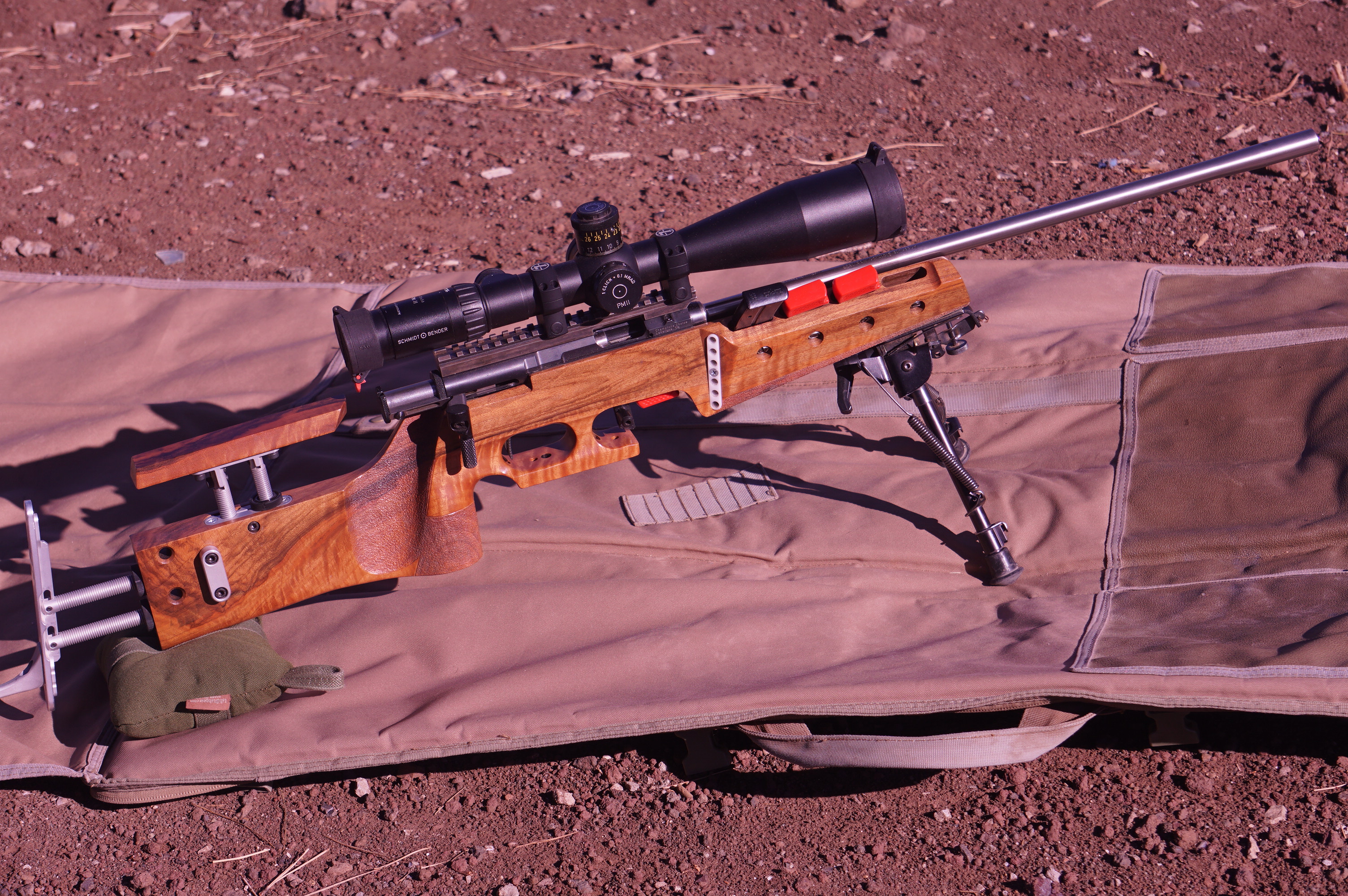

Here's my match 22rf which is a Anschutz 1827F biathlon. It averaged .26" in the Jbells 50Y 6x5 when I first got the gun a decade ago. It has occasional POI shifts though which I haven't been able to figure out totally yet, despite bedding, having a steel pic mount made, etc.
And I'd still like to get a Vudoo at some point!
