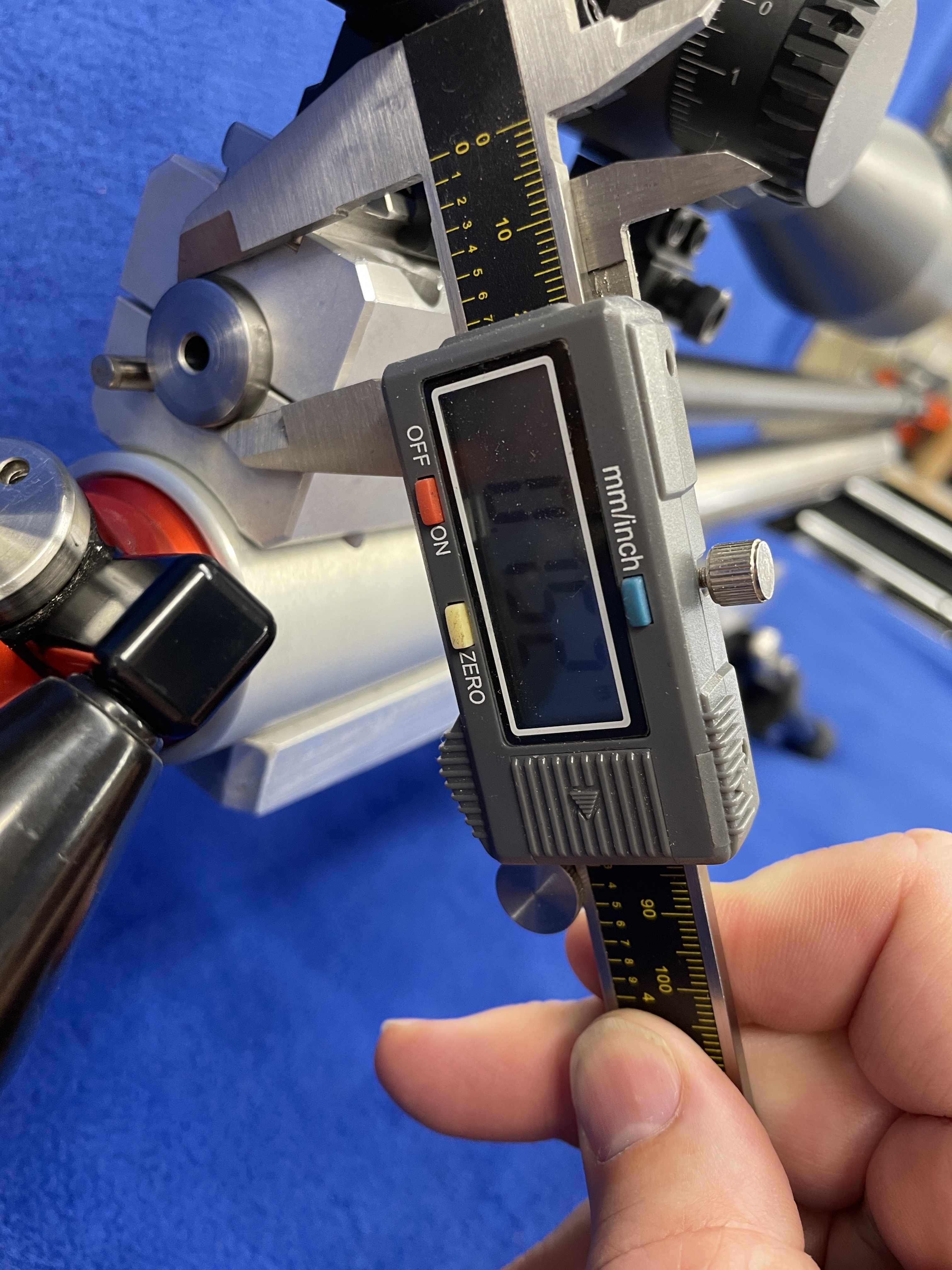

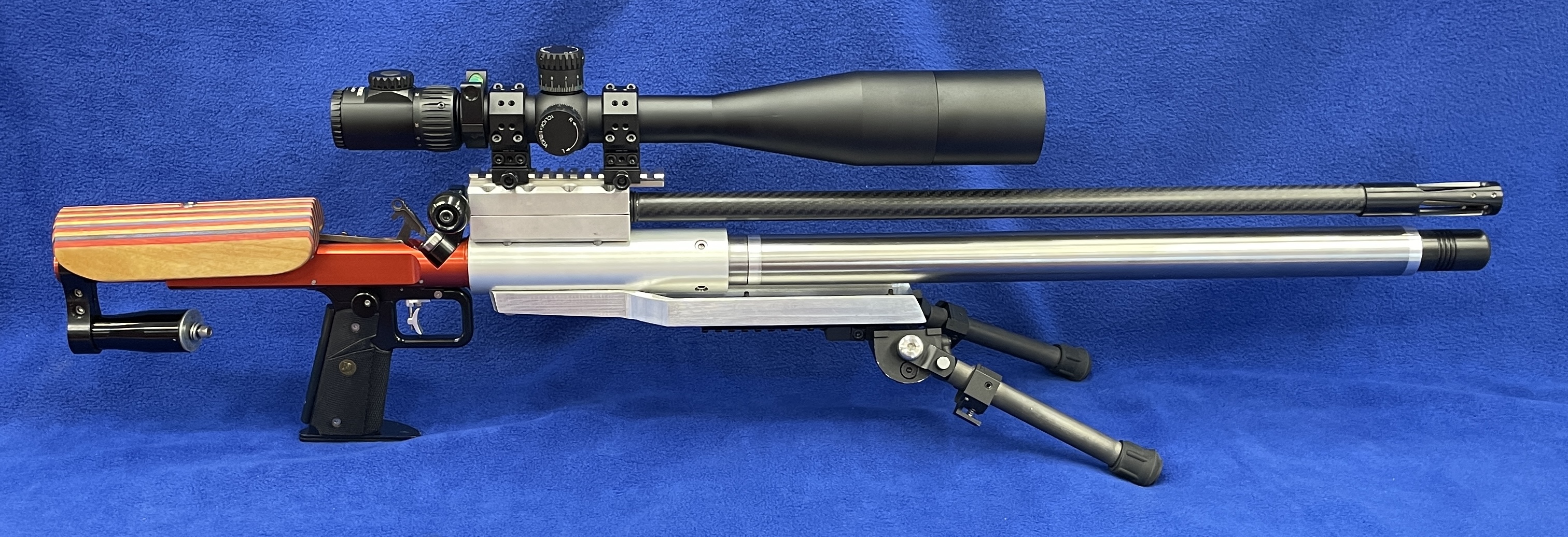

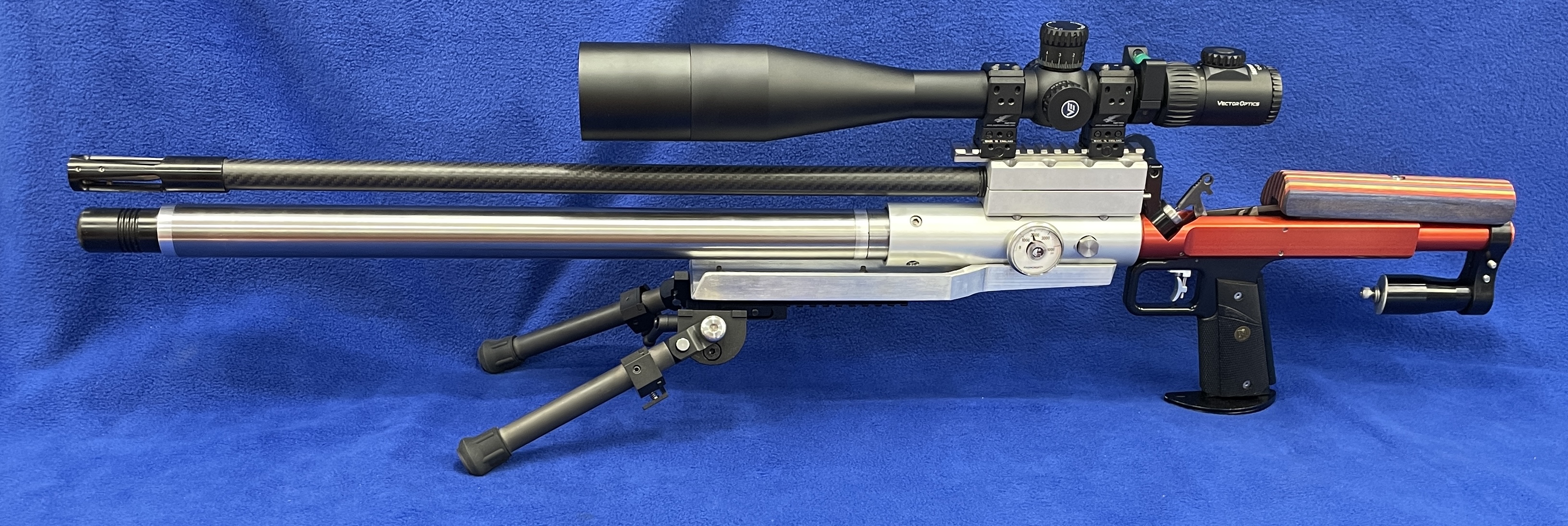

Lilja 3 groove 3/4 inch diameter .177 on this USFT. It WORKS!
There was a considerable amount of customization done to this action. The trigger is the same as a typical USFT. The complete barrel mounting housing is custom. The lower tube is AZ built from titanium. It is dual regulated, and a bunch of other stuff as explained by Tim McMurray. It was built for Lindsay who was an outstanding competitor prior to her unfortunate and untimely passing. I never got to meet her but I wish I had, she definitely knew what she wanted and had great taste. The trigger is a single stage at about 4.5oz.
It may well be the most accurate .177 gun I have ever shot. I can't compare it to an original barrel since it was already setup this way when I got it.
makes me want one (usft) more than b4 i saw this
