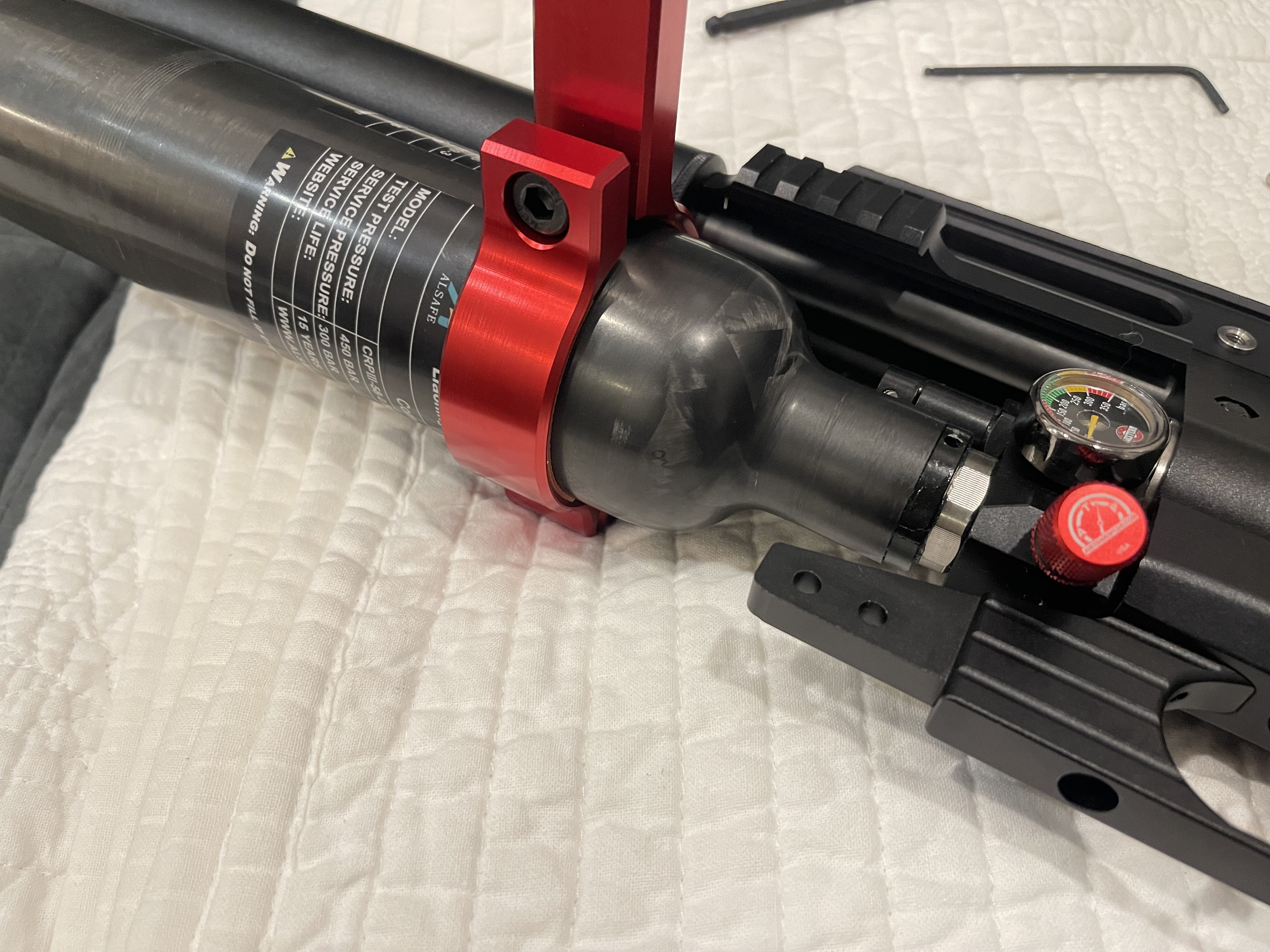

Anyone else still get freaked out dealing with the high pressure air in PCPs? Sometimes I wonder if I picked the wrong hobby or this is something that goes away over time. I just finished a barrel polish on my Rattler. Reassembled the whole thing, screwed the valve back in the CF 580cc tank, applied fresh silicone grease and then screwed the tank back onto the gun. Hooked up a 9L tank and turned on the gas, heart rate jumped a bit when I heard the “click” even though I knew it was coming 😅. Heard a hiss, knew it had a leak and noticed it looked like the silicone grease was blown out from one spot where the bottle valve connects with the gun. Tried hand tightening a bit more and it reduced the sound but it was definitely still there. Dropped from 200 bar to empty in an hour. Okay, used my saber tactical degassing kit to clamp around the tank so I could tighten it even more. Also tightened (with my hand), the second regulator gauge as there was a super slow leak from that prior to performing any work.
While doing so, I can’t help but be concerned about-
  1. Damaging the tank by applying a ‘crushing’ force from clamping around the CF tank.
  2. Over tightening the tank to the gun and causing an issue from the torque.
  3. Damaging the threading on the gauge to the point it turns into a projectile.
In order of the points above, I know these tanks are designed to be really strong but is there any good documentation on what type of external compressing force, or torque they can safely take? #2 Similar thing, we always just say, “hand tight”. What is hand tight, I like having numbers, how many ft/lbs of torque is considered hand tight? #3 again, what are the numbers? I asked AoA a year ago when I had the original leak from the plenum gauge and they said that information wasn’t available.
How do I know I’m not damaging anything or reducing the structural integrity of the device(s)?

Just a note. The worst kind of lubricant you can put on metal to metal surfaces is silicone. You should never put silicone lubricant on bottle valve threads or the male threaded part of the gun. If you did you will probably find it really fun the next time you try to remove it. The HP air doesn’t really phase me. Probably 100000 x more likely to be maimed or killed driving as I do over 3k a week. I don’t think about the air much. Maybe I should.

It was on the oring and it was on the metal-metal contact as well. I genuinely don’t know the reason why not. Could you please educate me on the issue with doing this? Thank you!

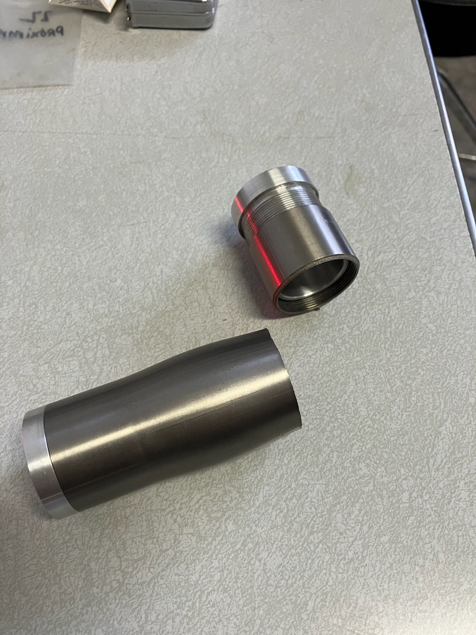

I'll never get use to it. I made my own Titanium tubes for my guns and had them sent out for destructive testing. They popped at 17,350 psi and I still pucker up when filling them.
Damn, that’s friggin sweet! Do you machine it yourself? Also thanks for the feedback, makes me feel better knowing I’m not alone.

The reason is it can cause galling on the metal to metal surfaces. Tom from AAA made a point of this in some other threads where a user had two parts pretty much fuse together. Now Tom uses Very Fine threading and most others are more coarse. Galling is less likely on the coarse threads - but still a posibility.

I don’t know why all I know from experience is that it acts more like glue on metal to metal surface. I used it once on a break open shotgun. After a bit I could hardly open it. Was crazy then someone told me never use silicone on metal to metal.

Well, I used silicone grease for probably ten years on pcps and never had any galling issues, o rings stayed lubed better than silicone oil by itself and I’ve had zero corrosion issues internally on parts coated with silicone, even with extensive hand pumping with no filter. It does serve a purpose.
I did however buy the krytox lube after Tom recommended it for my Evol… only because he built it and that’s what he recommends for it.
