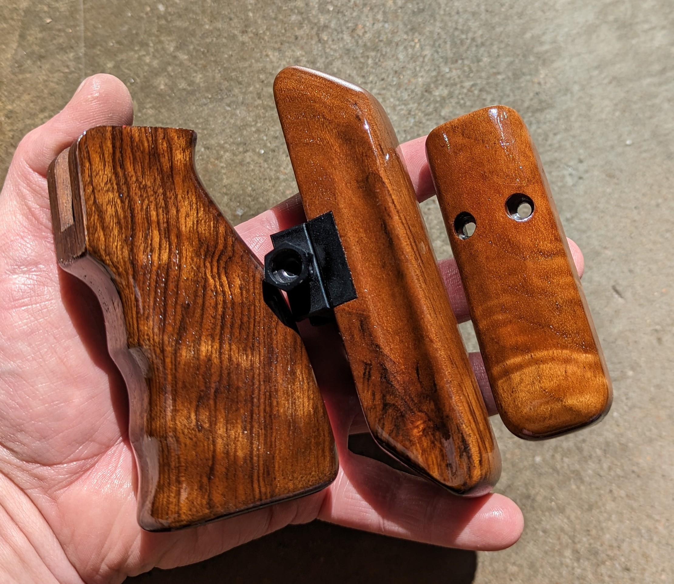

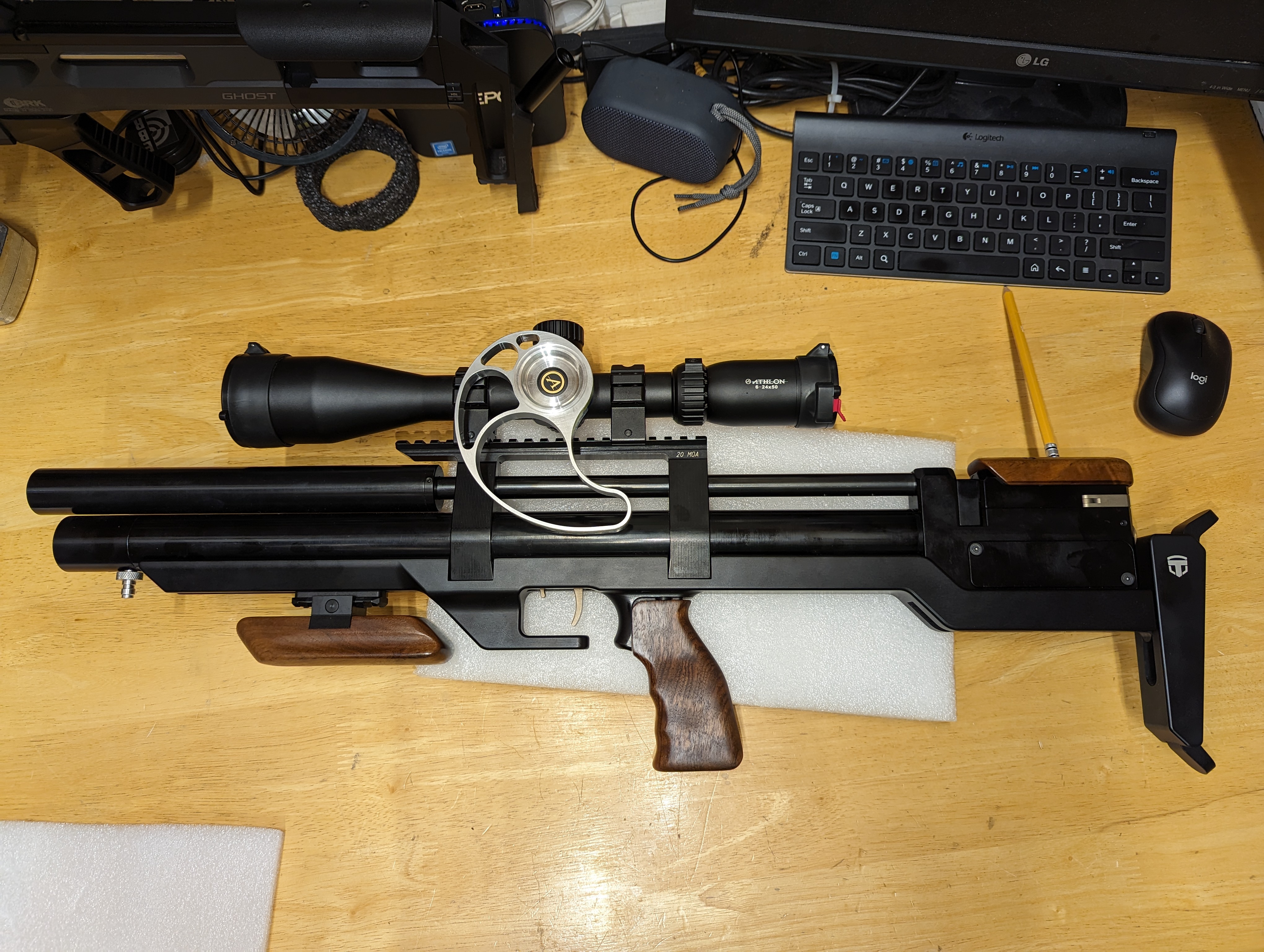

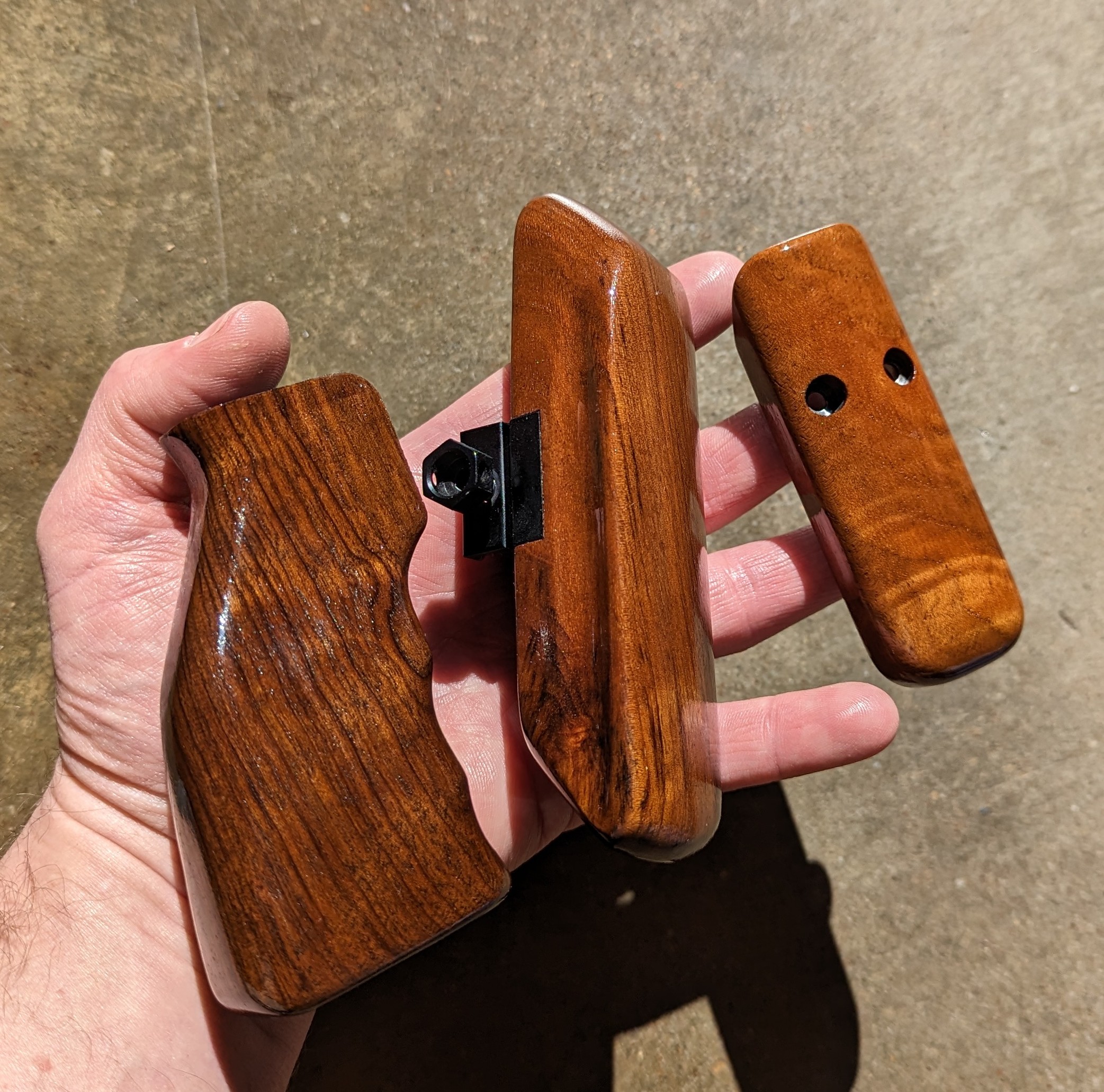

And yes, I had to try it on some gun related stuff. Here's one coat applied to the walnut wooden bits of a Vet chassis stock. 24hr cure time for this one coat so it's dry and not tacky, although the high gloss makes it look wet.
And what it looked like before the Epifanes....
High gloss isn't for everyone, but if you like the look, Epifanes is an option.
The secret to a long lived varnished surface is to maintain it. It will still look great next year, but the surface coat has degraded thru UV exposure. Scuff lightly, and apply a top coat annually, and it will appear new indefinitely. Any dents into, or thru the film should be spot coated, then top coated along with the rest of the door. Epifanes is my varnish of choice. Looks great! John (retired wooden boatbuilder).
