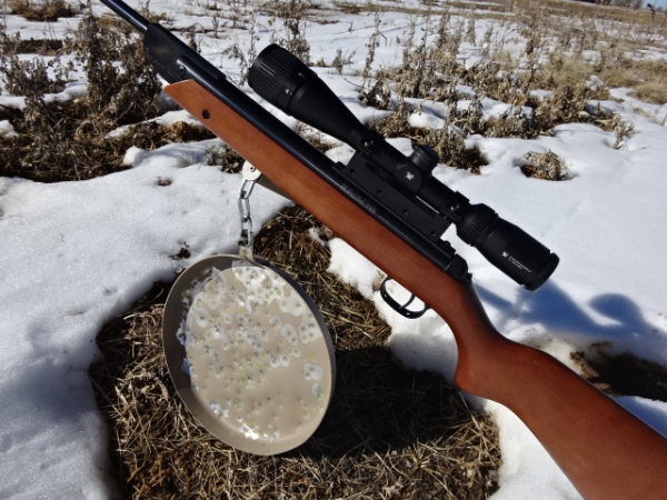

Your intended uses for the purchase makes the choice simple. The model 34 .22 hands down. It is also the cheaper of the three you mention and can be found on sale often. My two are very accurate with quality HN pellets. My Vortex scope might not be the "very best" available, but it is spring gun tough. It has the best warranty in the business. I have two Vortex 4-12X Crossfire II's on the 34's. I am a half tin shy of 10,000 shots fired on one I bought about five months ago. It can be found for around $165.00 - $180.00 most places. How about a picture of one of them. I only shoot offhand and that 10" pan is 125 yards from my firing point. It is a plinking fun gun set up for sure.
