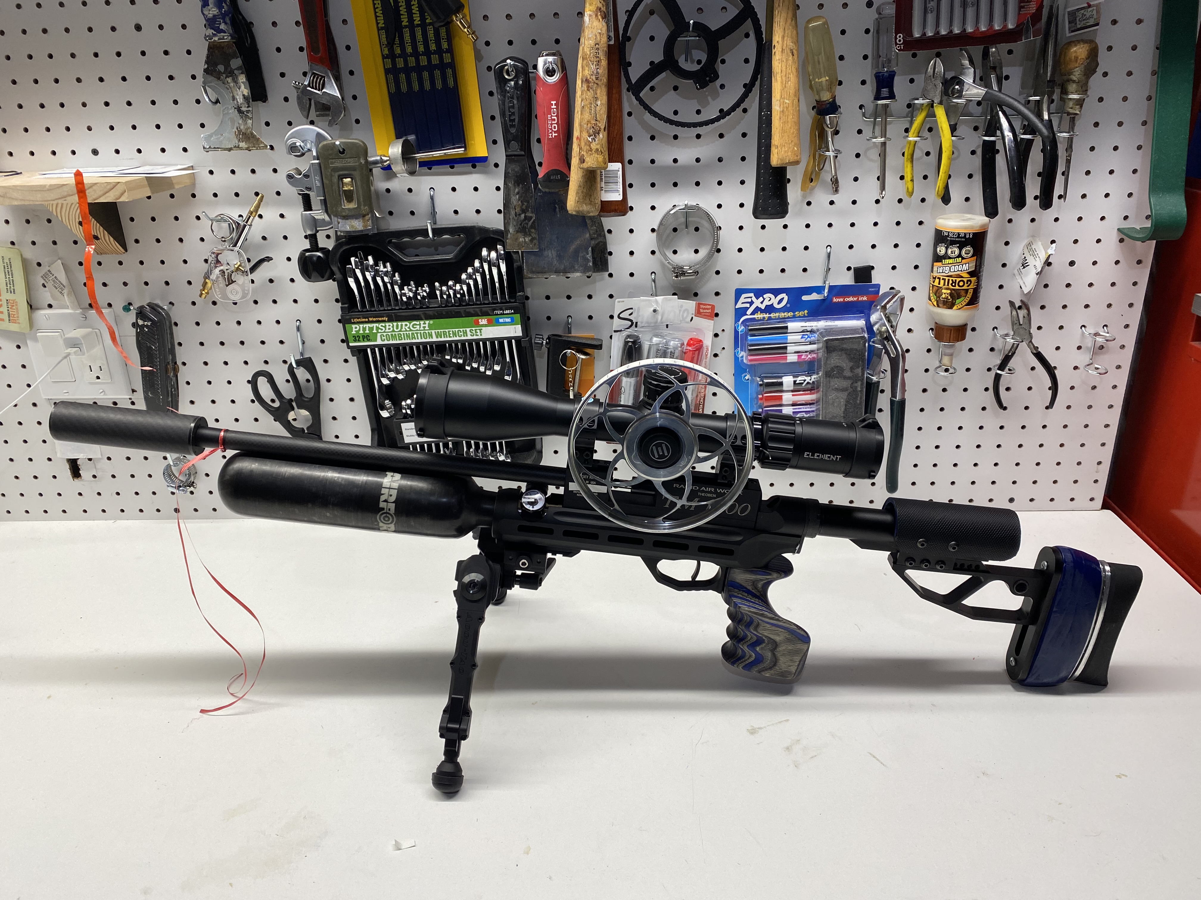

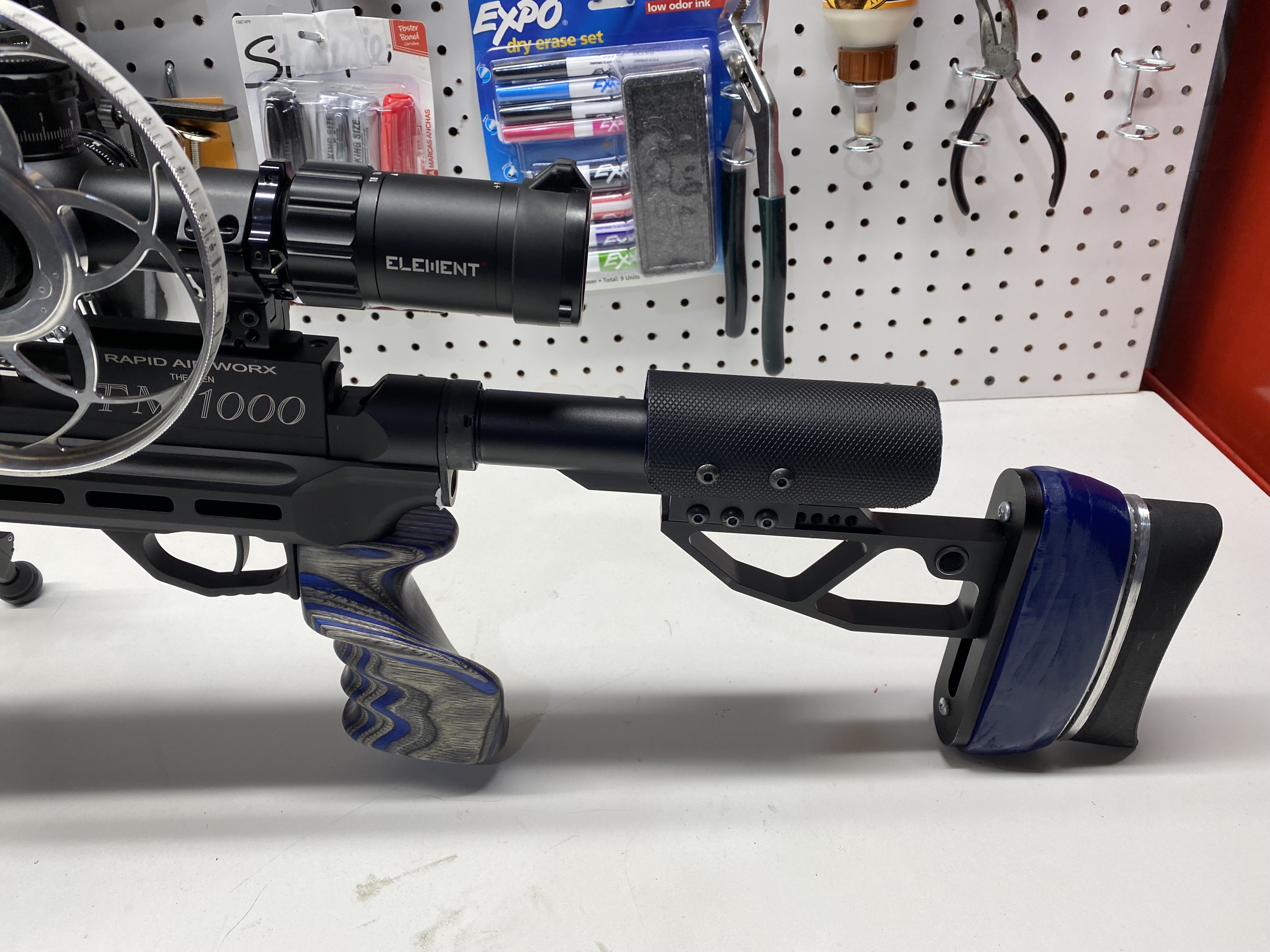

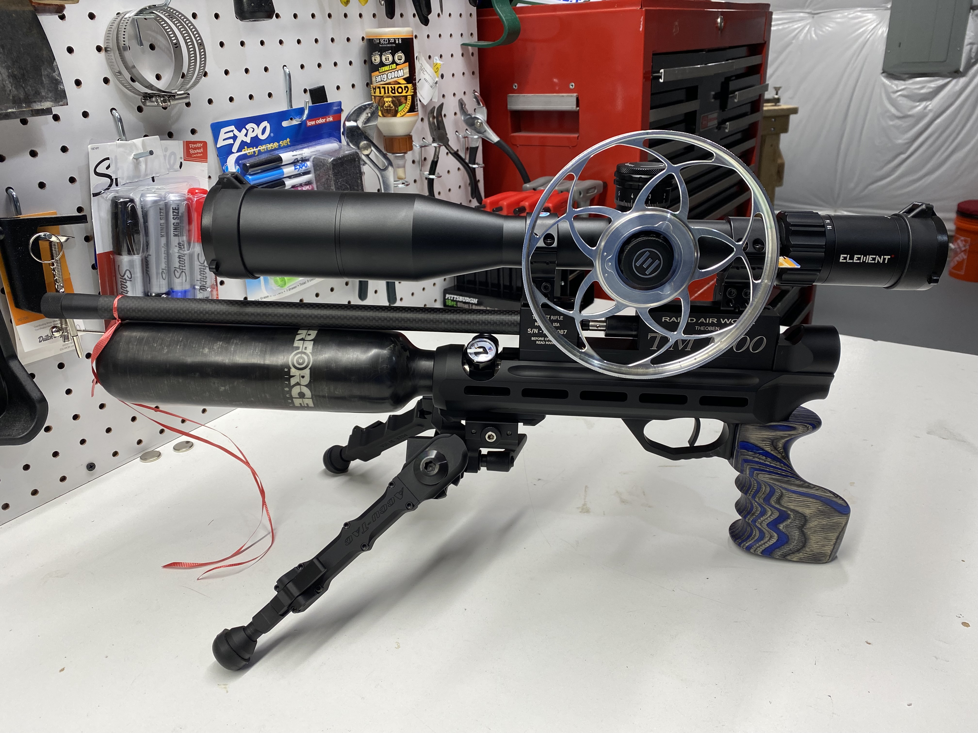

Call The Master Martin at Airguns USA, tell him what you’re thinking and he’ll get you sorted pretty quick. He did this pistol/rifle setup for me including one of his custom grips. If not for a marginal operator it is capable of winning in HFT😂
