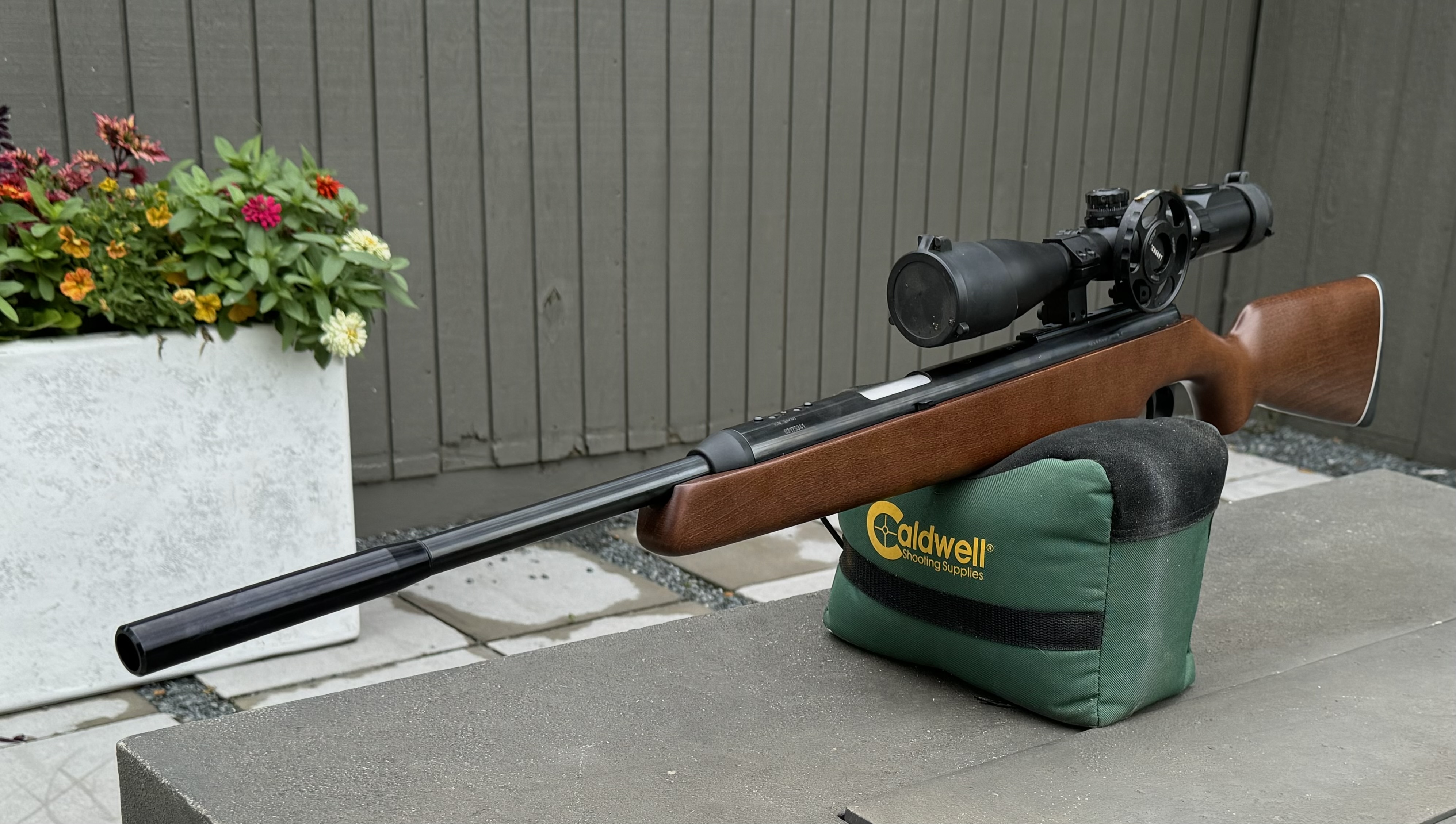

I found an RWS Diana 48 in the box for a good deal.
I have a TX200 for WFTF class and don’t want use it for hunter because the scope is 40x magnification. And I want a more powerful gun for HFT.
American HFT sitting on a bucket with a set of sticks.

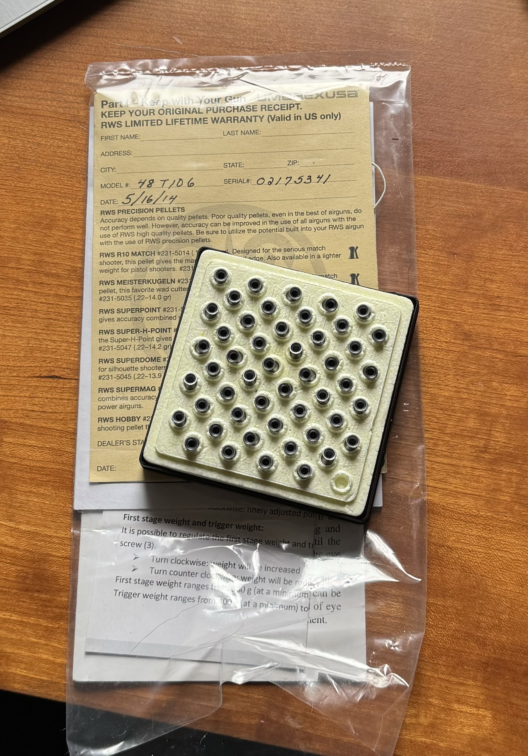

This particular rifle is like brand new and came with a tin of pellets and one missing.
First owner shot it once . Second owner never shot it.
So it’s like brand new.
I mounted a nice scope and did some shooting and it is definitely a cannon. The trigger is really nice. The rifle is a 2014 with a T-06 trigger.

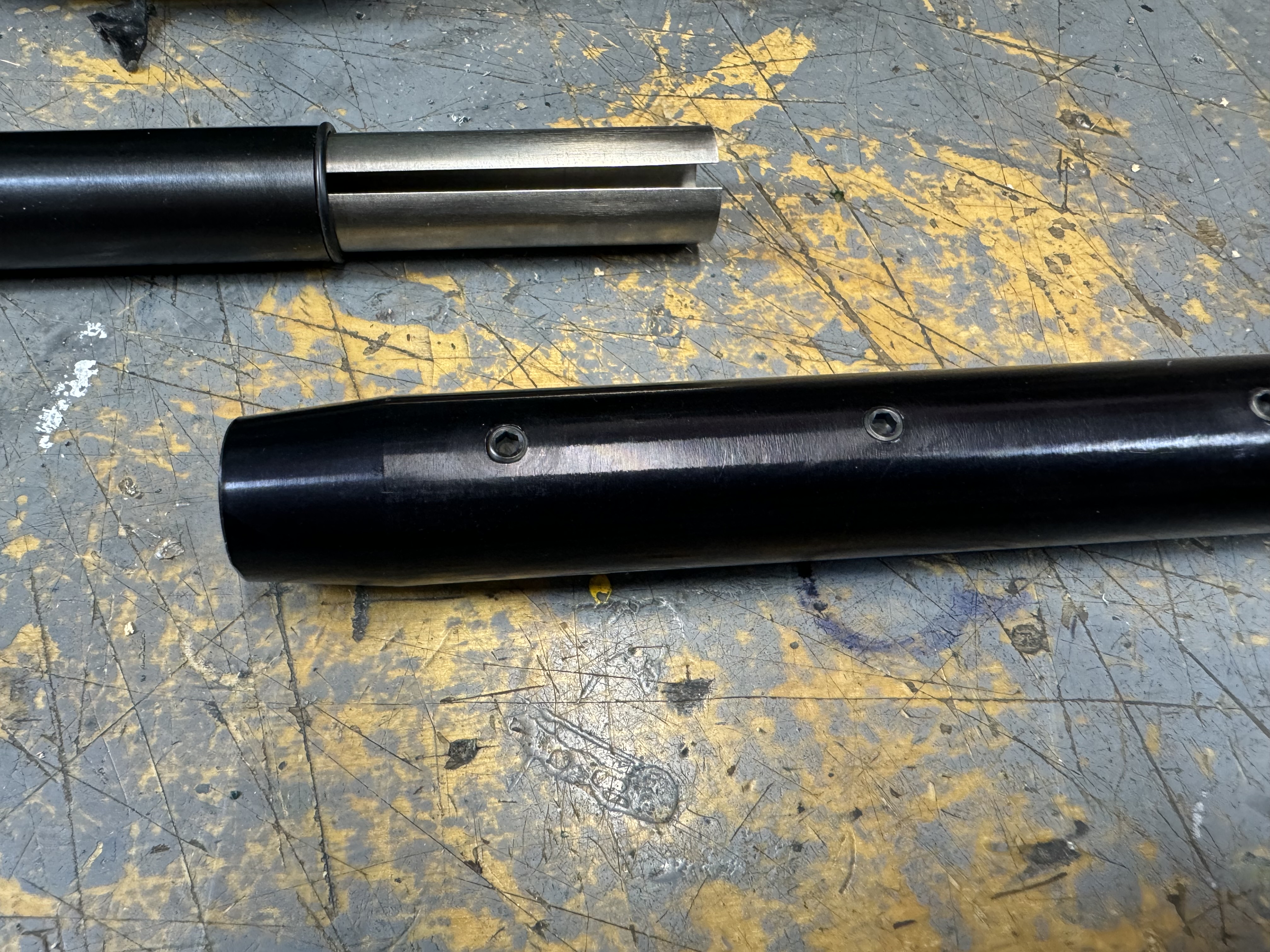

First thing is to remove the front sight and add a muzzle brake. I got one from Air Venture. I had to cut the sleeve around the barrel but it fits great.
Next I’m going to get a spring kit to slow it down and smooth it out.
Tomorrow I am going to get to shoot it for real. Going to a new shooting location and chronograph it and set up FT line with target
Stand and bench prove the scope and shoot the gun like it is. Just to brake it in and practice. I’ll do it all over again after I get the spring.

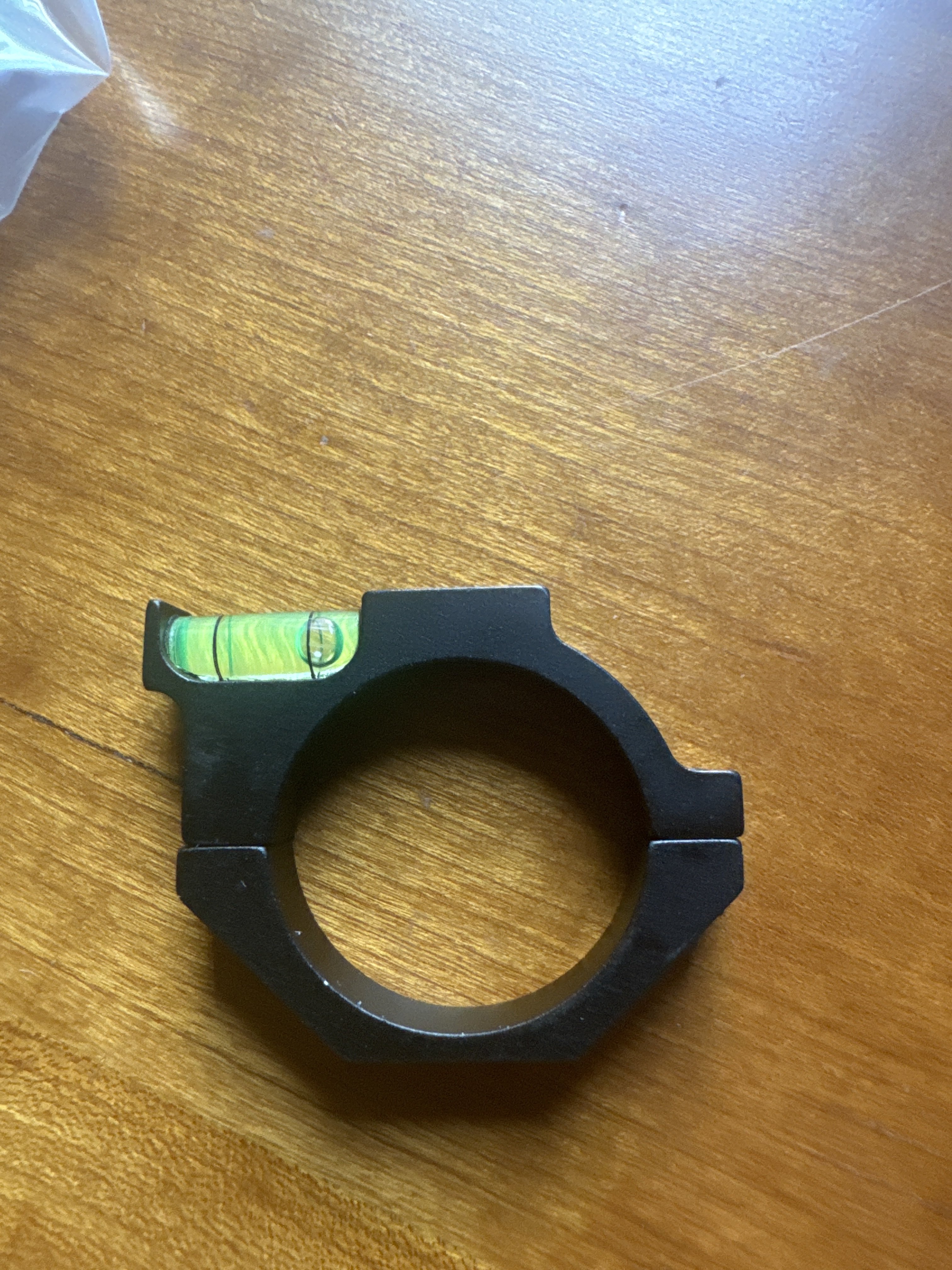

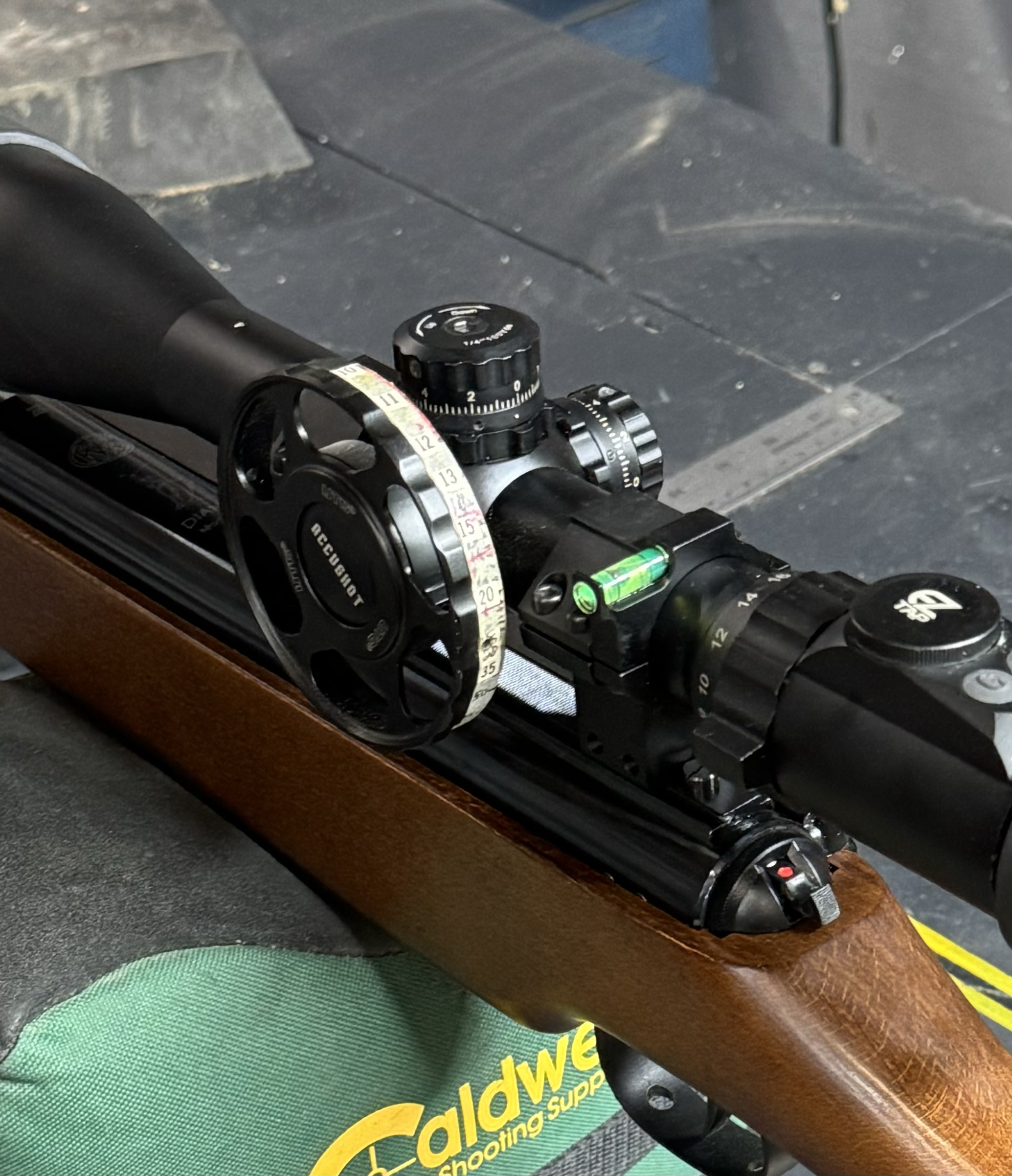

Today I got a level in the mail.

I mounted this very inexpensive level on my scope. I have a habit of opening my left eye to look at the level . This one is very small and sits very close to the tube. When I open my eye it like superimposes the level in my sight picture. Like a hitech heads up display.

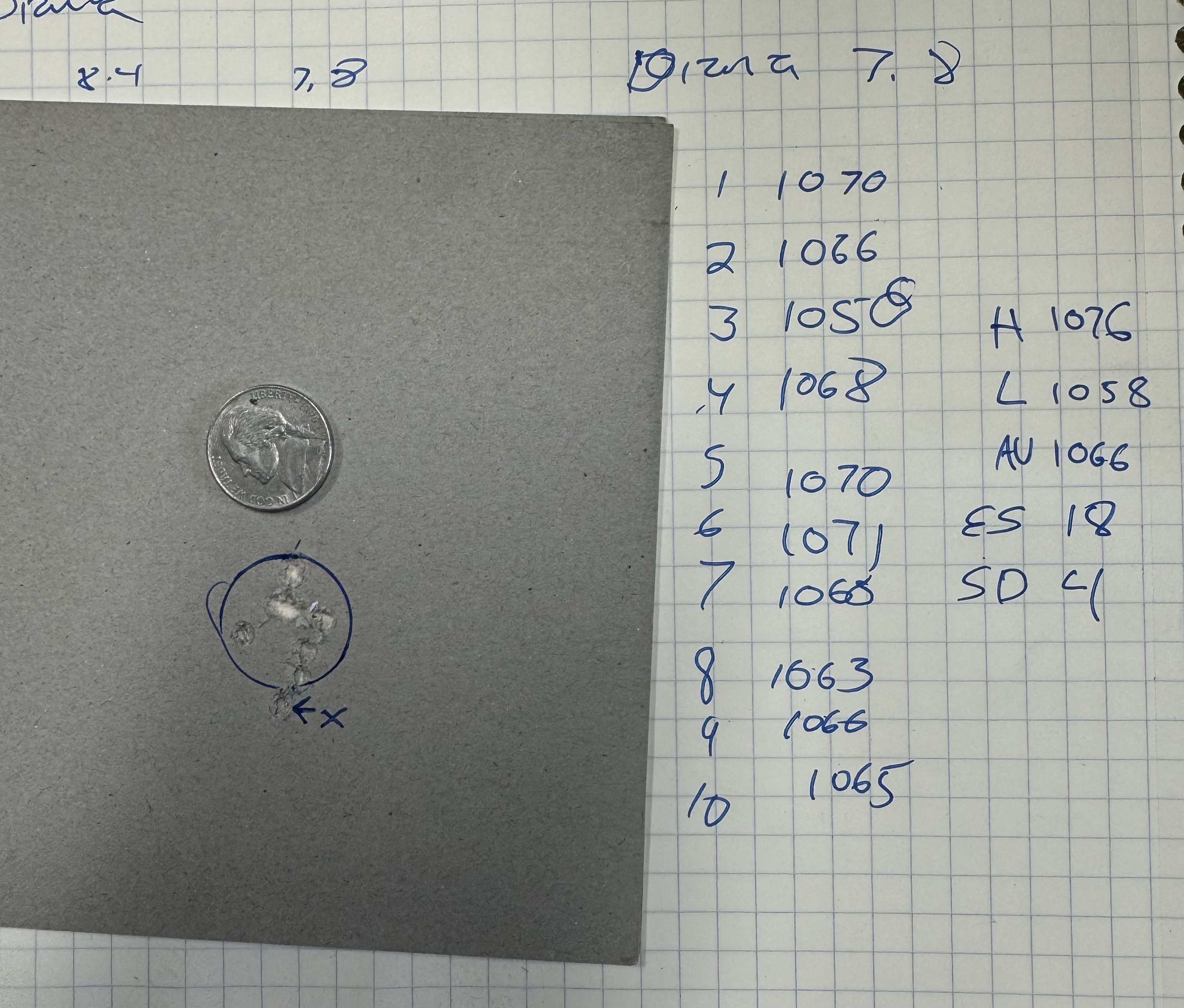

I set up a the chronograph in my garage and only had 14 yards to work with. But I’m just shooting off the bench for the chronograph and doing my best to aim at my 5x5 trap.
Seriously ??? Standard deveation of 4 with a tin of old dusty pellets?
And under a nickel . The one low shot was me aiming at the bull rather than one dot hold over. But it shoots so well. The level works . I did shoot 8.4 pellets and it would toss the pellet low right and be like 975. Then the next shot was 1020 and back on target. But the 7.8 are just spot on.
The trigger has a tiny bit of creep but it’s brand new.
I am not sure if I want to change it. I guess it could always be smoother but this thing is a real tack driver.
I’m looking forward to more testing.

IMHO I'd go with a heavier pellet. Those speeds are way to fast for a pellet to shoot accurately. At 14 yards it should be almost pellet on pellet. I've found with my 48 that a 10 or so grain pellet works much better. Pellet speed is best below 900 fps.

I agree this is way fast.
This is just the beginning of trying to find out what this gun likes. I am really just shooting up old pellets to brake in the new gun. I want the 7.8 around 900 plus range and then try the heavier pellets .

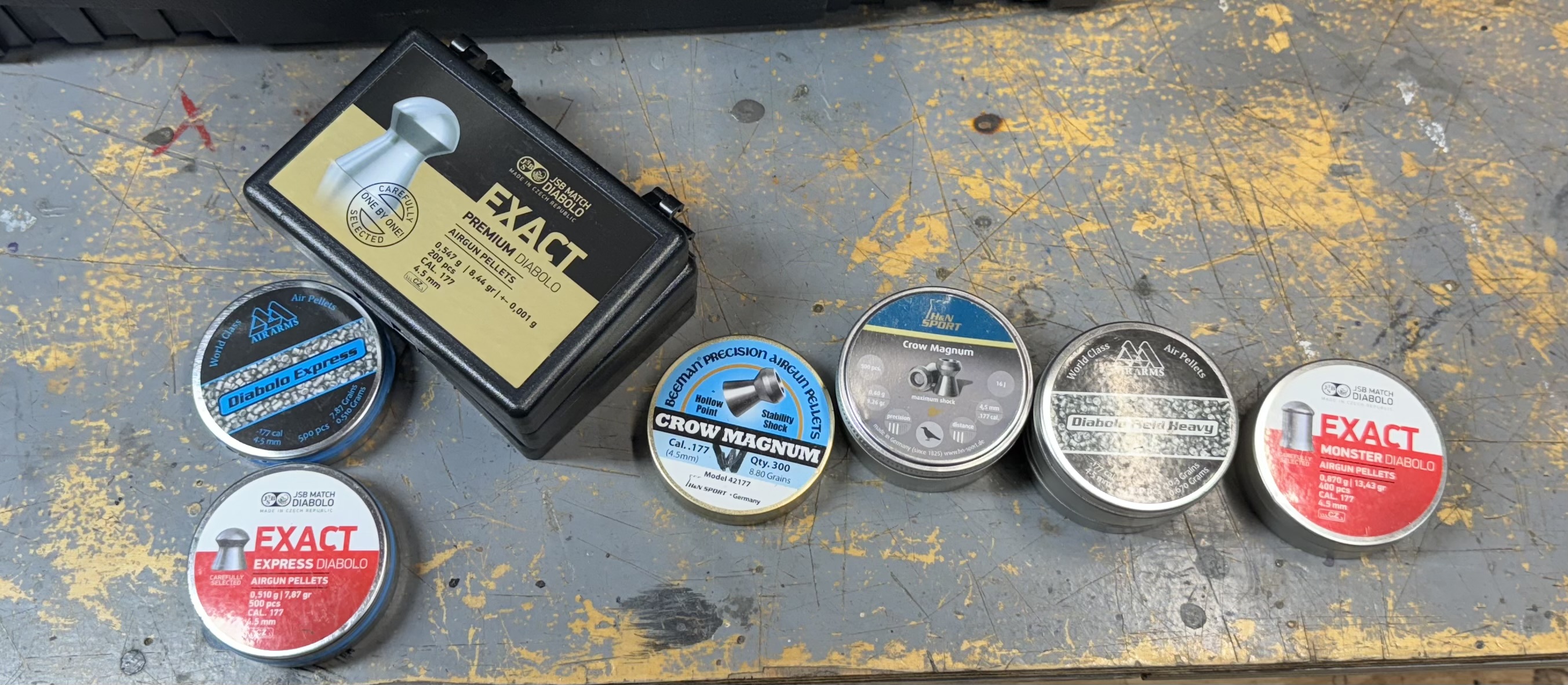

But I got a good selection of flat pellets from 7.87 gr up to 13.4 gr .
Should be fun to see how it goes and brakes in.
