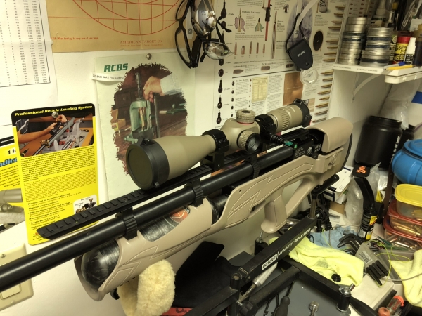

Hercules Bully owners- I may have solved the flex scope rail issue

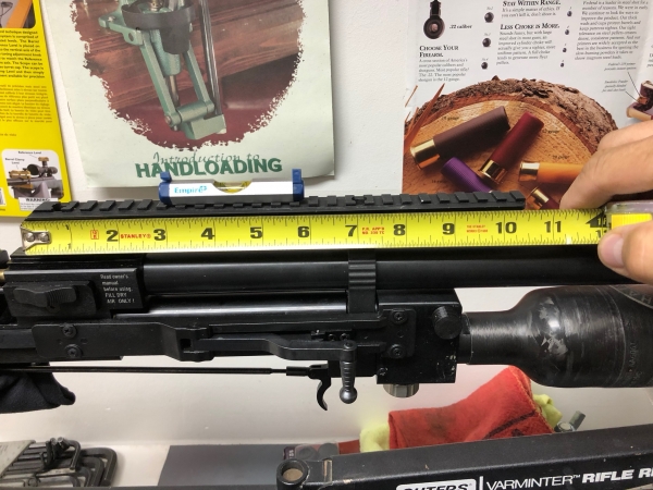

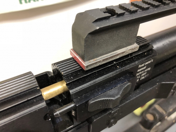

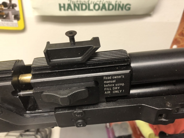

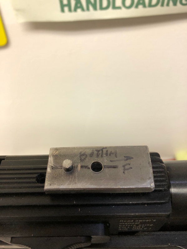

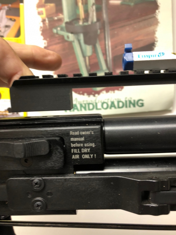

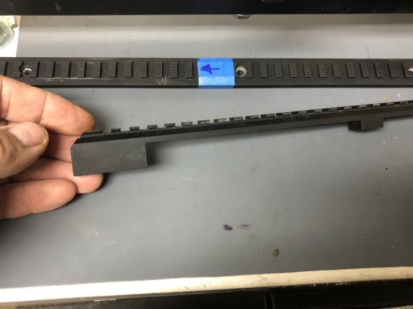

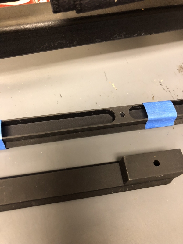

Jaland, I not only got rid of the bottle cover with two barrel shrouds as part of it, I swapped out that 21” long, hollowed out scope rail to one of the Bullmaster which is a solid piece of aluminum and only 10 1/2” in over all length. If your trying to remove all flex from that scope rail, don’t just remove the bottle cover, switch out that scope rail also. The holes at the breech block attachment to the first barrel shroud band are exactly identical. It’s an easy, straight across bolt on. The bullmaster rail was inexpensive at $29. Made all the difference in my accuracy.
That scope rail from the factory on the Bully is hollowed out and can easily bow. Just to prove my point, with out the bottle cover attached, and now you have all this rail just hanging out there, push down on it. You will see the flex downwards.

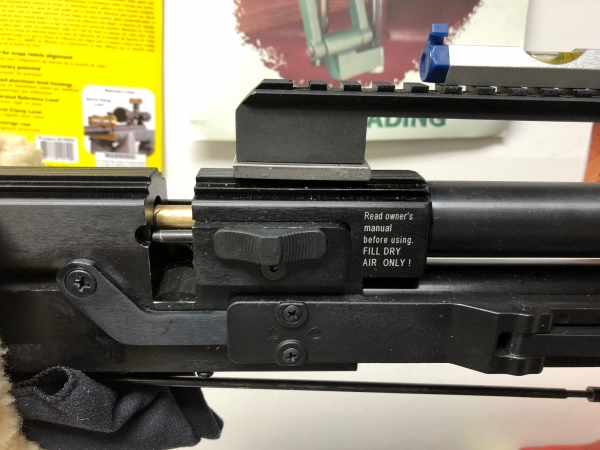

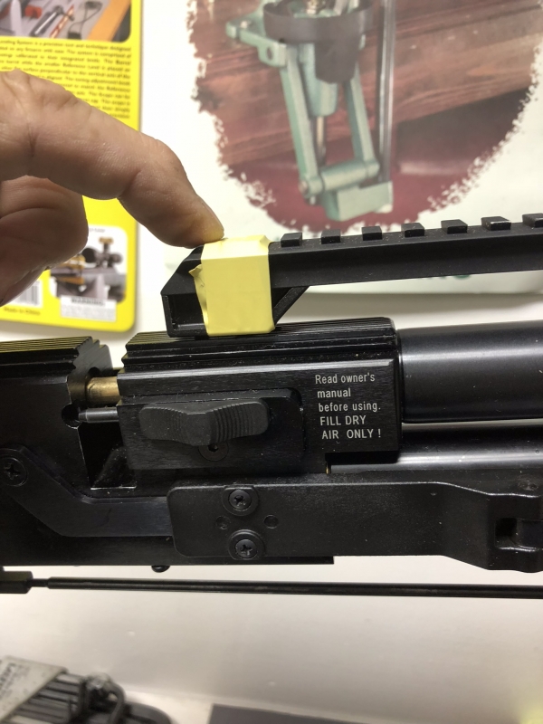

To Barber and Jland- I would seriously consider changing out that scope rail to one off of the Bullmaster, or even the one off of the flashpup, and Jland, while your doing that, investigate that second shroud band. I looked thru the schematics of the Bully last night on Hatsan’s website, and see no fastener holding that down. It looks like an interference fit, or better yet a squeeze fit between the parts above the breech block. The BM scope rail is only $29.
If Hatsan did do a recall on these Bully’s it’ll be accuracy related, not power related, and about the only thing I see them doing is making that factory rail in solid bar stock, and clip it shorter to around 18 1/4”, which would be just past the last shroud on the bottle cover. Just my honest opinion.
If you don’t plan on going the scope rail retrofit, try this- don’t ever use that pic rail under the bottle cover for bipod use. Instead, set the rifle on a rest, and place the rest directly under the main stock, not the bottle cover. I have a feeling your accuracy will improve in just doing that.

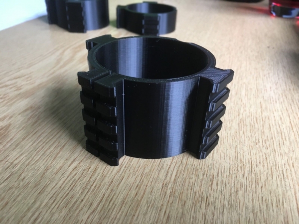

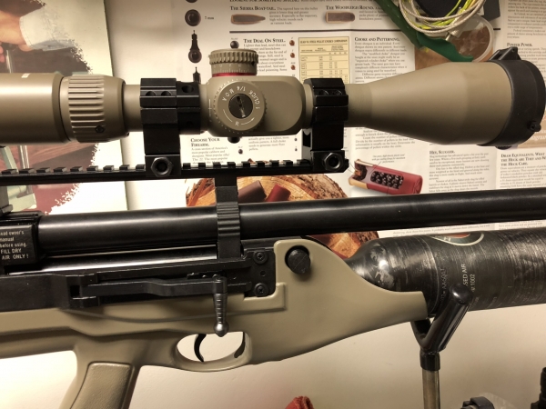

UK bottle clamp,is in! Fits nice and tight. Here are close up pics of the quality of build. The maker also provided a 1/4 round cut out for guns with barrels really close to the bottle
1542152237_21373239405beb602d62b942.99644116_DF12DFF8-19F1-4747-8143-9EB87DC7A36A.jpeg
1542152237_21265740605beb602dc89fc0.35819969_EE3A5D90-E4FB-425A-B80D-9B9D53BC080F.jpeg
1542152238_21340791085beb602e34f4b4.41925835_9A94F779-C356-461B-B1CD-15BBF5FF6DE6.jpeg
The clamp comes split at the bottom pic rail, and to cinch it tight it is dependent on your QD bipod mount or flashlight mount. Here I have my bipod mount attached, and it is snugged up tight. No loosey spin that comes about with some of these plastic clamp on deals that are around. Really a good looking addition to this Bully. The main purpose I got this was for light attachments, cause I mainly shoot from a rest vs a bipod.

Couldnt sleep last night, so at around 1am I went out to the garage and tried this with bipod on to see if the clamp would slip and go cockeyed on me, but no go. This thing feels like it has some kind of suregrip on it cause it won’t budge. I tried to go more inward on the bottle, but the hatsan logo on the bottle adds just a hair of extra thickness to the circumference so it wouldn’t clamp on. I’m very happy with this mod, and it just adds to the look of the gun. Imold, if you do order one, just get the widest he offers, I think it was 45mm wide. Has 5 pic lugs. Make sure and tell him on the message box at checkout it is for a carbon fiber bottle at 61.50mm. His catalog shows for 60mm bottles, and those are for the steel bottles. Composite bottles like on our Bully’s are larger in diameter.
Ok thanks Augie. I’ll think it over for a bit and see how yours holds up, with my luck I’ll order it through PayPal and there won’t be a message box where I can tell him it’s for a carbon fiber bottle and needs to be 61.50 mm. I did put 60 mm and 45mm on his ordering site but like I said I’ll see how yours holds out after a tin or two of shooting.

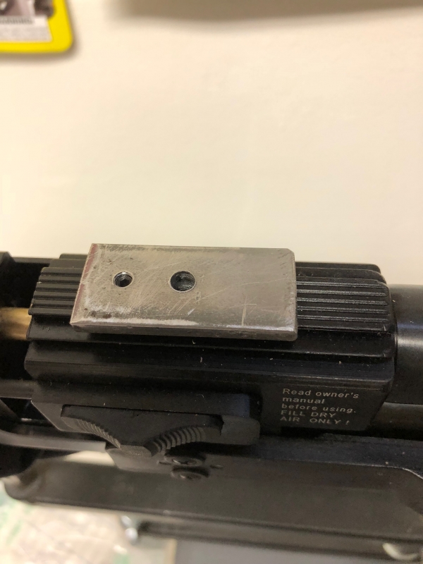

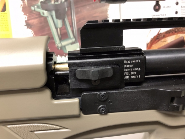

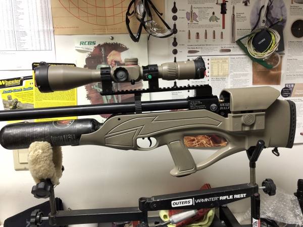

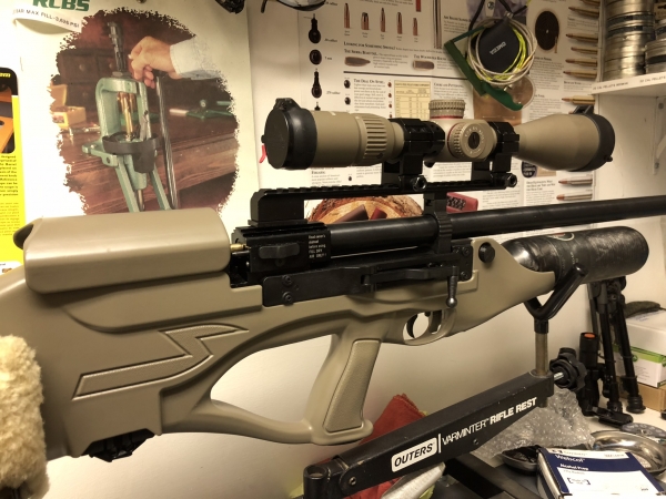

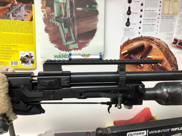

I got the bully at midway for $544 on clearance in .25 caliber. I also swapped out the rail for the bull master. Cost me 15 dollars and 5 shipping from Hatsan USA. Also dialed down about 9 turns on spring, I might have 5 threads left to reduce off I had to. It's averaging 900 FPS with standard JSBs for about 45 ft/lbs. I'm busting ragged home groups at 35 yards or so.
I also ordered a picatinny mount picatinny extension rail from Amazon that's a tad shorter than the bull master rail, but looks like it would be stronger still! It attaches to the actual receiver front with 2 large bolts and nuts type mount. The front screw almost sits too far front, but it will work. It would need about 1/4" ground off the plastic outer part of that first rail mount on the stock to fit, but it's a beast. If bull master rail fails, is next, but.... so far so good!
