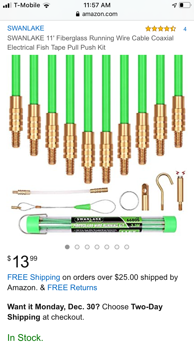

Do you know an electrician?
I have a pice of fiberglass rod used for “fishing” electrical wires. Mine has no metal on the ends. And I’ve used it a lot when I double feed my Benjamin Marauder pistol. If you know an electrician he may give you a pice. Here is a photo of the product I’m referring to.

You can get the fiberglass rods at harbor freight they will not break as easy as a wood dowl that size look in electrical

the fiberglass rod is the best option
