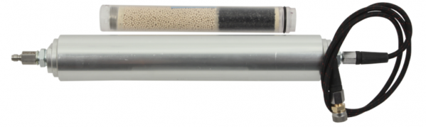

I have a Omega Supercharger, a 75 F Omega Tank, and a Omega Clean Air filter system.
The Omega Filter came with no Instructions. Can anyone enlighten me as to how to hook up the filter in between the Supercharger and the Omega tank.

I want to utilize this equipment safely and I find it hard to believe that no instructions came with the filter. A filter was in a box, is this a spare filter?
Is t
he filter to be placed into the tube in a specific direction?

You are right in that there seems to be a dearth of documentation on these. I used every search trick I could think of and could not find even rudimentary instructions on the Omega. However, the distributor has the Diablo listed as an accessory to the Supercharger, and considering that the build is very similar in configuration, I searched that. I was able to come up with this video on the Diablo: https://youtu.be/bk3uBUOt0L8
Also, just looking at the filter and the compressor, the configuration itself would seem to suggest the direction to hook it up
1548825623_8283235825c513417c4cba1.96200002_Screenshot_2019-01-29 Omega CleanAir Inline Filter...png
Like the Dioblo, this filter has one end with a quick connect, and one end where the hose screws in (the hose having a quick connect on the other end. The hose with the compressor also screws into the compressor and has a quick connect on the other end which, were the filter not present. I would presume that the hose from your tank would connect to the quick connect on the filter, and the hose from filter to the quick connect adapter on your tank. I'm not even sure it could be hooked up any other way. That seems to be born out by the above mentioned video on the Diablo.

I HAVE BEEN TRYING TO COME UP WITH INFO ON HOW TO HOOK UP AND SAFELY UTILIZE THE OMEGA CLEAR AIR FILTER BETWEEN MY OMEGA SUPERCHARGER AND MY OMEGA 75 CF TANK. I WANTED TO SEE BETTER INFORMATION THAN PROVIDED IN THE UTUBE VIDEOS AS TO THE DIABLO HOOKUP. AIRGUNS OF ARIZONA ISN'T MUCH HELP. I FIND IT HARD TO BELIEVE THAT YOU HAVE TO PUT OUT $275.00 FOR THE FILTER SYSTEM AND NO INSTRUCTIONS ARE INCLUDED. I WOULD PREFER TO BE SAFE THAN SORRY WHEN DEALING WITH THIS HIGH PRESSURE STUFF. I WILL UTILIZE THE PHOTO BUT I WANTED CLARRIFICATION ON
