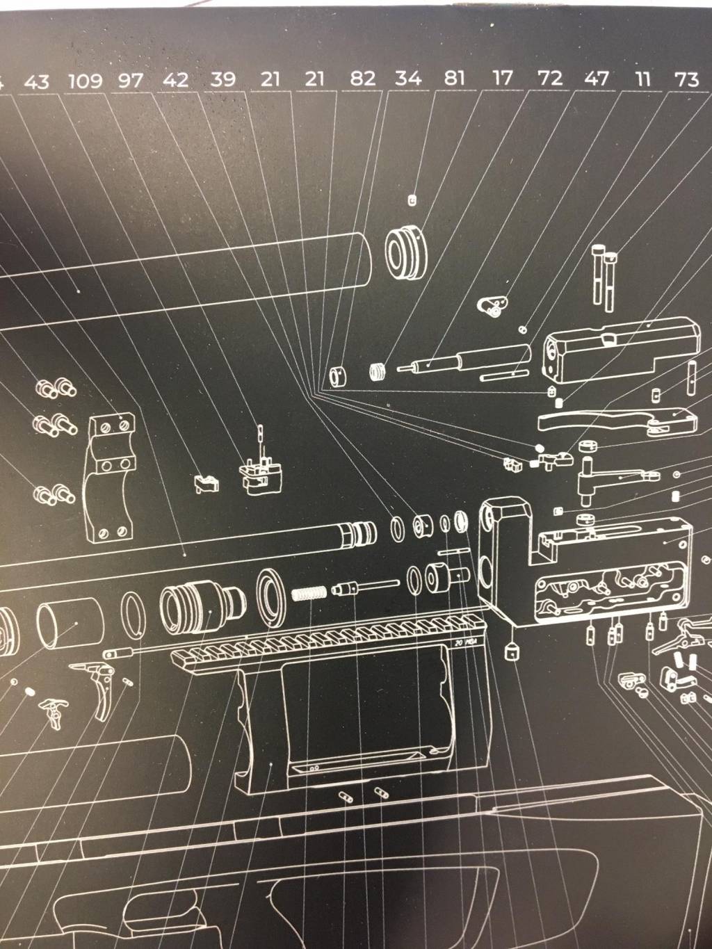

I tend to agree. I had planned on a installing a huma reg and plenum, and while a new reg and and some adjustments may well get things right, its frustrating that it wasn't in working order out of the box. Dealer does not seem super interested in helping, just told me to shoot a tin and things should be good. Also told me there was no o ring on the barrel after I sent the schematic. When I pointed out that there should in fact be one there and asked if they could send me one, he said they don't have any parts for taipans right now. I've found the o rings online and will get some, but feel like I'm being brushed off. Not trying to turn this into a dealer rant, just want to get this little gun shooting right.
