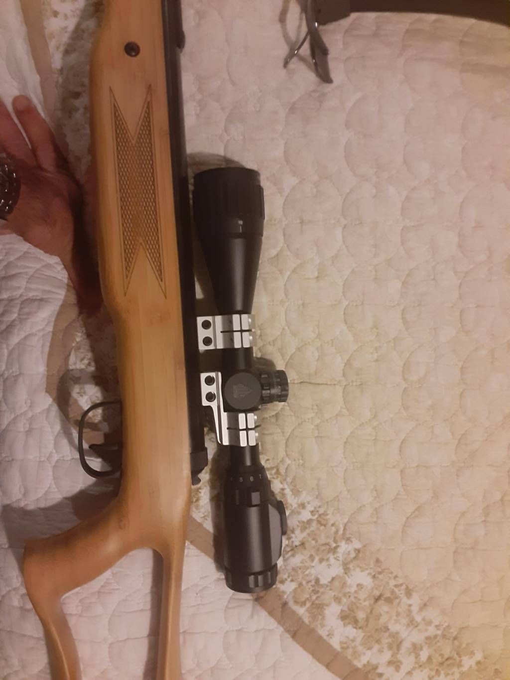

I have budget friendly and not so budget friendly, for what you asking don’t overlook the utg bug buster or other utg scopes they are really nice for the price. Just my thoughts.
I'm with Vinny. Do yourself a favor and take a look at the UTG scopes . You will like the price and will not be disappointed.
This. I got my first UTG scope a short time ago. It is definately a good scope at a good price. It's mounted on my newest cheapo springer, and I wish I knew of the brand years ago. I have quite a few vortex (for springers and firearms), and a sig sauer scope. The UTG one I have is a solid scope for a price that wont kill you...

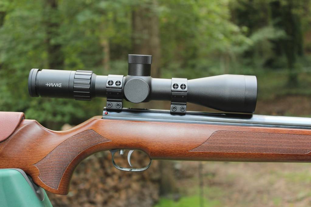

You were looking for something in 200 dollar range as far as I can tell. Hawke is probably a good option. Specifically the Vantage in the IR line:

The UTG (not Bugbuster!) Mini Swat 3-12x44 and 4-16x44 (with 36 colors!) are ok scopes if and when purchased at $100-$125 when shopping smart even the 4-16x40AO too...

Hawke Vantage are nicely made scopes for sure. Made in China like most.
But they do not come cheap. And they are OK for PCPs but do not even THINK of putting them onto a springer. The reticle on my spanking new Vantage broke (yes, it simply snapped!) on my Gamo Magnum IGT during my very first shooting session. The UTGs (made in China) are more shock resistant, but I do not care for the fairly thick reticle. (I do like that BSA from Aliexpress ... The feral parrots don't, but hey you can't always please everyone ...)
You may want to look at this new compact Hawke scope. https://us.hawkeoptics.com/airmax-30-sf-compact-4-16x44-amx-ir.html I have this scope on my HW95L and my wife & I enjoy shooting this from our back deck. She really likes the IR feature that has 6 brightness settings and I like the side focus. I have found the scope solid after several hundred shots.
