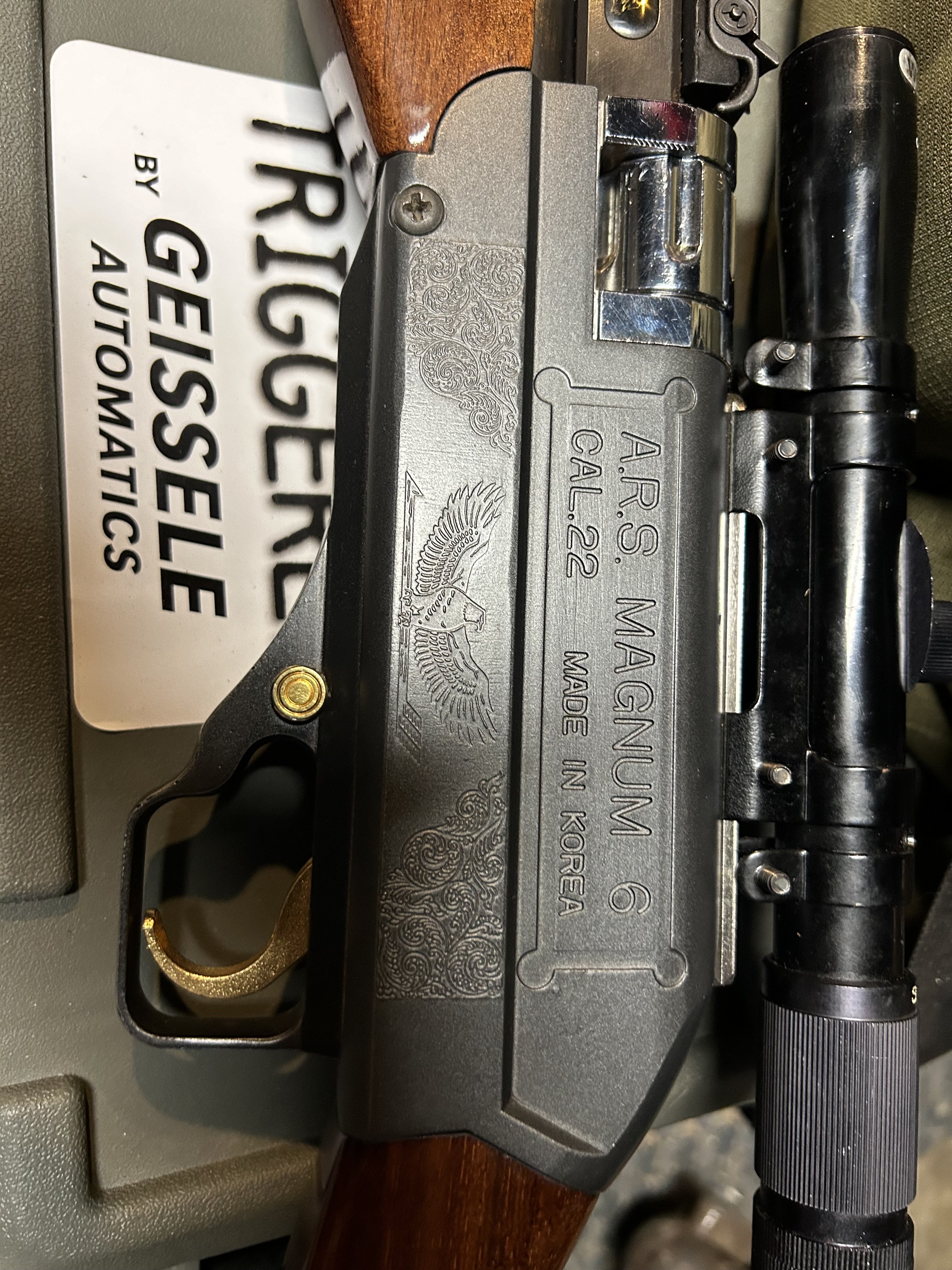

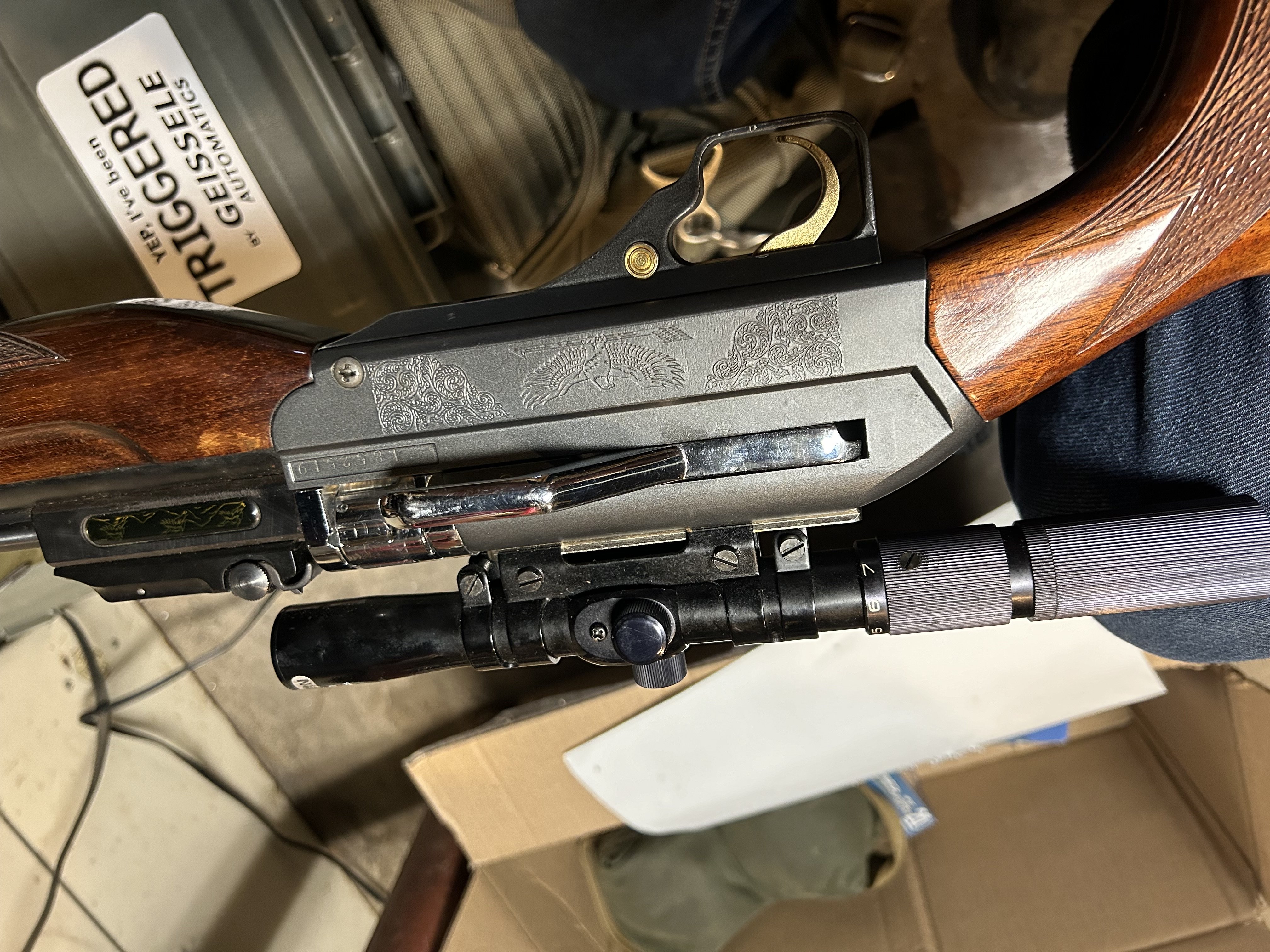

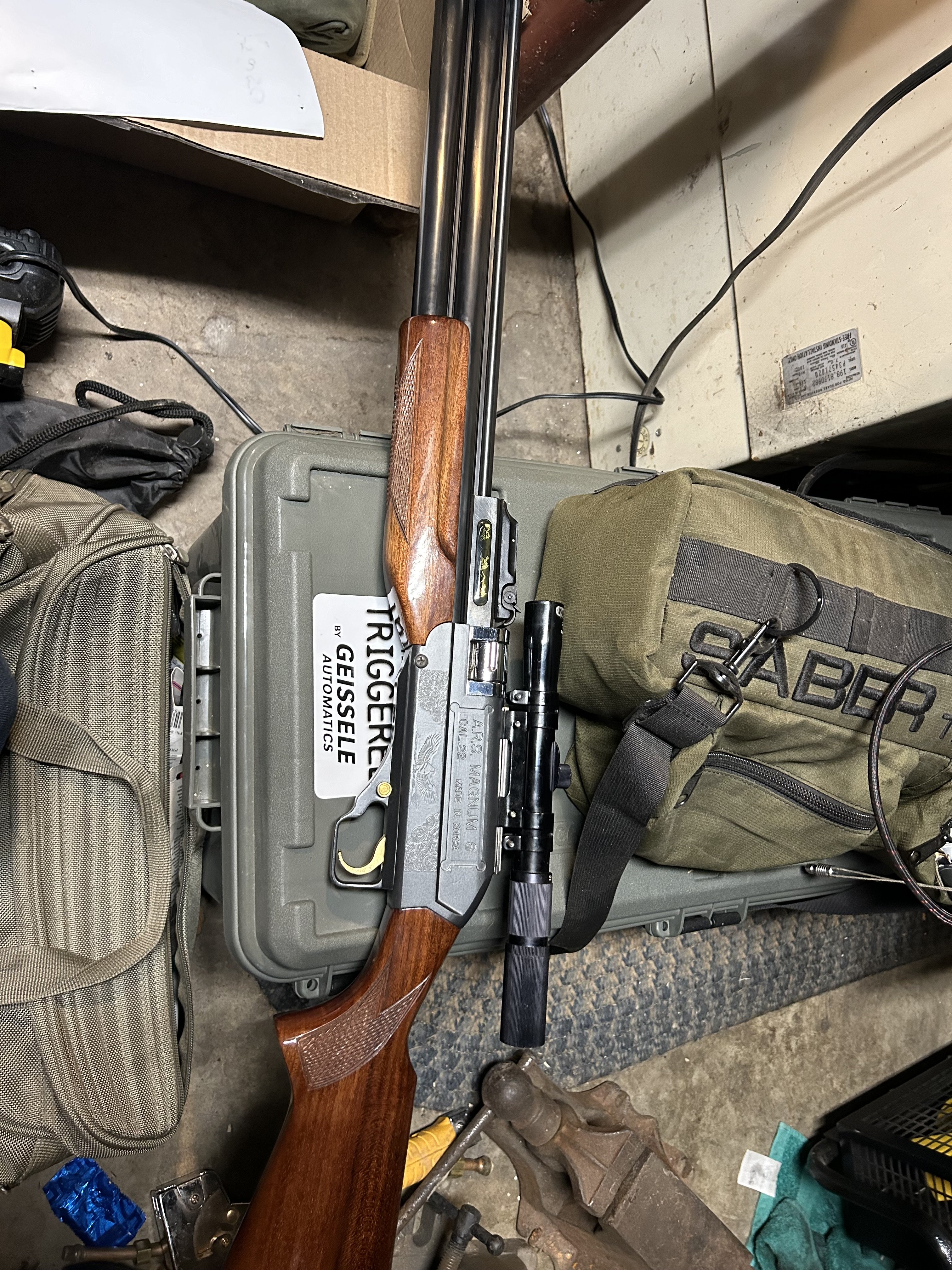

Hey all. A friend of mine who is an firearms ( not to mention airguns) dealer specializing mostly in antiques and hard to find parts gave me this Korean PCP to see if I could figure out if it works and holds air. I can’t seem to find any information on this particular model. Any help would be greatly appreciated. I believe I need to get a fill probe or if there’s a foster conversion kit that would help too. Thanks again

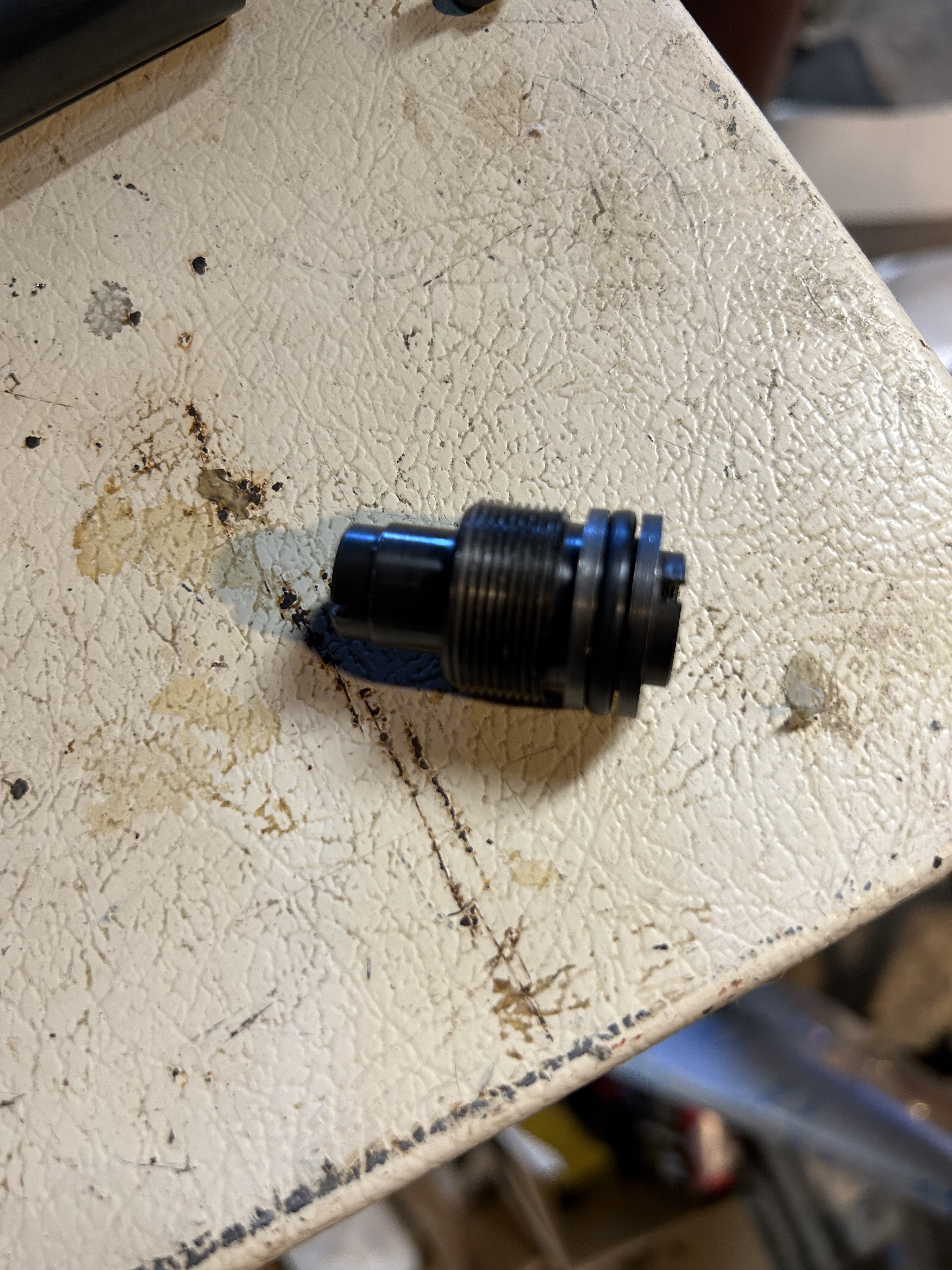

Thanks for the info. I need to find out how to get that fill probe and just hook it to my tank. I have an email out to Mol too.

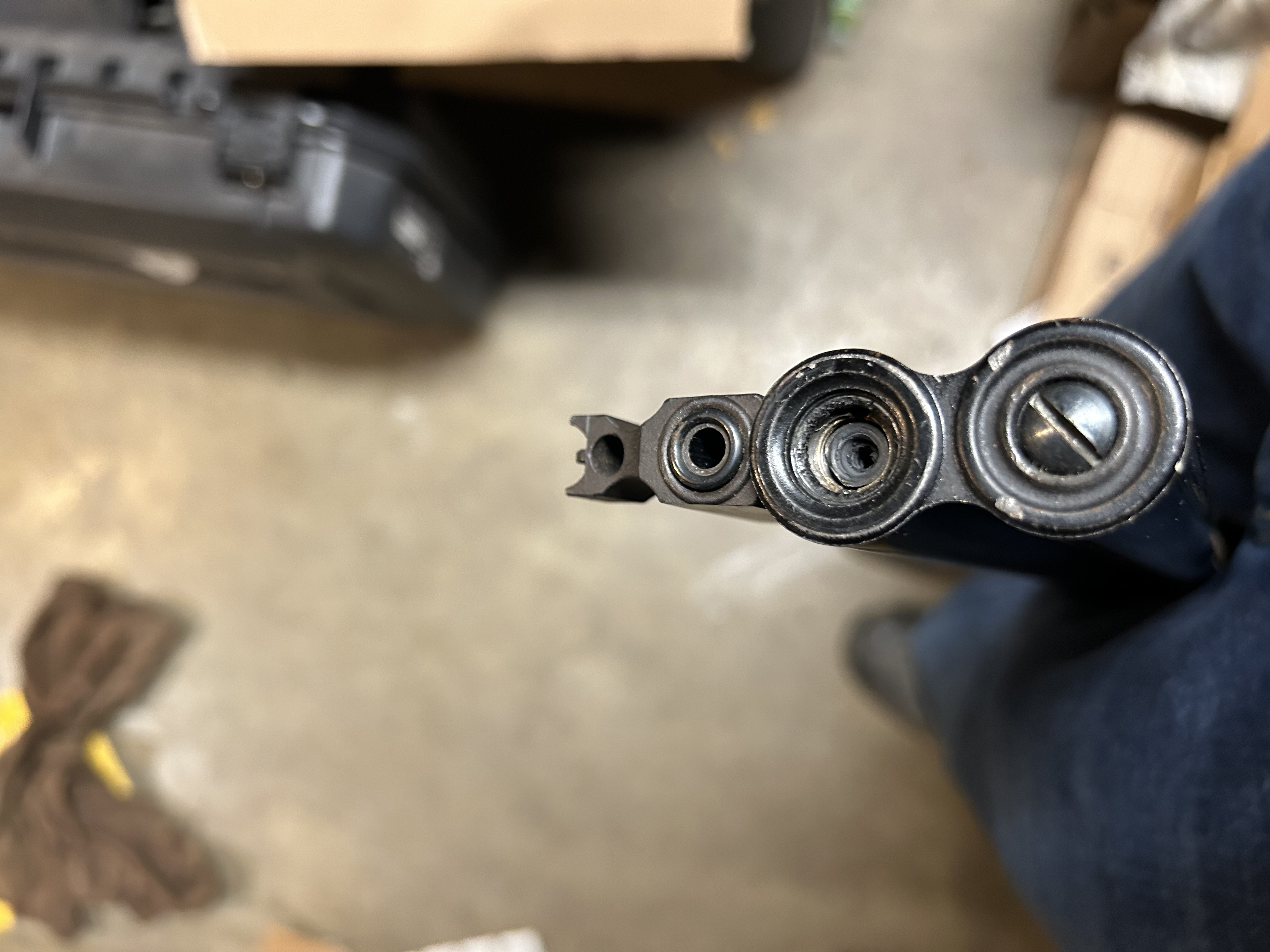

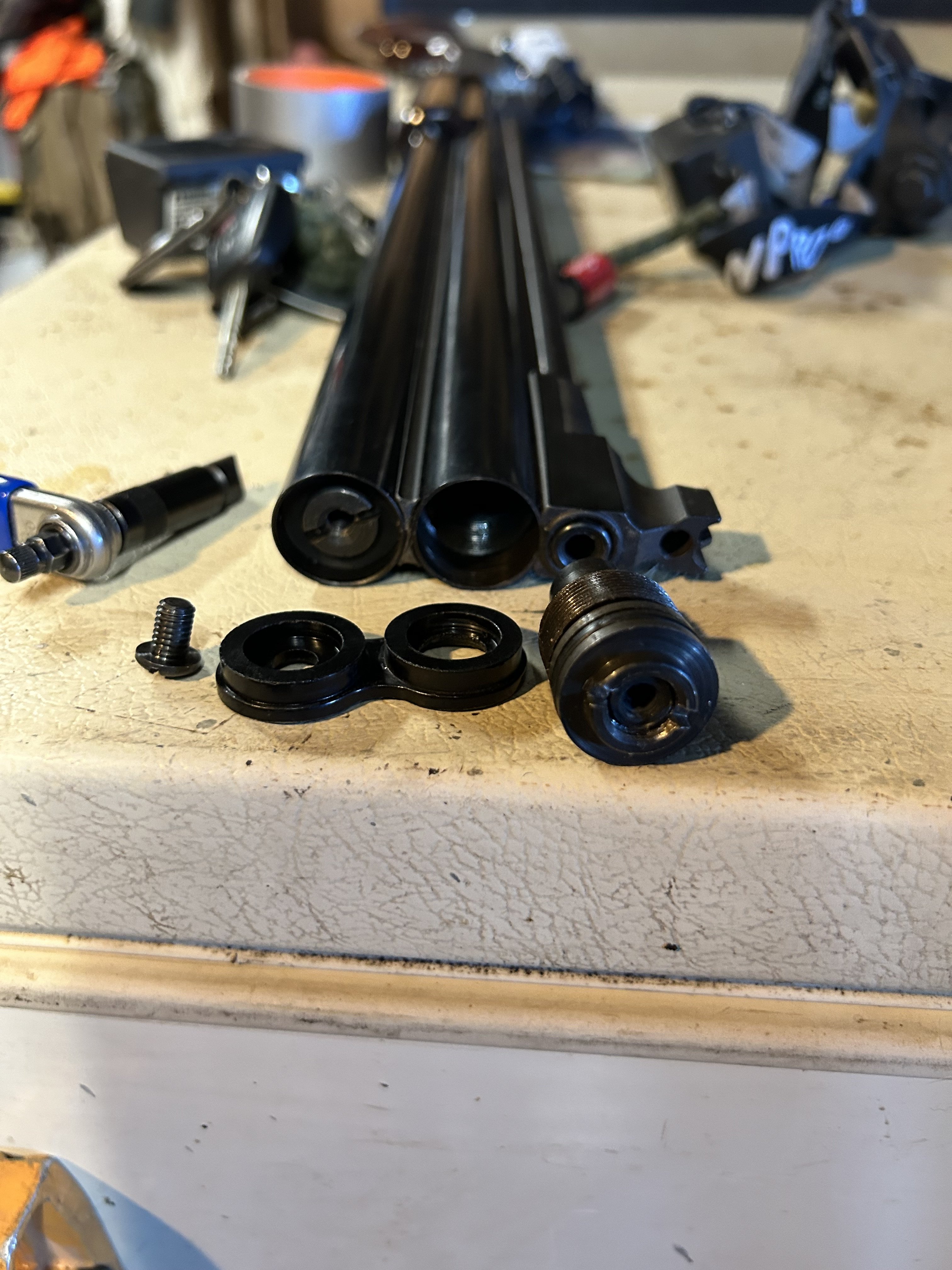

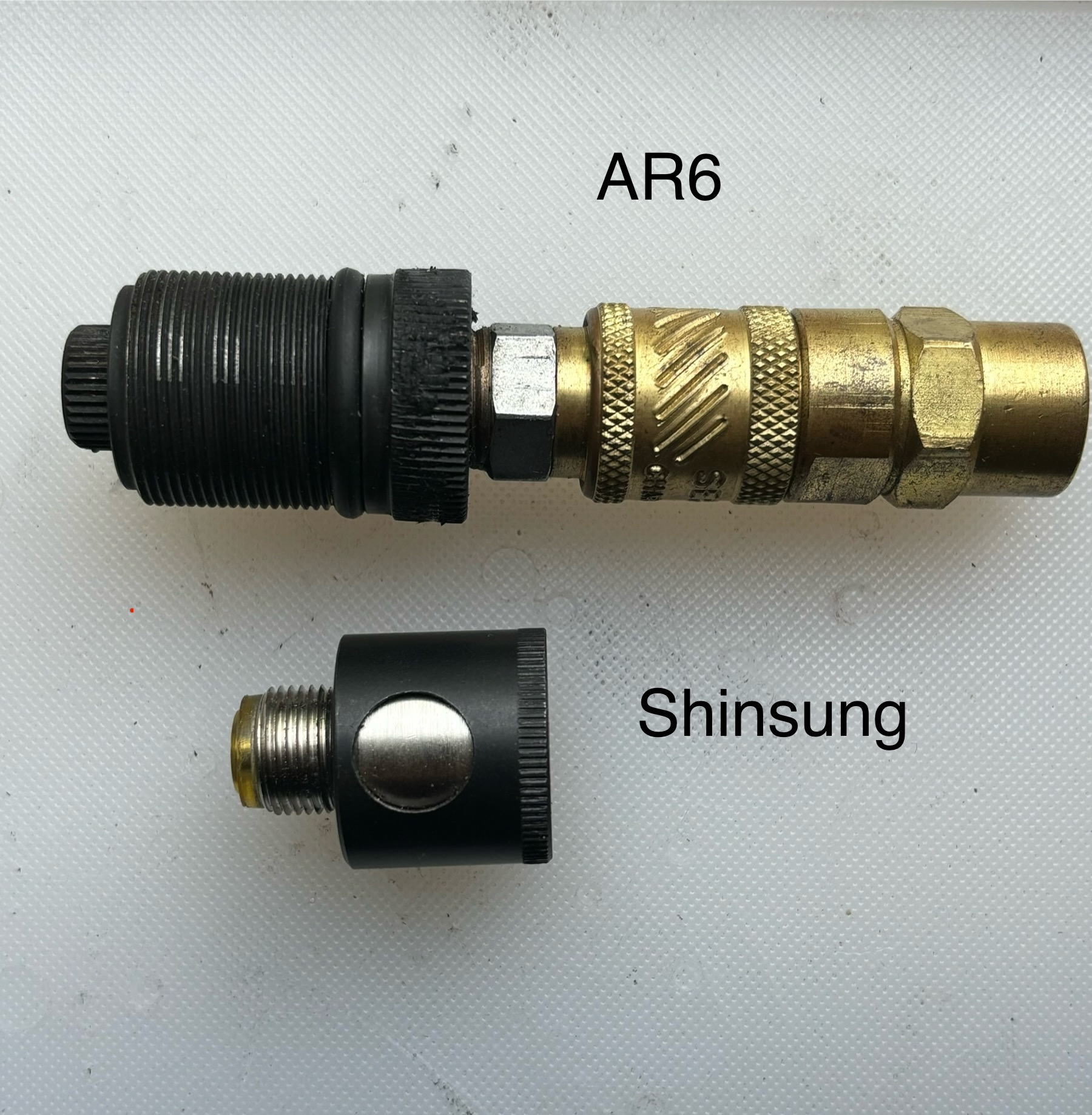

I can’t tell from the pic; are there threads in there to accept the shinsung/sumatra QD fill valve? If there are I have an old shinsung fill valve with the same threads as the valve that privateer linked. I’ll give it to you for free(just pay shipping) so you can test the threads. I also have a fill valve for an old ar6 that would replace the current fill valve, if they both have the same threads. You would just have to add a fitting for a QD.
I can’t tell from the pic; are there threads in there to accept the shinsung/sumatra QD fill valve? If there are I have an old shinsung fill valve with the same threads as the valve that privateer linked. I’ll give it to you for free(just pay shipping) so you can test the threads. I also have a fill valve for an old ar6 that would replace the current fill valve, if they both have the same threads. You would just have to add a fitting for a QD. View attachment 448464
There’s a few threads I can see along with an o-ring in the end of the tube under the muzzle.

Fokke Mol here. Never mind the name, i recieved an email from the guy with the gun. I know something about Korean airguns and i have a reasonable large network.
This ARS is in fact a Duk Il King Hunting Master. We know Duk Il as Evanix. Spare parts are very hard to get. I`m a Dutchman and getting spare parts over here is impossible. I will contact my network to see what i can come up with. Anyway, where there is a lathe there is a solution.
I need to know the size of the thread. Maybe i can cook something up.
