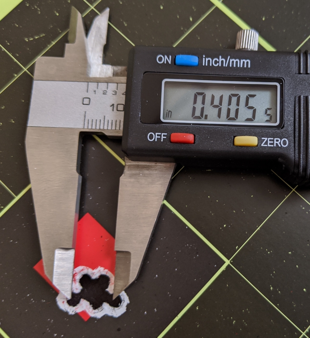

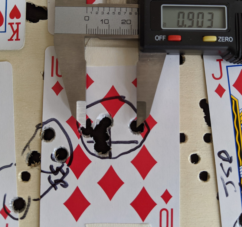

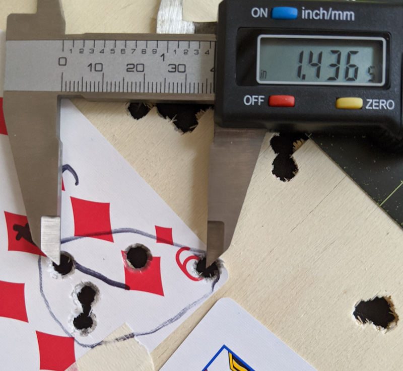

Here is a typical group.
Here is best group.
Lest you think it's me here is AEA Varmint group shot on same day with same rest setup. $450 gun vs. $2000 gun.

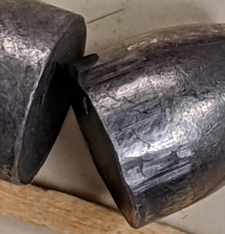

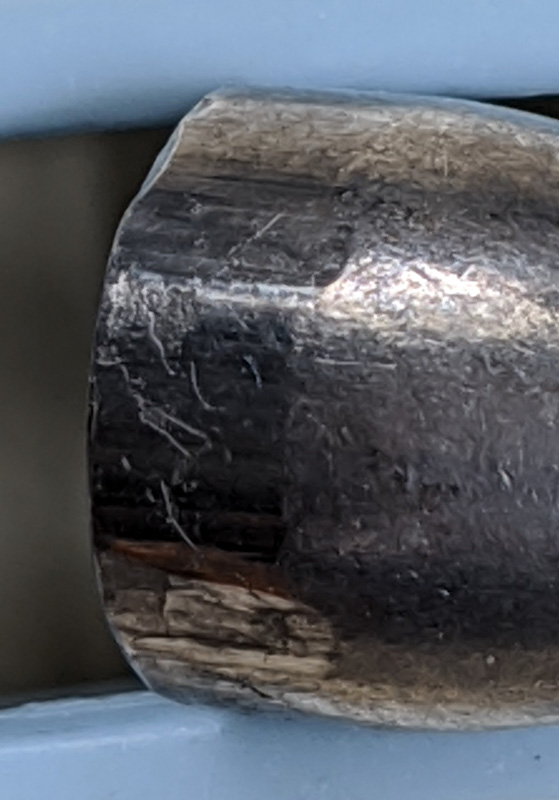

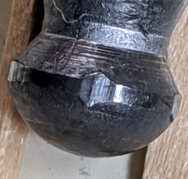

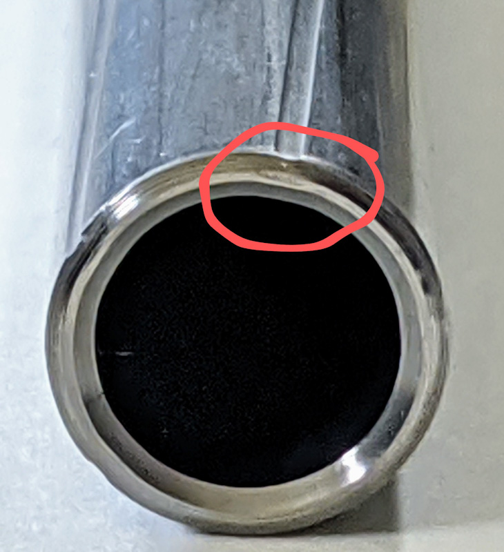

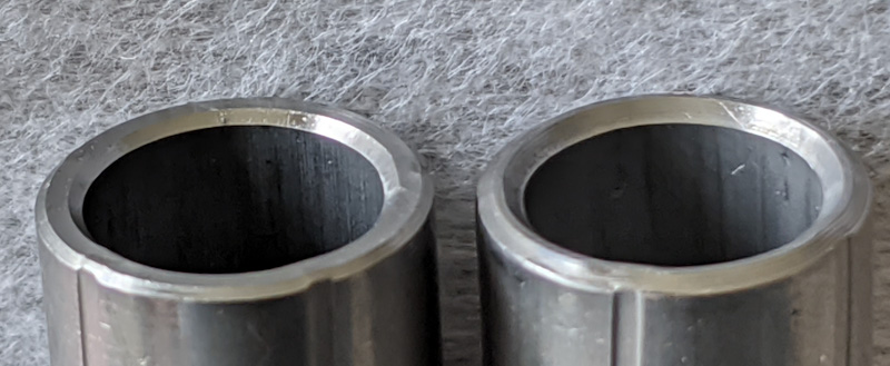

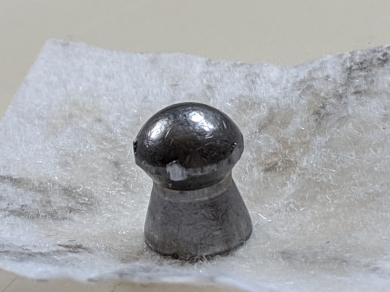

Pushed pellet and slug through. They slide through with a moderate amount of force until they hit the last 1/2 inch where there must be a serious choke because it takes a much harder push to get them through that last bit.

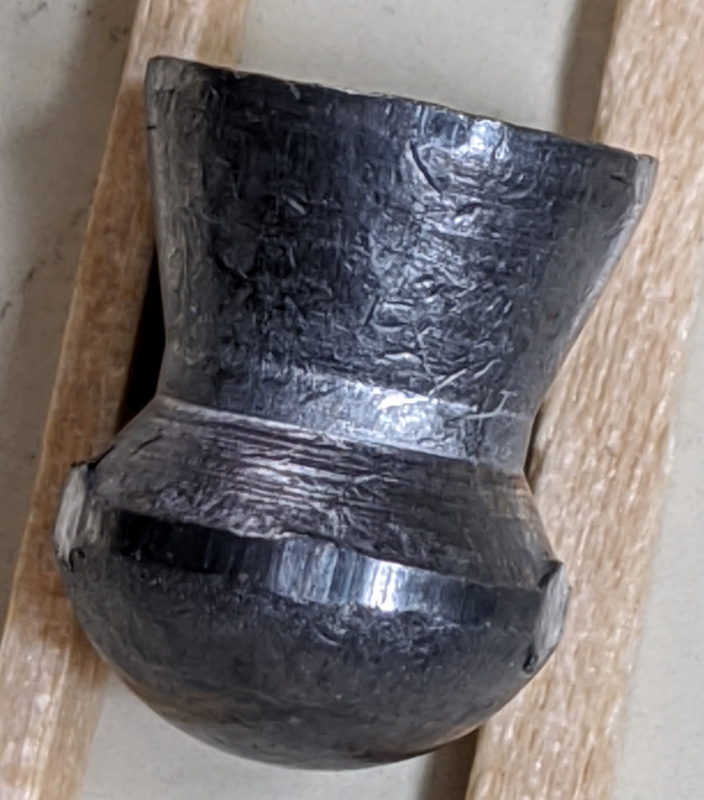

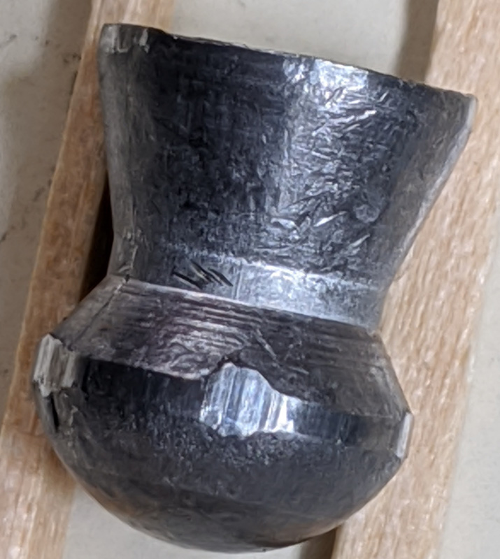

Here is what they look like.
One other piece of evidence. There was a surprising amount of lead build up for having only run 60-70 pellets and slugs through it.

Try a different slug. The one you are showing has a very short bearing length, which can cause accuracy problems.
I thought that too when I first saw how short the bearing area was on NSA light slugs but that was dispelled when I used them and had no issues (in other guns.) I did shoot a heavier weight slug with it too and those weren't any more accurate.

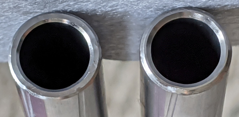

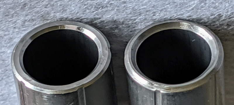

The crown is damaged and this part of the barrel is critical for precision...Nevertheless, re-crowning that liner is an easy task if you have access to a lathe, I re-crown ALL of my barrels as I don't trust mass produced crowning...Make sure you cut it sharp and perfectly perpendicular to the bore: Align the bore of the barrel on your lathe using indicators and good .0001 gauges and center it perfectly.
I noticed that the indentations of the liner (rifling) on the pellet are pretty deep, keep in mind that the deeper the indentations the more turbulence when the pellet is in flight and the less precision, indentations should be minimal, meaning that just enough to spin the projectile (Minimally Invasive Barrel/liner). Check that there is no damage above the crown, this may very well be constricting (choking) the pellet excessively.
If no damage, then re-crown and polish the inside of the barrel with Flitz or similar and push several pellets and inspect them for deformations/excessive indentations...If the indentation and no precision problem persists, get another liner as there is nothing you can do to open the bore and diminish the groove/lands measurements unless you have the right equipment to do it and to measure it...
If as said, deep indentations persist and you see no precision improvements, don't waste your time lapping (opening the bore) with abrasives as this will cause more damage than good to the barrel. The last resource is to get smaller head size pellets and to re-size the skirts jut .01 mm (.0004") larger than the bore, but this will be tedious and time consuming and in my opinion not worth it given the low cost of a new liner...NEVER re-size the heads of your pellets, you will change the aerodynamic design of that particular pellet and will never achieve the most precision.

Imo best to see if they will replace the barrel that's a lot of work for a 2k plus gun. I see very minimal scoring when I pushed an 18 gr jsb and the 17.5 gr nsa through. Additionally when I had my priest 2 in 25 I didn't notice alot of scoring there either. I am an avid powder burner hunter and check my bullet grains and rifling to ensure optimal accuracy. The damage you show will absolutely cause the pellet/slugs to flip or exit the barrel at an odd angle causing accuracy issues.

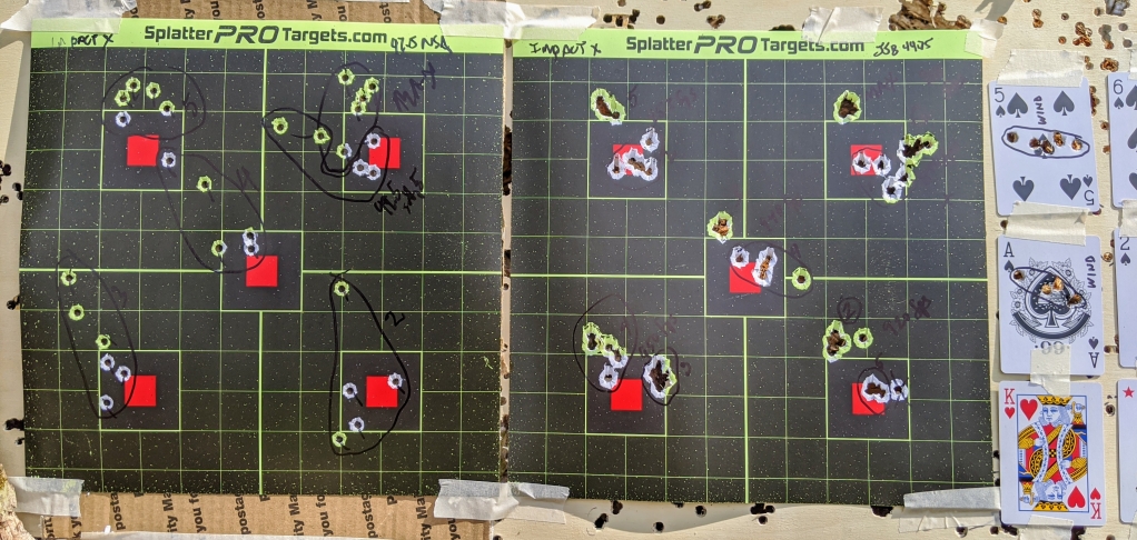

Got a chance to shoot the .30 slug liner again today. I think I might have been contributing to the accuracy issues with my hold which is more important on a higher recoiled like the .30. Maybe that and I had everything tightened down a little better the second time and backed the velocity of the pellets down a notch (to 955 fps). I got quite acceptable groups with the 44.75 JSB’s, but terrible groups with the .300 NSA slugs in 3 different weights. I even went to hand loading them to take the magazine out of the equation. I’d get one or two that weren’t horrific than a crazy flier or two.. Now I’m suspecting it is over-choked.
Here's the targets from the 43 yard range. Pellets on right. Slugs on left. Wind picked up in gusts as I shot the second round of pellets and especially when shooting the two cards to the right hand side with pellets. This wind drift is exactly why I want to get the slugs working.
