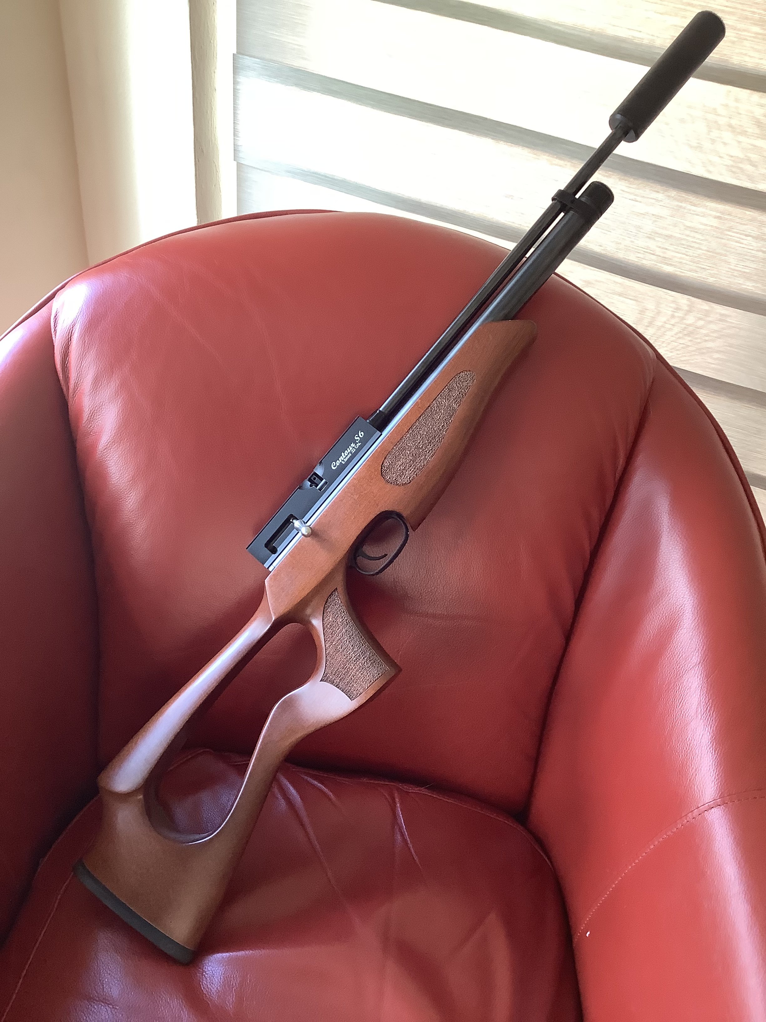

Hi, I am new to pcp and this Brocock Contour S6 is my first and only pcp I’ve ever owned. I bought it for myself along with a Hill hand pump when I retired eight years ago. It worked perfect and was very accurate for over a year then it stopped holding air.

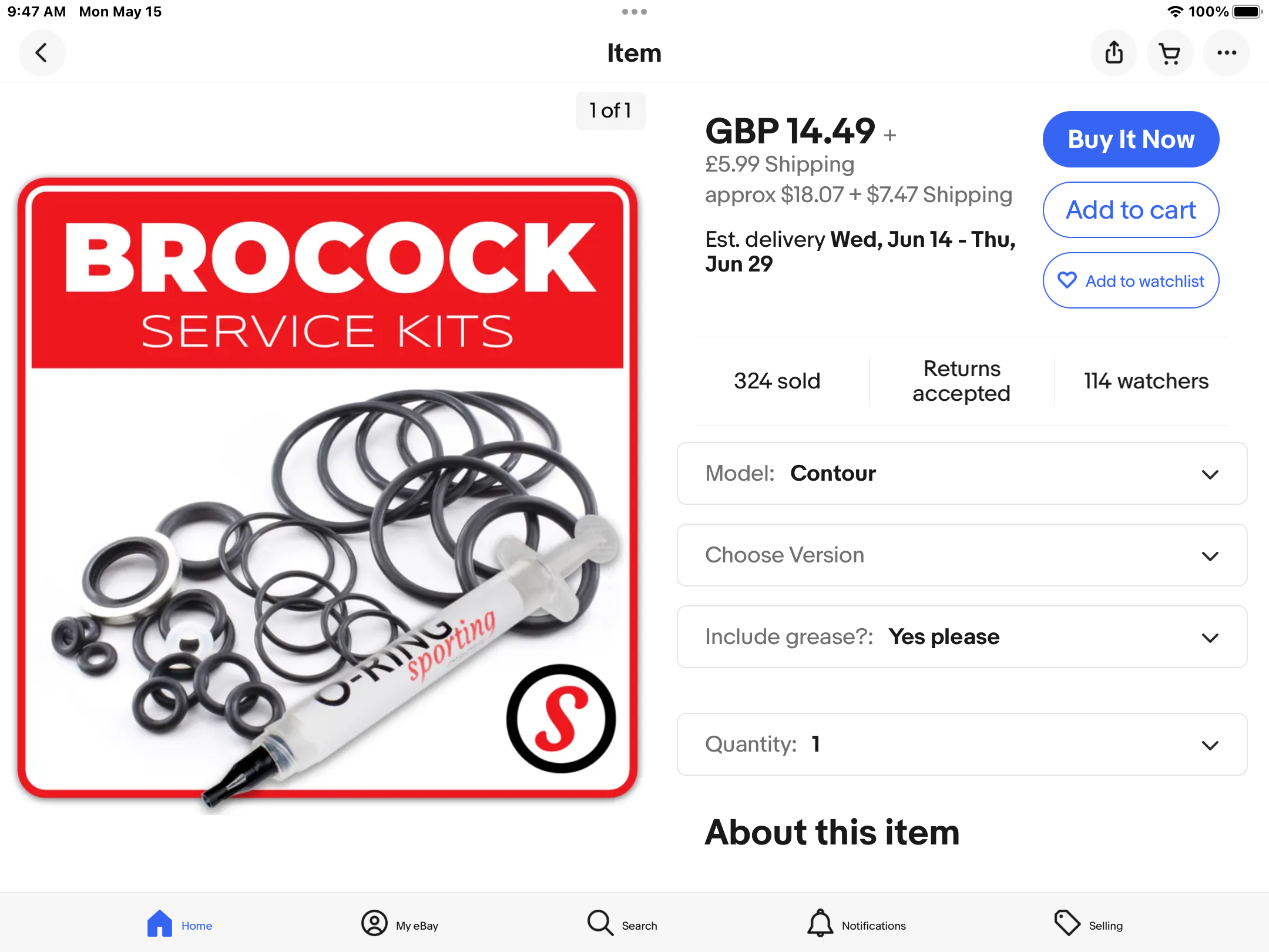

Can anyone tell me if I ordered this Brocock seal kit from the UK would that first step on the right directio.

And YES, the correct rebuild kit would be a step in the right direction!

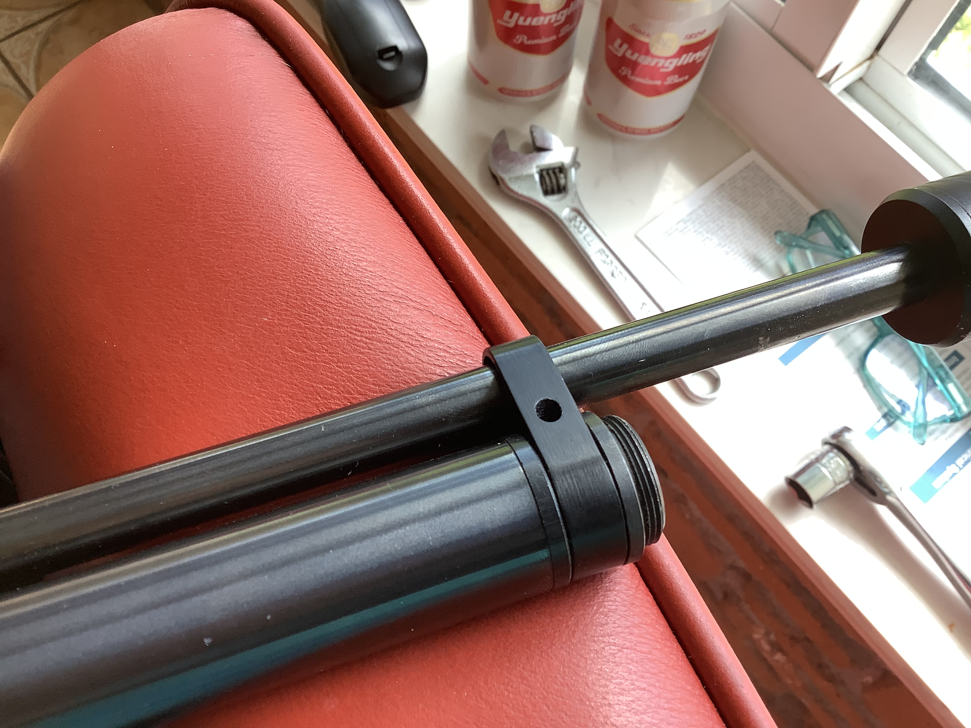

I found a YouTube video on how to change out the seals but he doesn’t show how to remove the part where the barrel band is.
I removed two set screws from barrel band and I don‘t know how to go about unscrewing the part forward of the band.
Any suggestions will be appreciate.
Added: I watched the video to the end and had removed the barrel to get to the part thats on both sides of the barrel band.
there are some seals he replaced in there but I may get away and just replacing the ones on fill probe.
Anyways I ordered the seal kit from UK and should be here in couple of weeks.

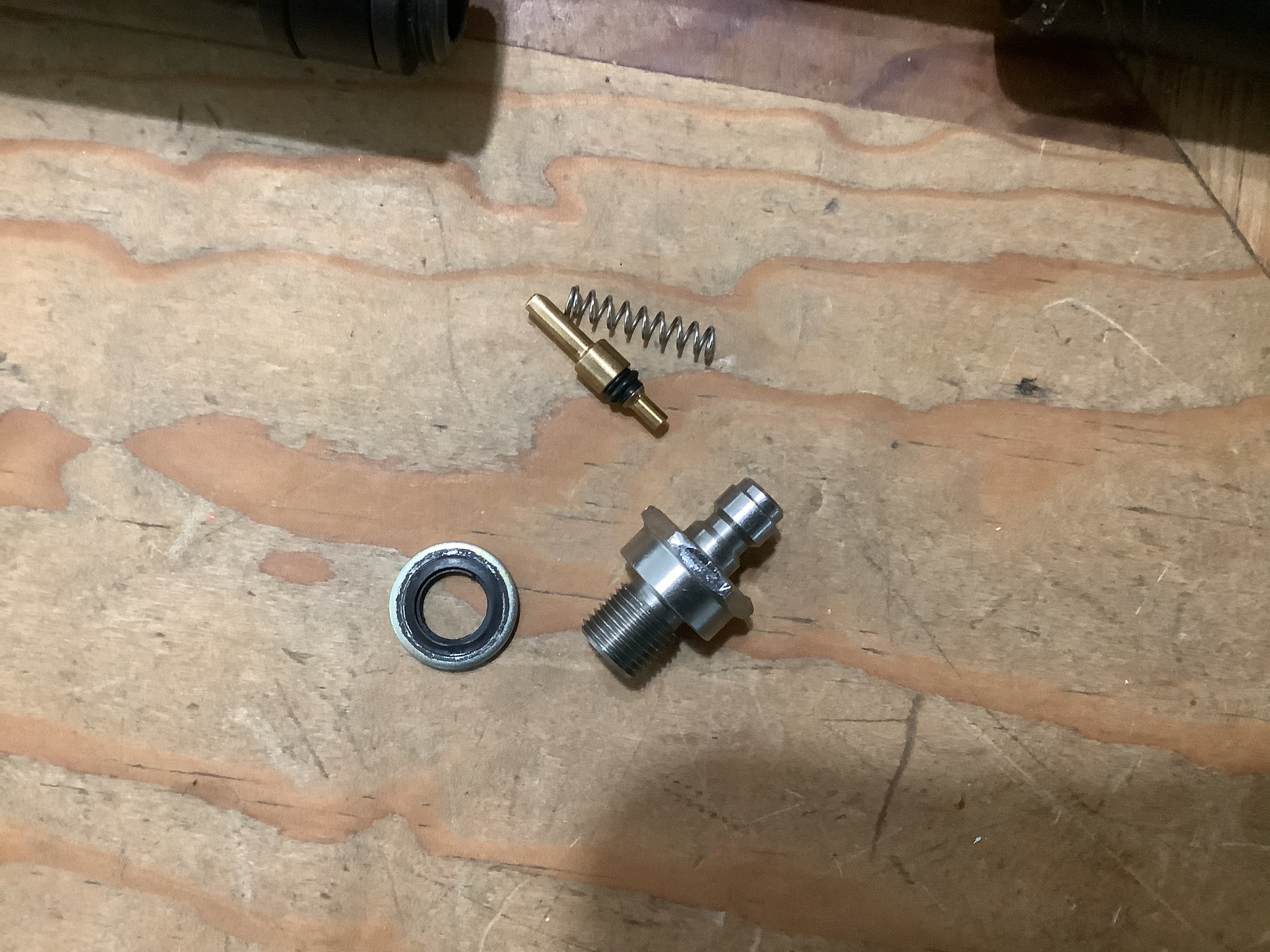

@Bubbacop nice work! Maybe use some qtips to wipe out the fill port body and around the area where the old dowty seal goes. If you do so, be sure not to leave any cotton strands in there. If you have a small air compressor or air brush compressor maybe blow out the fill port body with compressed air to be certain there are no small pieces of debris in there that can interfere with that valve once you reassemble it.

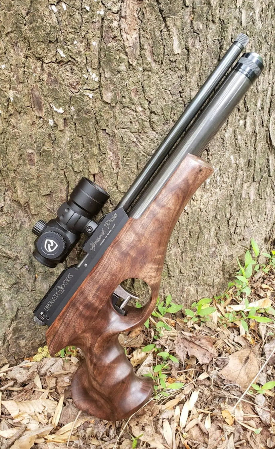

Also fwiw, mine is a pistol, so it has 3d printed trigger blade and guard since those parts are now unobtanium. Stock is not original to factory spec for my gun on either photo.
