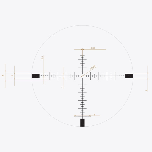

Hi! I have this r3 reticle but I really don’t understand the spacing. Can anyone decipher the diagram and tell me what the spacing is on the vertical line down? Thanks!!

It looks like it's a SFP scope so the moa value in the reticle is only correct on one magnification. From the dot to the tip of the next line out from center in any direction is 1 moa. To the next hash it's 2 moa, and so forth.
