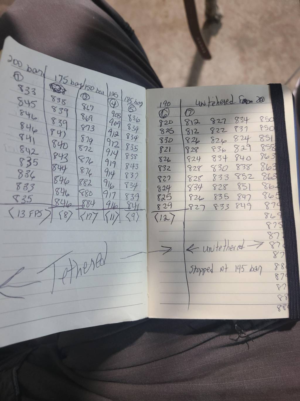

Done some shooting today tethered at different PSI and then untethered as if I was shooting a match
But stopped at 50 shots
