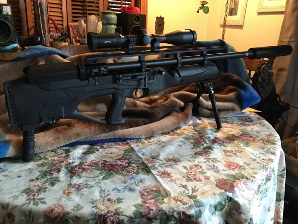

If you have done nothing to your BT and it is new and your the 1sr owner maybe they will let you trade it in on their Bully in 30 cal and pay the difference, you can use the customer satisfaction card, I just ordered 8 more tins of JSB 44.75s because I like shooting mine so much now that I’ve put the DonnyFL Emperor on it. Here is my Bully in .30 caliber.
1538059738_17336220055bacedda2fe238.88064096_5187B82E-A72C-496C-9C51-5F4030603E78.jpeg
