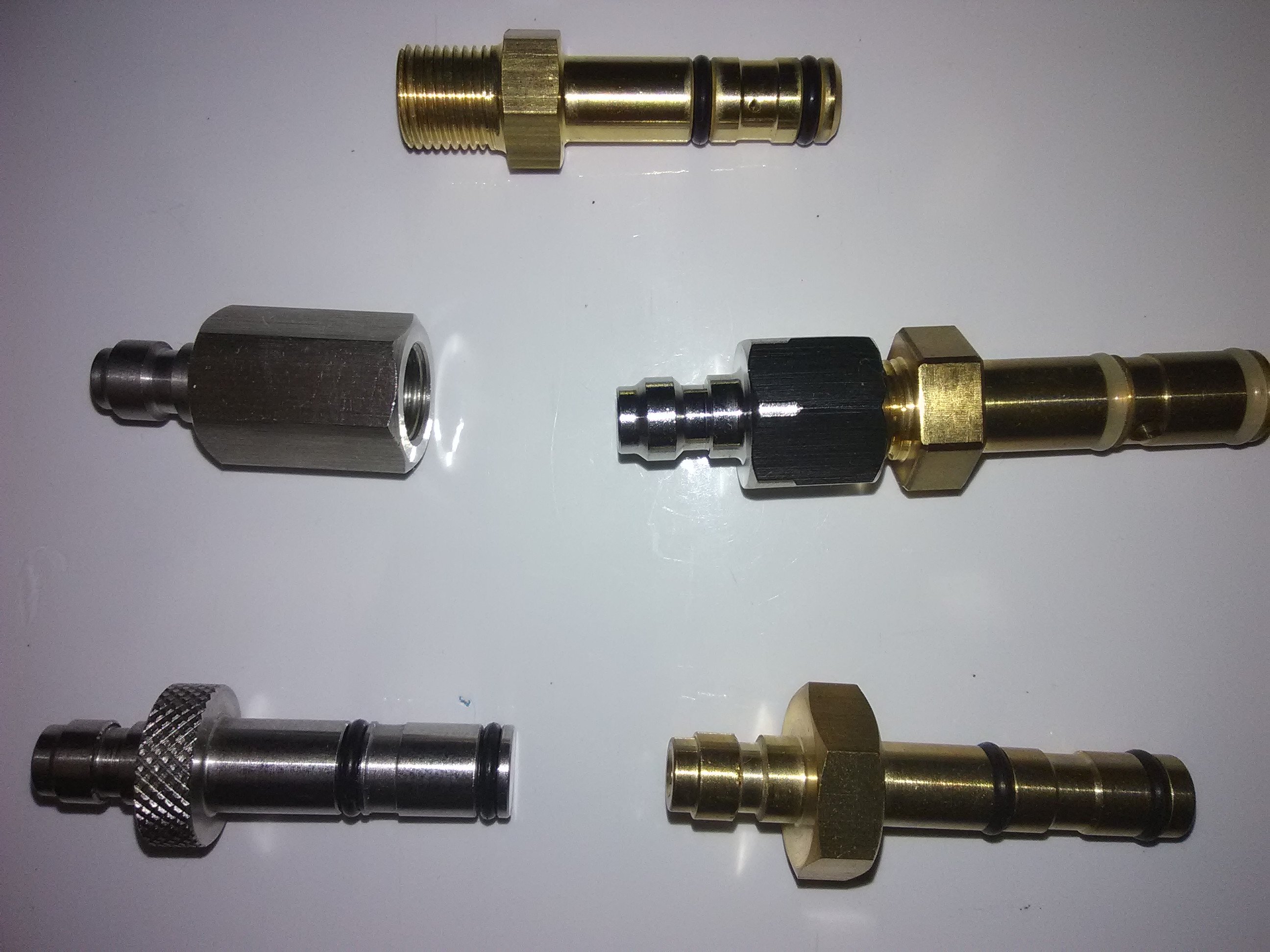

the fill probe that is on the included whip will unscrew,
so you can then install it on your own fill hose.
or do like i did and install a male foster fitting onto the probe.

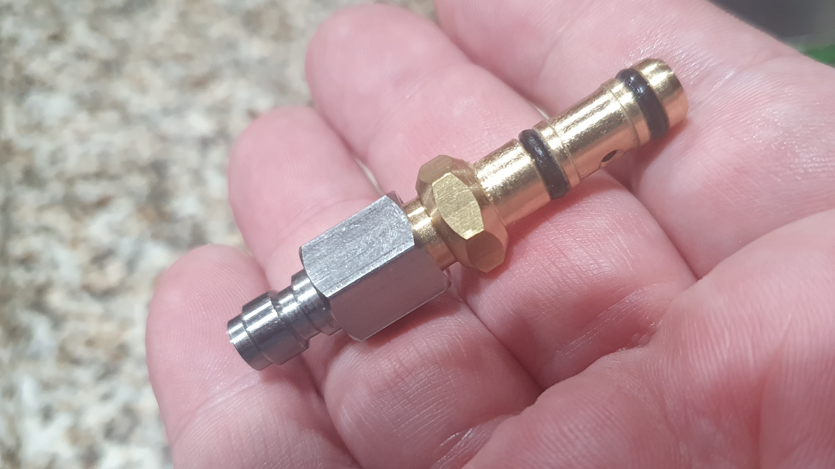

What's troubling is how Krale got it to work, and you can't. That fill probe situation sounds strange, not sure problem isn't related. My Uragan 2 and Vulcan 3 both use same fill probe, my Uragan .25 uses a different one. I pulled fill probe from fill whip that came with Uragan 2 and installed male quick-disconnect adapter, looks something like this.

yep,ebay has them too.
but heres the one i have from pyramyd.
Reactions: WorriedMan
i would leave the red cap on,
and use the tank to fill,
i never had to dry fire mine to get it to seal.
hook up the correct fill probe
(you can take the whole hose off the included fill system and attach it to your air source if you dont want to wait for the adapter)
let the air rush in and give it a few seconds,
as mine took about 3 or 4 seconds of air from a tank before it sealed.
if it still doesnt seal,
point the gun to the sky and bump the butt of the gun on a solid surface while filling.
i have seen some need to bump it,
and some like me that just took a longer blast of air to get it to seal.
