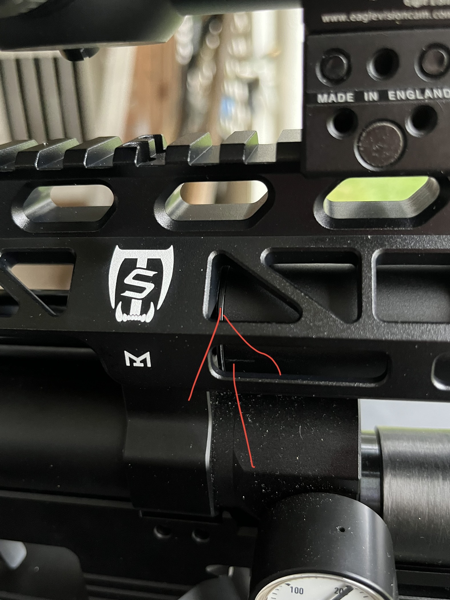

I have a Maverick 25 cal sniper. Shooting nsa 38.5 at 940fps. Groups at 50 yards are hole in hole. 75 yards the are all touching 100 yards is even good but for the life of me I can’t figure out why I’d be aiming dead center and I’ll have a group go high left high right dead center dead center but low. I indexed my barrel to where at 50 yards my windage and slug are centered. Even at 75 yards I have this happen as well. I’m about to sell all slugs and convert my maverick to a 30 cal 600mm and only mess with pellets.

I though about selling it as well and buying a Skout Epoch or Cricket 2 Tactical. I like the platform. But the poi shift is annoying. That’s with a tension barrel as well. I bought a saber tactical Trs hoping that it would help but the sniper shroud hits the rail.
I've had the same issue, Take out the barrel, and make sure everything is SNUG, re-assemble with a bit of lube on the o-rings. I think you'll find the issue gone.

Very well could be. I bought a Trs and the factory shroud was touching the Trs rail. So I had to put my tensioner barrel back on. And I can only put it so tight.l before it pulls out the breech.

Yeah so I had DonnyFl machine me an adapter to screw on the liner nut to 1/2 20. I place the carbon fiber tuner over barrel housing place adapter on ans basically turn it from 12:00 to between 1 and 2:00

Want a suggestion, get back to basics, take off all of the crap, put it back to stock but with the carbon liner and see what happens. My project gun started out as a .25 sniper, it's now a ground squirrel killer at 125 yard Compact .22. My Mav. .25 VP is an insane shove something in it and it'll just drill holes. Both are basically stock except for the CF liners, cleaned up liners, Pellet Probes but both are on the pellet transfer port. As I said, I was having the same issue but found that things were a smidge loose and only a smidge but enough to cause the liner to shift.

I’ll check out all my screws on the gun and complete tightness on the barrel. I still have factory hammer and probe in. But I’ll report back when I am able to shoot it.
