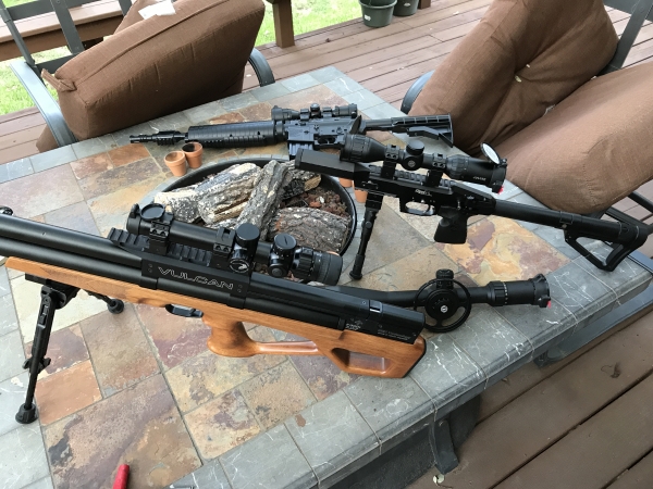

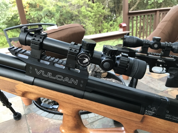

I mounted the scope to my Vulcan, and it works great except that at anything over 8x zoom, there is this annoying sun flare, or glare.

I see your front cover is rotated to the top (so it opens closes in the vertical plane) .
Try to screw it back in to where it will go not further, it should open and close exactly in the horizontal plane.
I think the coverpart is NOT a loose piece that clips over the tube, but in fact is the locking part of the front lens.
