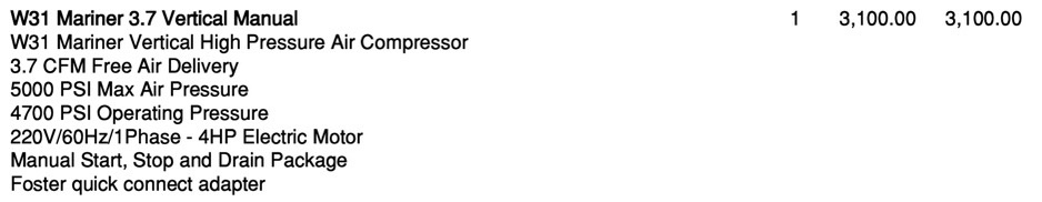

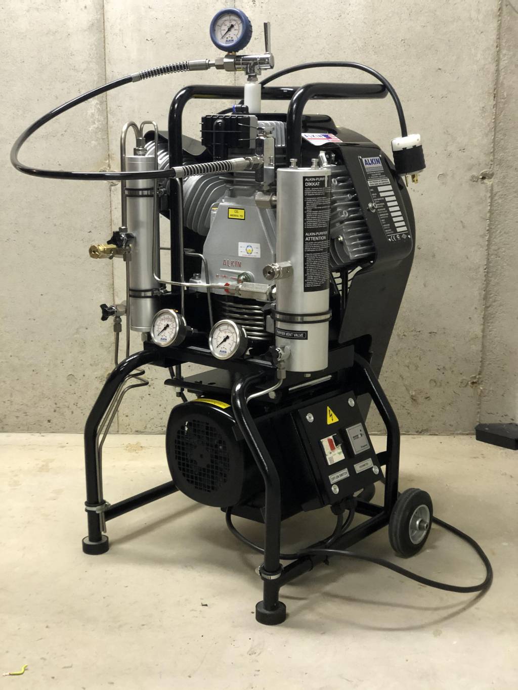

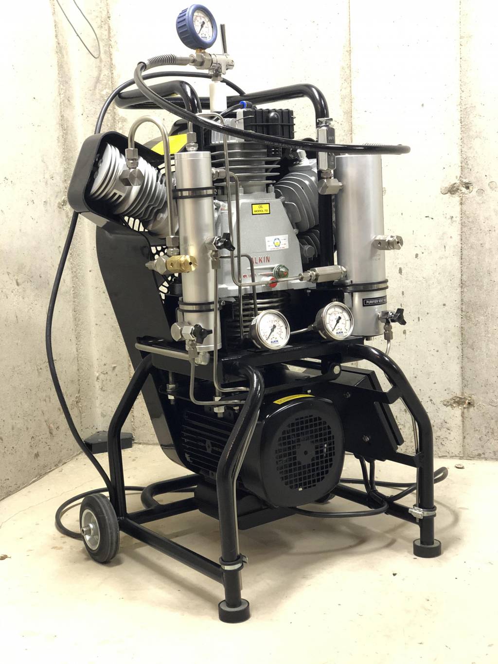

Now that I got mine home, and the plug installed, I thought I would post a few pictures. Let me say: the vertical configuration is REALLY nice with the roller feet-super easy to move around for one person!

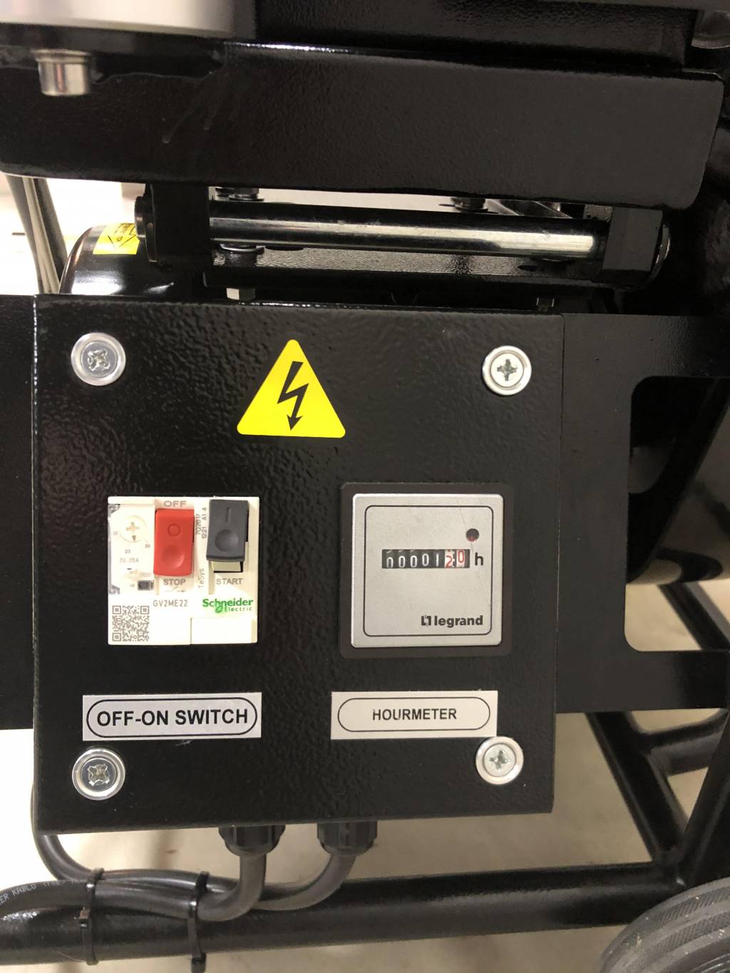

I like having the hour counter on the unit as well. You can tell this unit was designed right. Talking to David, he made it clear the the parts sourced in the unit were German or other high quality parts-and it shows in person. Definitely happy with my purchase!
I just need to wait for my male-to-male foster fitting to arrive now (included by Alkin).
I should also add: David (user: AlkinCompr) has been super helpful to me (as has Steve, aka Humdinger, here on the forum). David reached out to me to ask if I had any questions, based on my post here at AGN. Since then, he has emailed me, texted me, called me live on the phone, and PM’d me to answer all my questions. That includes texting me back within minutes, after hours, for simple questions I had. This kind of support definitely makes spending a little more money well worth the expense.
Additionally, the unit came with a 44 page parts book that has exploded views of exactly how the unit is constructed, with part numbers for everything, and wiring diagram for the whole unit! The only thing it doesn’t have is torque specs-but I’m certain David will provide them if I ever needed them.

The vertical unit really is nice and I’m glad I went with it. It makes moving around really easy-which is important right now because we are getting the insulation done in the basement, and a bedroom/bathroom built down there also. Thus I am already using the portability right from the start. The unit is not all that loud either-pretty pleased with that.

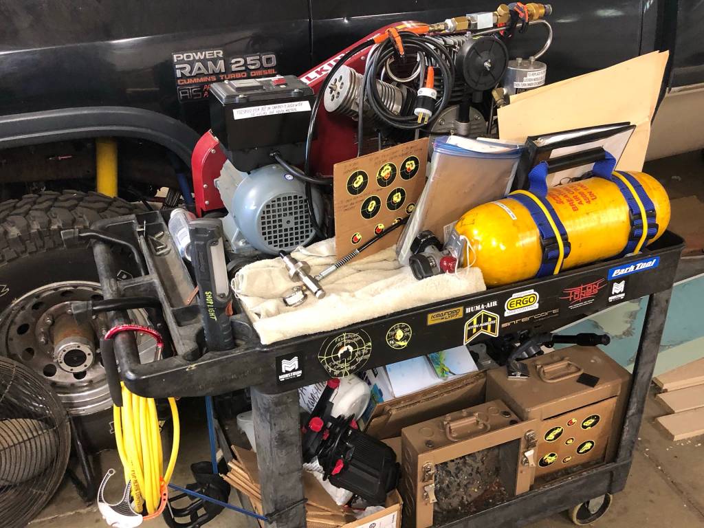

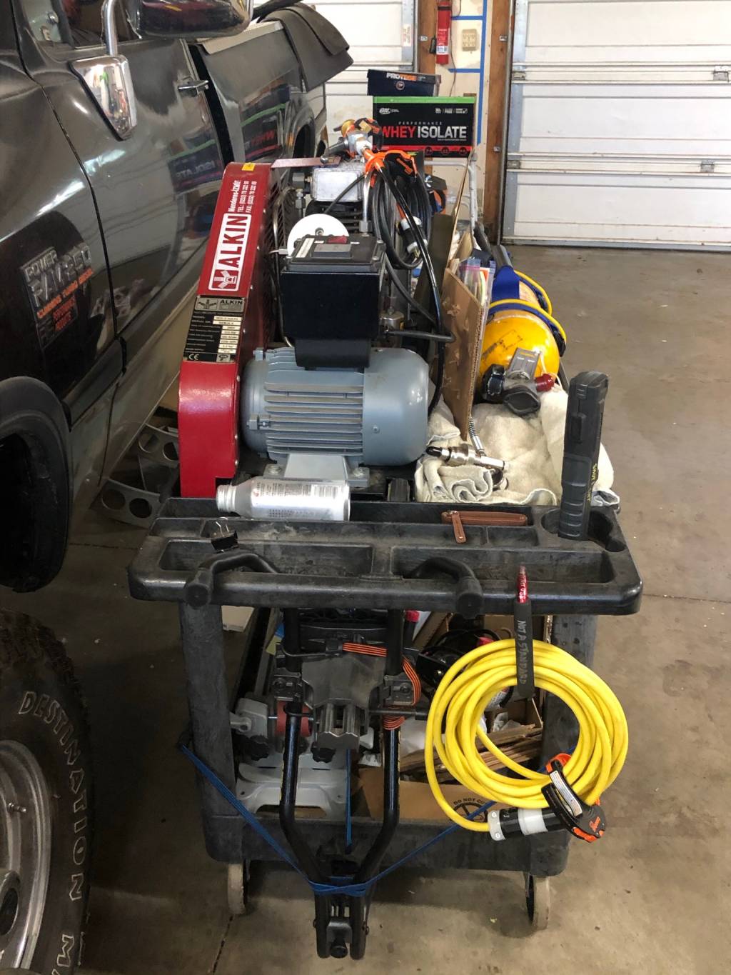

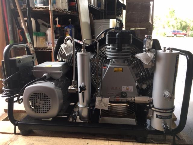

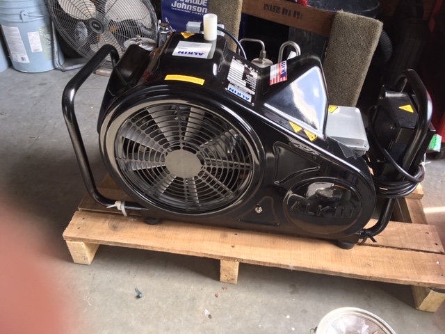

My 2004 model W31 just hit 44 hours. This thing runs like a well oiled top, and never ceases to surprise me each and every time I use it.
I actually look forward to my tanks getting low, as I really dig using this thing. A few pics to share-

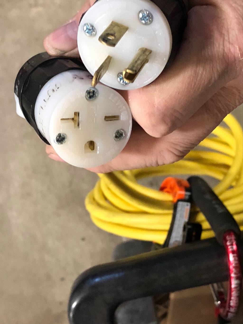

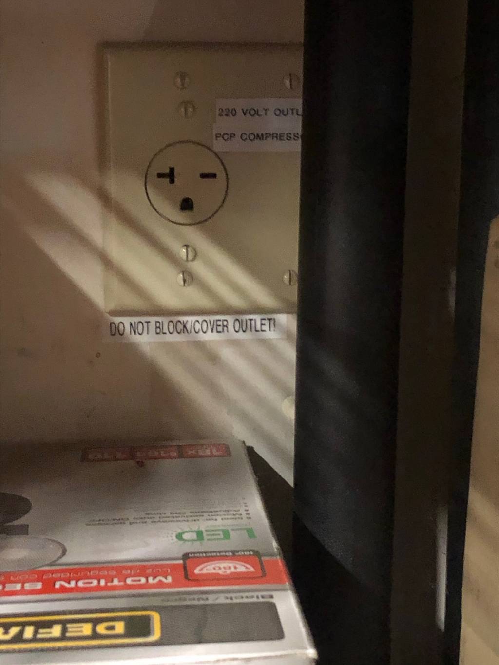

When sourcing your electrical supplies wether you do your own electrical or hire it out, keep it simple. No need to buy expensive and bulky dryer type plugs just cause it says 220v. If doing the electrical yourself, invest in the book at Home Depot that’s usually pinned up in the aisles of the electrical parts section, titled “Wiring Simplified”. It’ll have load charts that’ll aid in wire size needed for the distance you’re Alkin will be at from the panel and your breaker used.
I opted to go one size up in wire size to #12, and at that wire size I can go out as far as 75’ which includes the cord on the Alkin, to carry the amps. I stayed at around 30’, which in my case is perfect as I can wheel my cart out to one end of the garage and the plug on the #12 extension cord taps into the outlet on the opposite end.
From my garage’s sub panel to the outlet is only like 18”, and I went overkill and used #10 wire from breaker to outlet.
