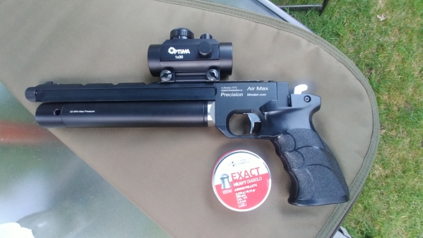

airmax mk 2 .22 pistol aka pp700sa. great pistol barrel is only around 9 inches lots of tuning and middling potential but great shooter right out the box under 200 bucks gets around 30 shots. I love mine. I put a short 4
inch ldc on it and it works suprisingly well for being so small
I second this choice. I have one in .177 with a red dot on it. I use it for pistol field target. If I miss it's my fault.
