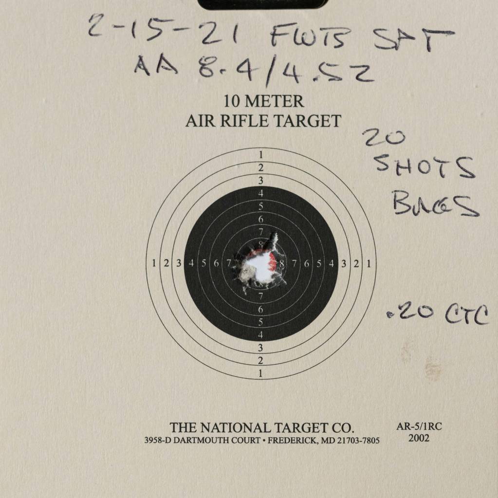

It depends what you want to do with it I suppose. I do my indoor shooting with an HW55 offhand. Before that, it was with a FWB 300s, but I find the 55 easier to handle offhand. Outdoors it is usually a TX200HC that I shoot sitting at distances out to 50 yards. I also have an R9 with a chopped barrel that I carry around when hunting. And I recently bought a FWB Sport just for fun and to have one full power springer in my collection. These are the ones that made the cut for me. There were more that did not.
All are accurate enough for the intended use. The FWB Sport is turning out to be a dependable 2 MOA shooter, which is about what I think you can expect from a good quality springer. Here is a recent group I shot over the chronograph indoors at 11 yards using an ordinary bag setup, just under 2 MOA. The trick to enjoying springers is to keep your expectations reasonable.
