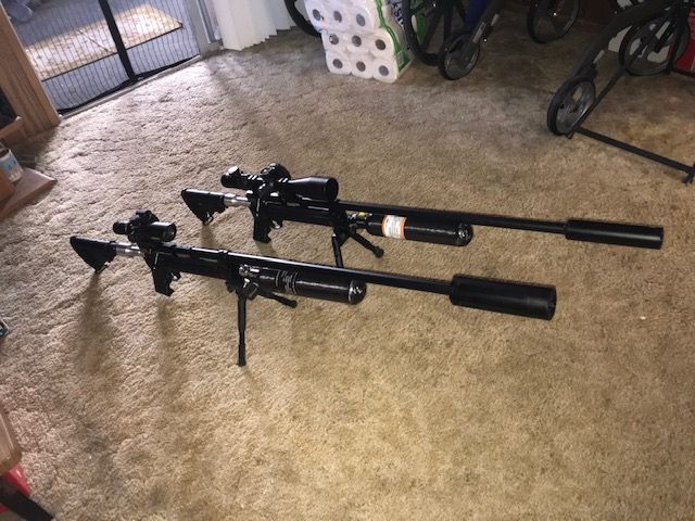

I too have all three calibers in my Gen I Marauders.
I also have many, many, many pellets..
The .25:
Another vote for the Marauder .25. I have them in all three calibers.
