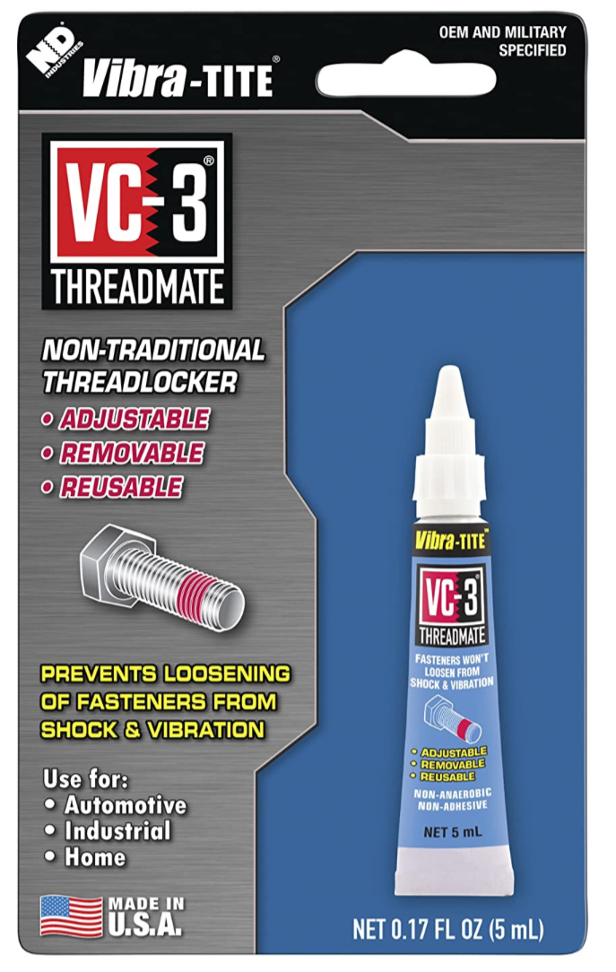

I’ve got an HW97K. I used a SportsMatch Dampa one piece scope mount, as spring air guns can break scopes and the Dampa mount reduces springer two-way recoil. HW actually recommends the Dampa mount in the owners manual of its nitro-piston springer. I also used an SWFA SS fixed power scope - as they were originally designed to military spec and are super rugged. I’d recommend VC-3 Vibra Tite for the stock screws, instead of Loctite. VC-3 is like a rubber coating on fasteners. It prevents loosening due to vibration (every Harley owner uses the stuff, lol) and unlike Loctite, it stays usable without reapplication if you decide to take the stock off and then put it back on. Hope this helps you get “springer ready”.

Yes, you should Loctite the stock screws. The two at the pivot and the one big one at the back of the trigger guard. If you don't, you will find your zero moving and you'll have to tighten them again and again. I use blue Loctite or the equivalent from the auto parts store.
