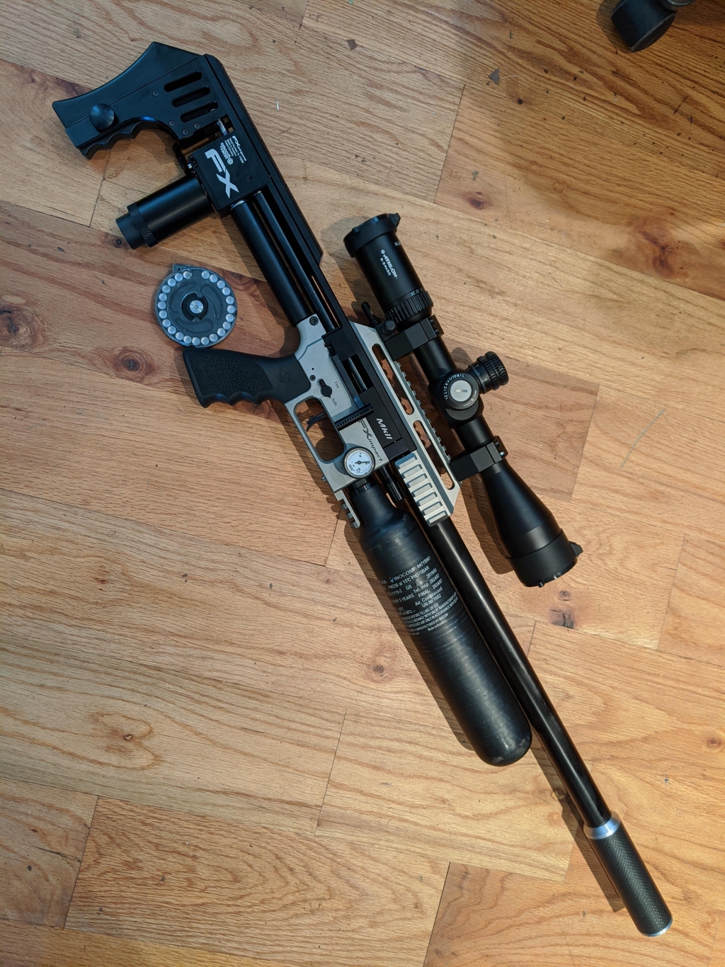

I have a bunch of guns and have been doing PCP for 3-4 yrs now. Not long compared to some folks, but long enough.
My collection:
.45 Winchester Model 70, Athlon Argos BTR 6-24x50mm Mil
.30 FX Impact, Athlon Helos BTR 6-24x50mm Mil, Side Shot large capacity magazines, tuned for 100fpe!
.22 AA S510 Carbine, Athlon Argos BTR 6-24x50mm Mil, Huma Reg, Cross Drilled Pot, Lightened Hammer
.22 Weihrauch HW98, Athlon Helos BTR 6-24x50mm Mil
.22 MrodAir Airmax, Burris 2-7x32mm, Tuned, Huma Reg, Guided breech block
.177 Edgun R5M, Athlon Helos BTR 6-24x50mm Mil
.177 Artemis PP700S-A, Vortex Venom Red Dot, Tuned, Huma Reg, Guided breech block, LDC
The .30 FX Impact is by far my favorite.
20yds is nothing, stretch it's legs out to 100yds. I just changed the Impact over to slugs and am grouping dime sized 5 shot groups at 85yds. I've got a little more tuning to do, but the Impact shouldn't have any problems doing dimes at 100yds and pushing over 100fpe.
The Impact is expensive, but it's so worth it.
The Edgun is another nice rifle, but it can't stand up to a modern Impact.
Others have their favorites too, but IMHO, the Impact is the top of the heap and not as expensive as other top of the line guns.
