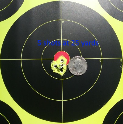

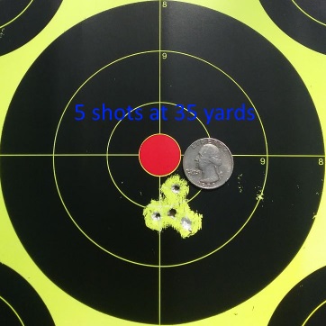

Just went out and did 5 shots from 25 yards and 5 from 35 yards. I'm using a shooting stick (monopole) only supporting the pole with my left hand. I could do better using a bipod, tripod or shooting from a rest. For me, stacking pellets from a bench is boring. I enjoy the challenge of shooting off hand or using a single shooting stick and the challenge of shooting a springer. See video's below for some fun shooting.
