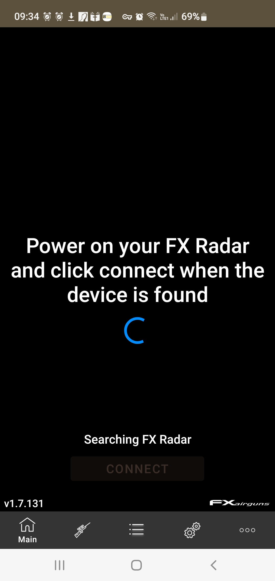

Yupp, StarlingKiller, all permissions on, both the blue tooth and the white tooth are brushed. The green light on the chrony is on.
I selected the following device:
"FX Pocket Chronograph MkII"
(There is also a "FX Pocket Chronograph V2". That nomenclature doesn’t confuse the users at all! — I think the FX marketing guys that are in charge of giving names to FX products got tired — after they landed coups like PowerPlenum.)
And I get the following screen:

Is your "Auto Reconnect" on? If you had it open and closed it, usually it's still in the background, or open apps screen. You need to close it out from the background by swiping it closed or "Close All" on that screen. It doesn't work very well launching it from the open apps screen after closed initially. It needs to close completely out before restarting again.
i see you have the updated app.
i havent updated mine.
if youre running the first version of the fx chrono (also what i have)
why select mkII?
soon as you turn on the chrony it should recognize it.
thats why i enable the location and bluetooth,
then start the app,
then turn the chrony on,
never fails to recognize it.
● Yes, I do Android — I have not bitten into that apple....! 😆
● I did another reinstall of the app. Then went and enable all the permissions — including bluetooth and location — before starting the app.
● The app, when first started, takes me through several screens with instructions — including one where I have to select which device I want to connect to the app. This screen is an obligatory selection, no bypassing it.
● The Android list of bluetooth devices connected and/or paired does not show the chrony.
But I do remember that some devices are like that, they use their own app's pairing screen instead of the Android bluetooth screen — and subsequently do not show up as connected on the Android bluetooth list.
● I have gone through each and every menu possible, and enable each and every item.
➠ Still no joy.
The same sad message I showed above in the screenshot.... 😞
Matthias
