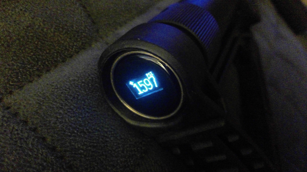

My experience with the EDMU in psi setting is not to have it on psi setting. Here is what happened the one time I set the gauge on psi mode when I refill the leshiy. The gauge display wouldn’t turn off for a long time cause after the Leshiy got filled the gauge reading keep on changing cause of the pressure not settled due to small side tube and heat generated from the fill. Normally he gauge display will turn off a few seconds after a top up the leshiy when the gauge is set to read in BAR mode but in PSI mode the reading continues to have small changes until the tube cools down and reading stays still and the display will turn off.
Jack K,
I had the same problem with the EDMU on my new R5M, immediately after setting units to PSI. I had to perform the electrical reset several times by shorting two of the contacts with a pair of small needle nose pliers.
After seeing the units back to BAR, it has been well behaved.
Sounds like the app's developer needs to add a time-weighed averaging algorithm for the PSI values since they are 15 times more variable than BAR values.
Jack K,
So can you charge the rifle in the BAR setting, wait for it to cool and equalize and then change to the PSI setting without issues?
