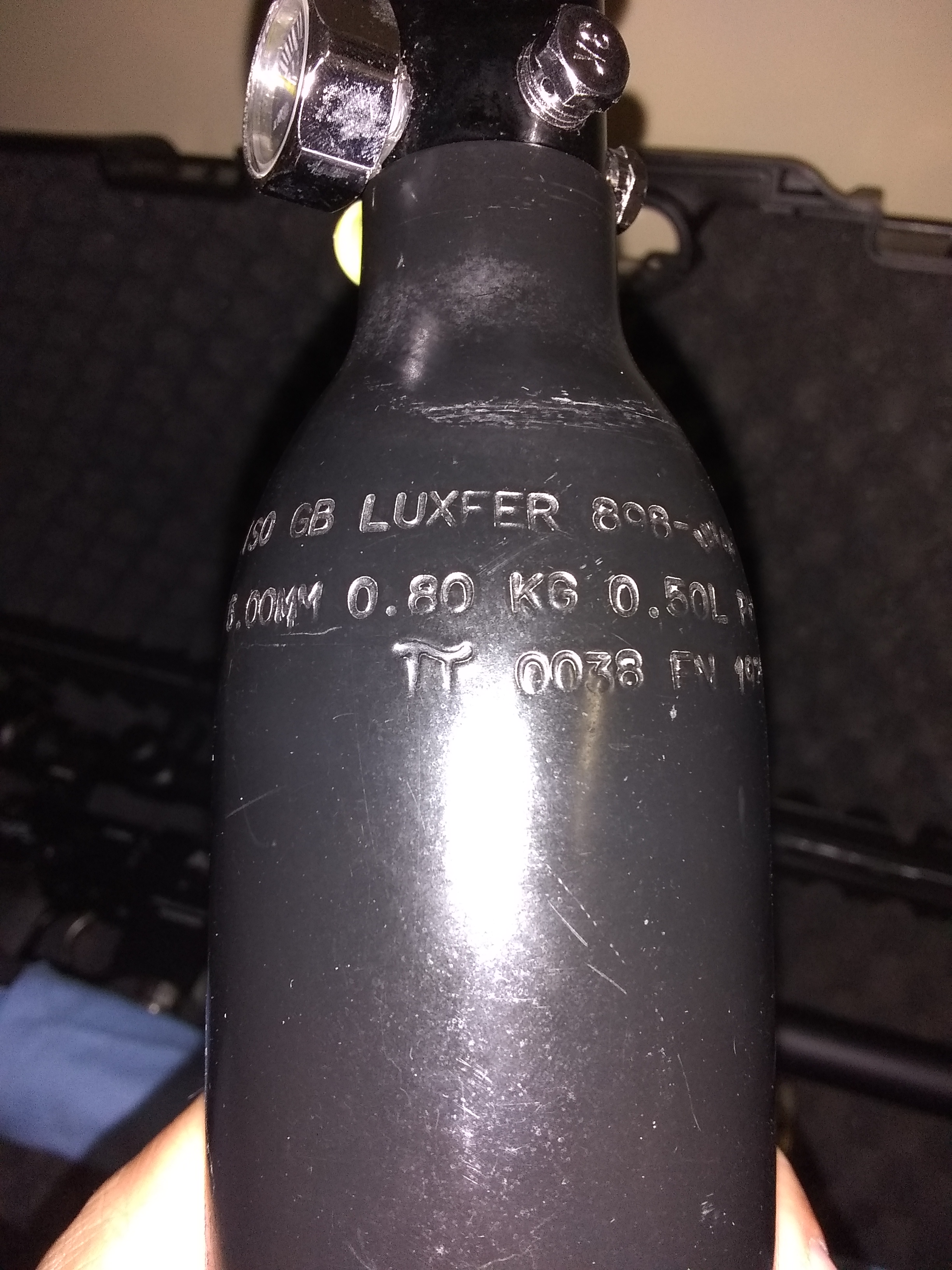

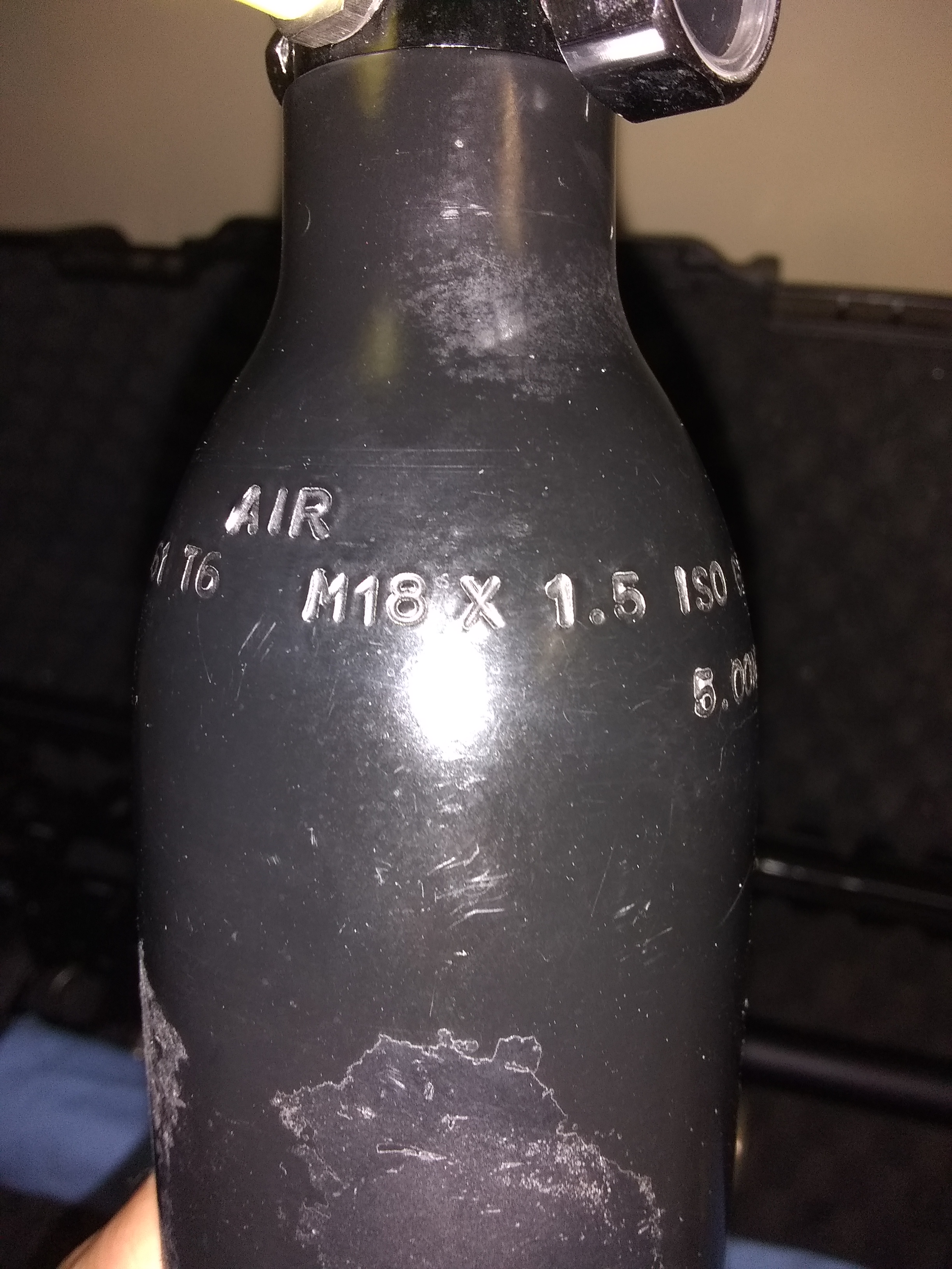

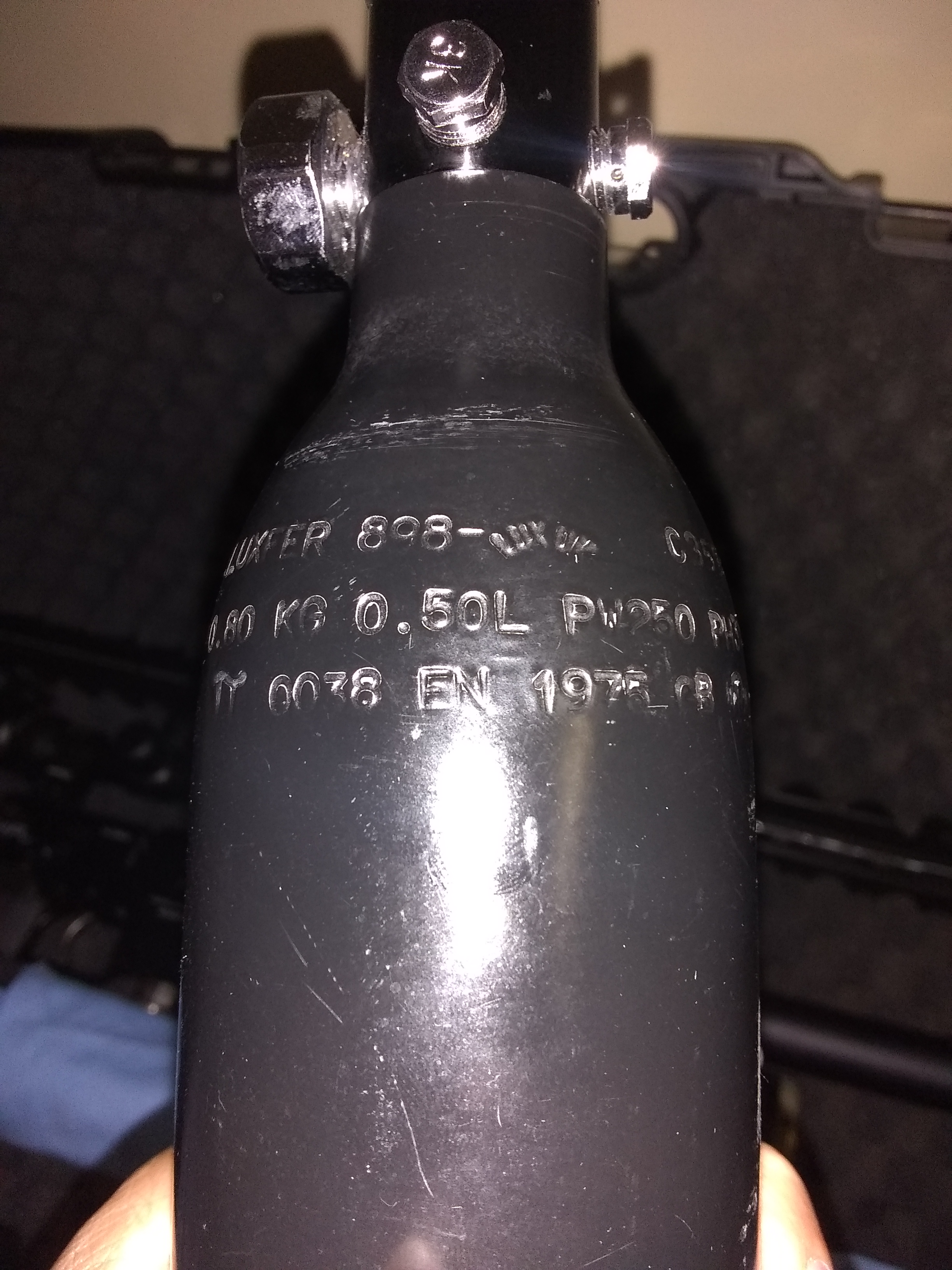

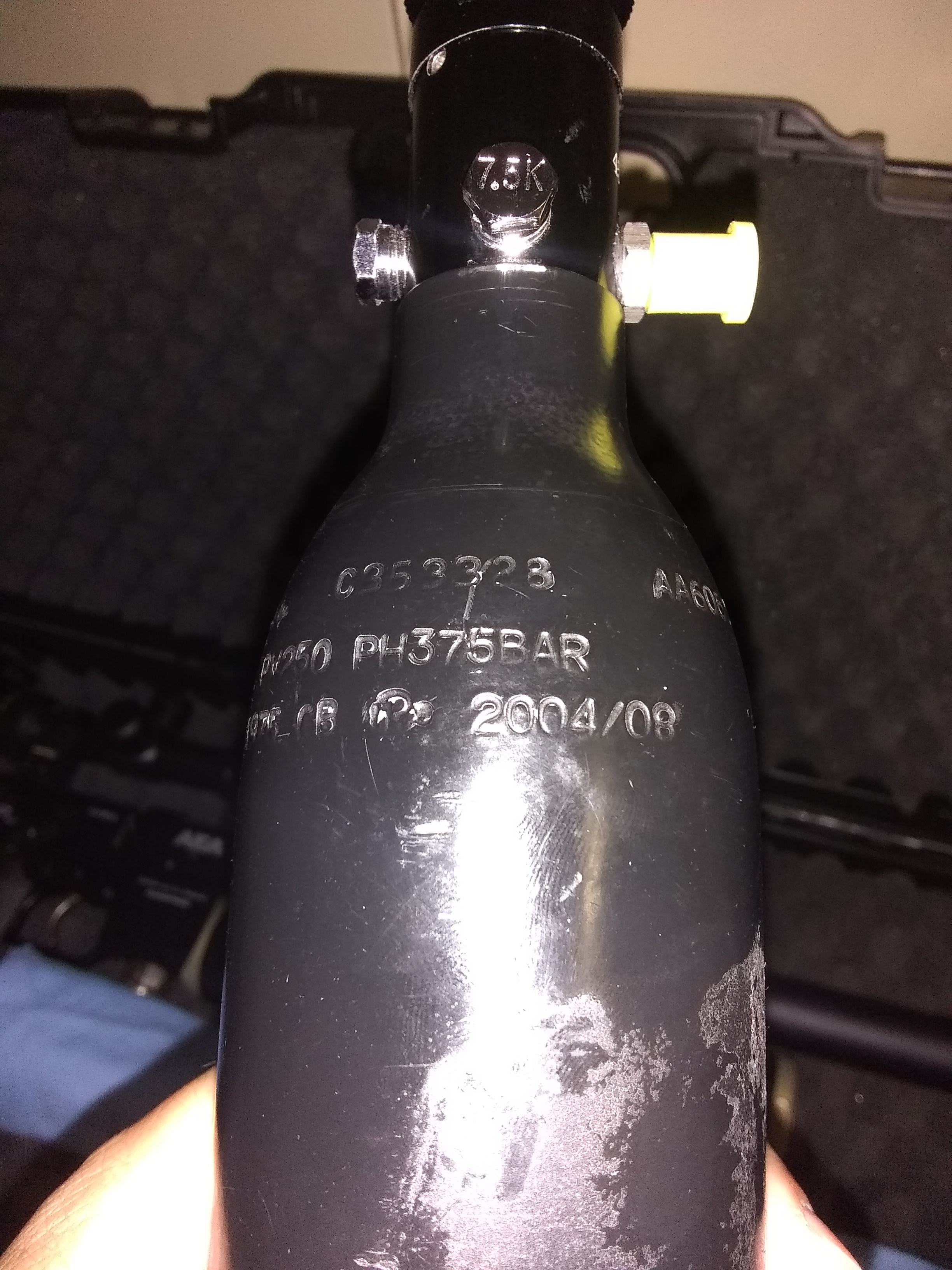

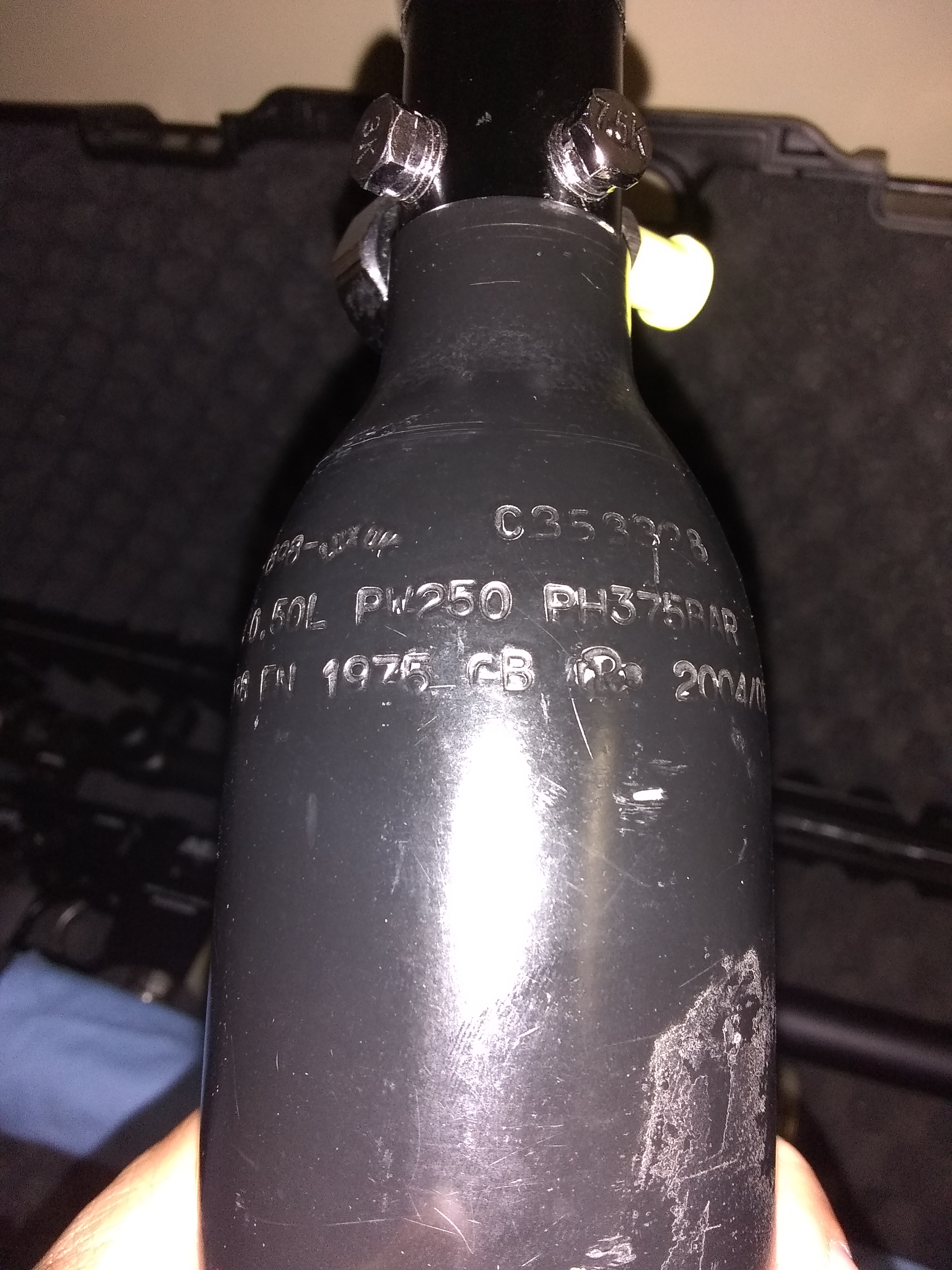

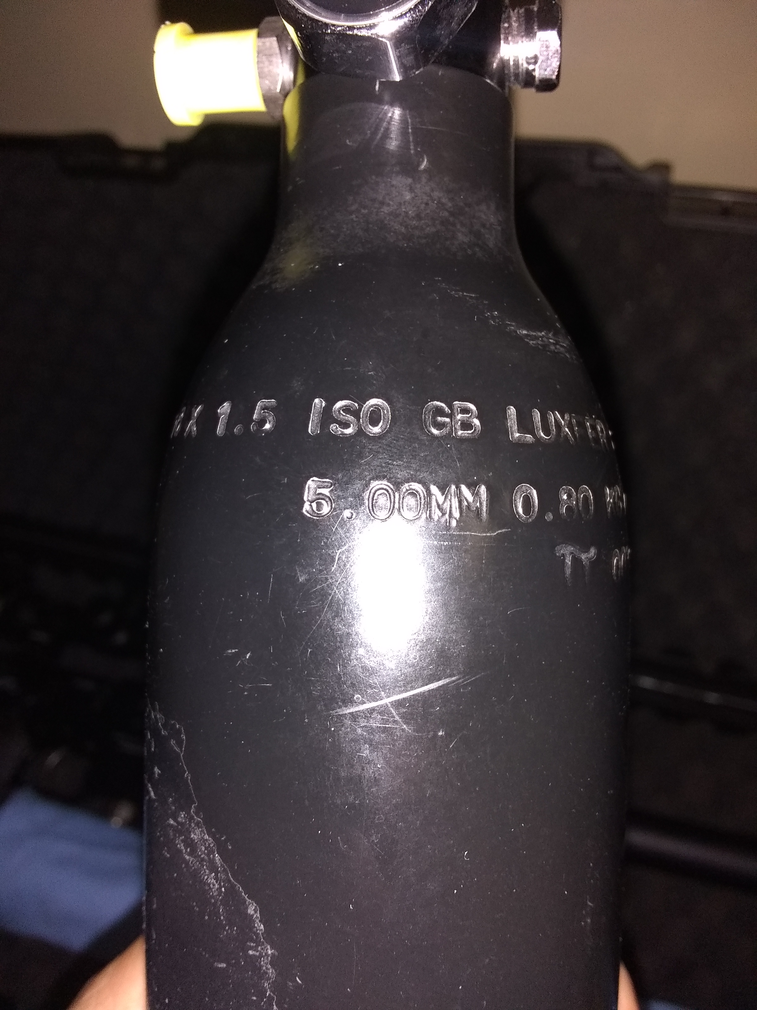

Trying to make sense of what all these numbers mean. I'm sure it's a 500cc tank. The 375 bar refers to what, working pressure, maximum pressure ? Does the 5.00 mm refer to the tank thickness ? I guess what I really want to know is what is the maximum pressure I can fill this up to ? Thanks
The link to LUXFER helps for sure, But can just from general bottle knowledge state this ...
6061-T6 MATERIAL BOTTLE MADE WITH
M-18x1.5 NECK I.D. THREADING
5mm BOTTLES WALL THICKNESS
.80kg BOTTLES WEIGHT
.5L BOTTLES VOLUME
250WP MAX WORKING PRESSURE
375PH HYDRO TEST PRESSURE
2004/08 MANUFACTURED YEAR & MONTH * EDIT this stamp done at time of certification, not manufacture

Probably manufacrured in August 2004. Without a history of knowing how many times it has been filled, and being 19 years old, I'd replace it. You could be fine for years, but for me I'd rather spend some cash and start fresh and safe.
Could also stay way below PW, as I said before he has a 3k burst disc so I imagine its still plenty safe at that pressure, I'd keep it in service personally if the inside showed zero sign of corrosion.
Thanks for the helpful info. Makes sense now. So the max pressure I should fill this up to is 3600 psi.
Do these tanks have an expiration date? I see 1975, 2004/08, does that mean this tank expired in 2008 and should not be used ? Don't want this thing blowing up on me.
Max 3600psi, not with a 3000psi burst disk.
Tanks do have an expiration date, at least most do. Tank was probably made in 2004 and requires a pressure test every 4 years, with a max of recerts.
If I were in your shoes I wouldnt even think twice about replacing it. They are less than $100, a lot cheaper than facial reconstruction surgery.
