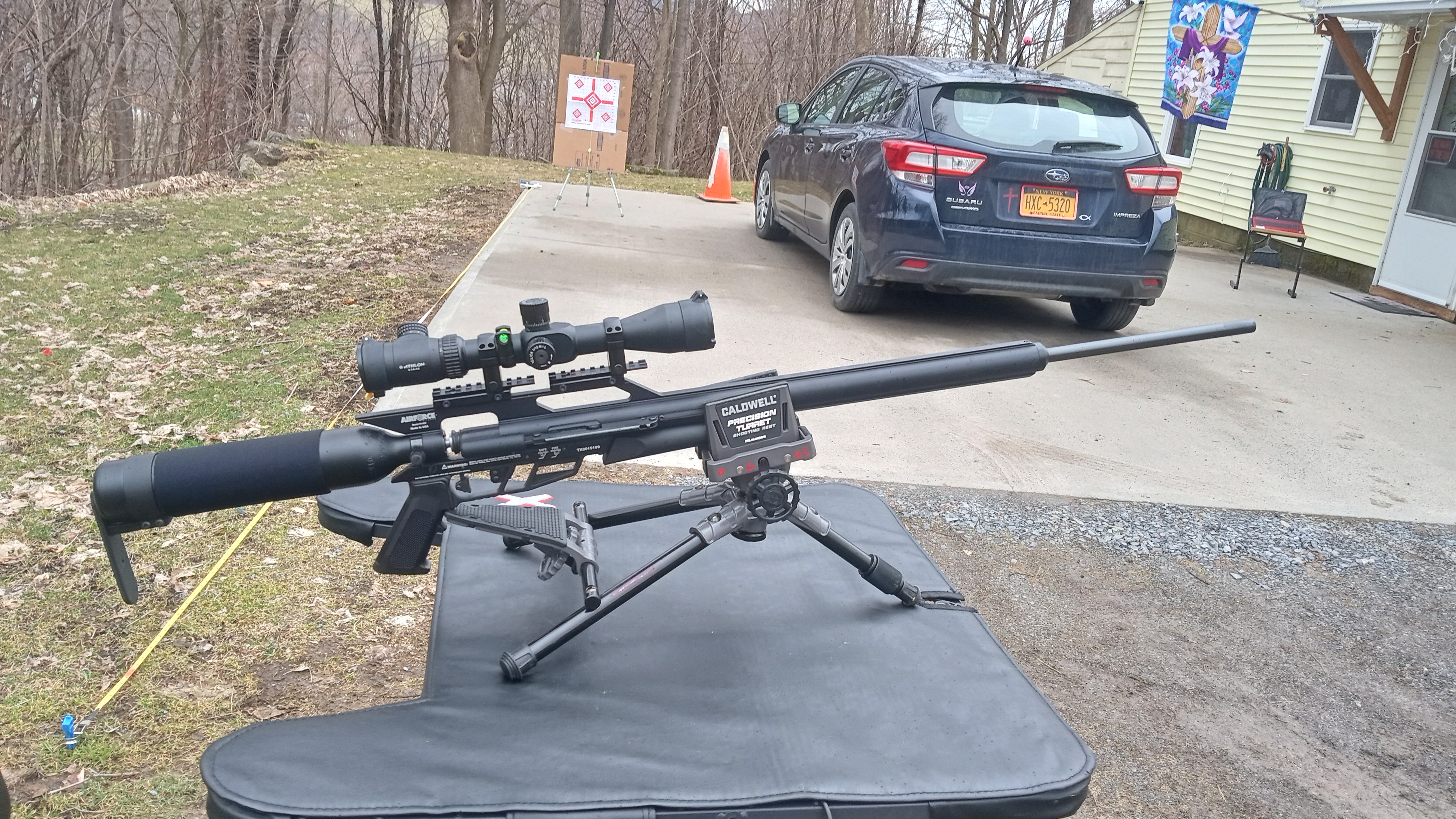

Mine is a Marauder Semi-auto.

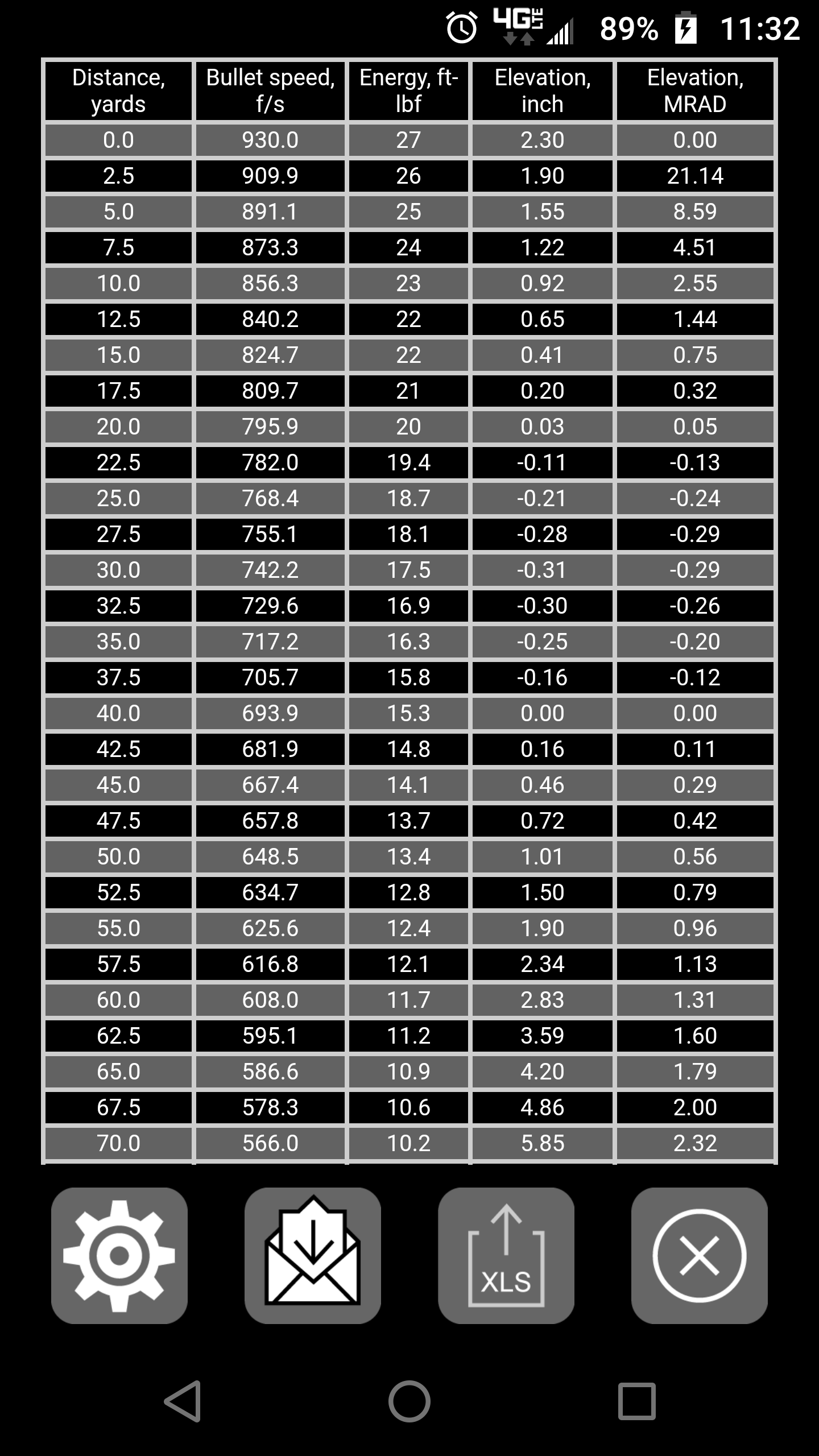

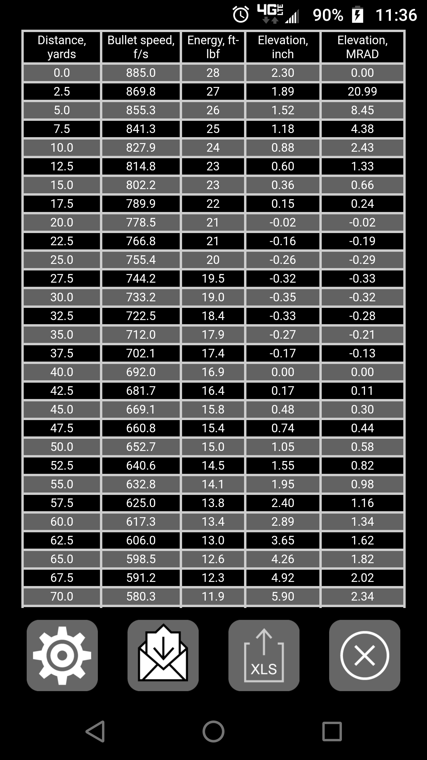

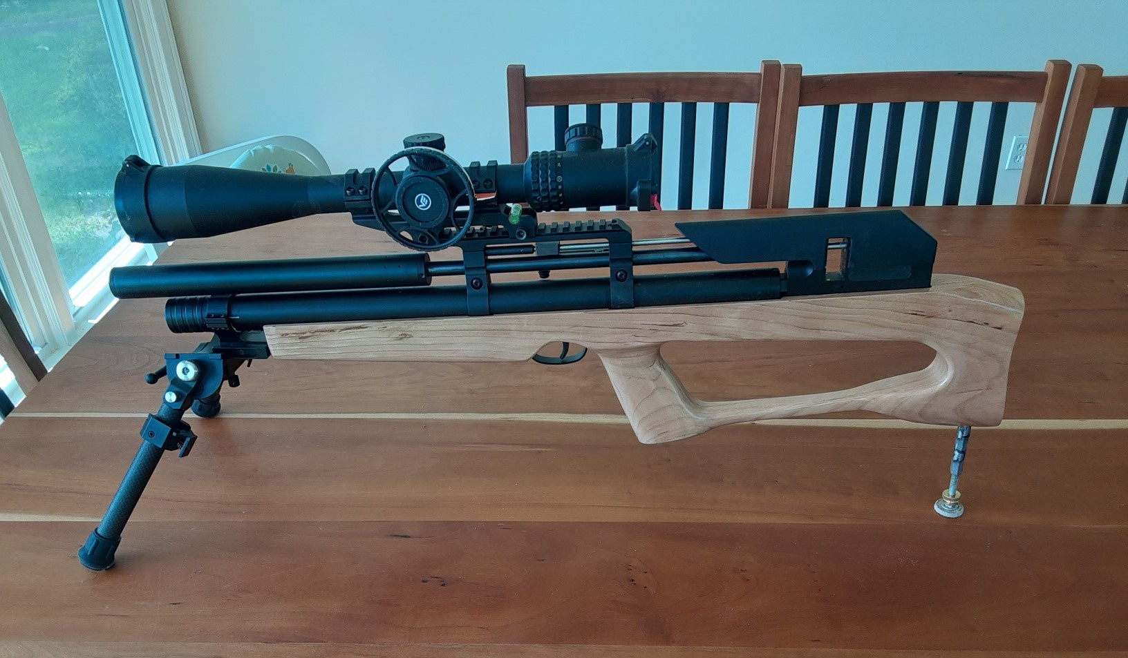

These are from. Strelok Pro. The faster pellet is Crosman Premier 14.3 grain. The slower pellet is the JSB Hades 15.89 grain. I'm not sure if the bc is exactly right long range yet, but somewhere close.

These are from. Strelok Pro. The faster pellet is Crosman Premier 14.3 grain. The slower pellet is the JSB Hades 15.89 grain. I'm not sure if the bc is exactly right long range yet, but somewhere close.View attachment 355586View attachment 355587
That's some great data. I knew Pyramyds "up to 29 fpe" for his Armada Semi was pushing it. Makes me wonder how they got their #'s if you get 27 or 28 at the muzzle with lighter pellets. Maybe the 18.13 doesn't slow down as much and would actually get the 29? Idk. His is broken so I couldn't chronograph it
