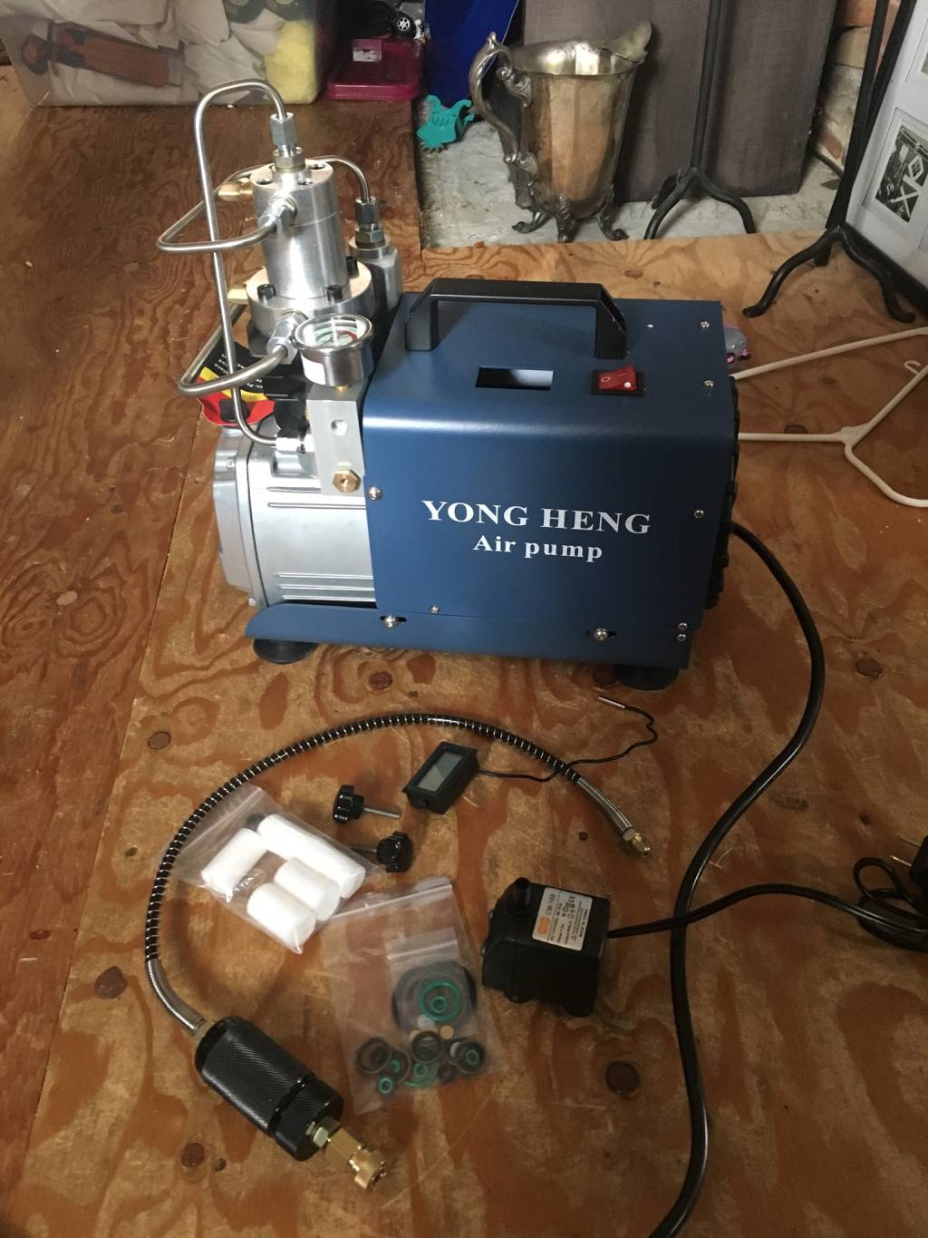

Welcome aboard Little moose. Things will ramp up fast for your want list. Spend your money wisely. Bottom line, you need air. Check out the "yong heng" compressor. Head over to ebay and pick up a used Scott tank or other brand with at least 5 years life remaining. Use the hand pump for backup. Before long your collection will grow. More shooting, more air....
Hill hand pump 300 bucks yong heng compressor 300 bucks No brainer
Welcome! You can definitely hand pump a dreamline, it wont be easy or fun.. Well I take that back, it will be really fun the first 5-10 times because you will be excited to shoot! Then you will be thinking "do I really want to shoot today? I'll just have to pump that dang gun again" lol. But dont be discouraged and think you have to buy an electric pump or air tank right now, if you are in decent shape without any medical issues you should have no problem pumping that gun up. A warning though, your first time is going to SUCK because you have to pump up that cylinder from 0 or 1000 or whatever they left it at. Eventually as you enjoy your gun you will invest in an easier air source... we all said we wouldnt, but most have. My buddy went compressor, I went tank (so i can bum his compressor to fill it) and together we have a good system to go shooting with. When you get looking, if you just have the one gun and dont shoot at a public range then the 12 volt 4500psi compressors are pretty dang nice. Would be loud and distracting if you are at a public range, but for filling up at an outdoor shooting area or at your house they are kick-butt.
