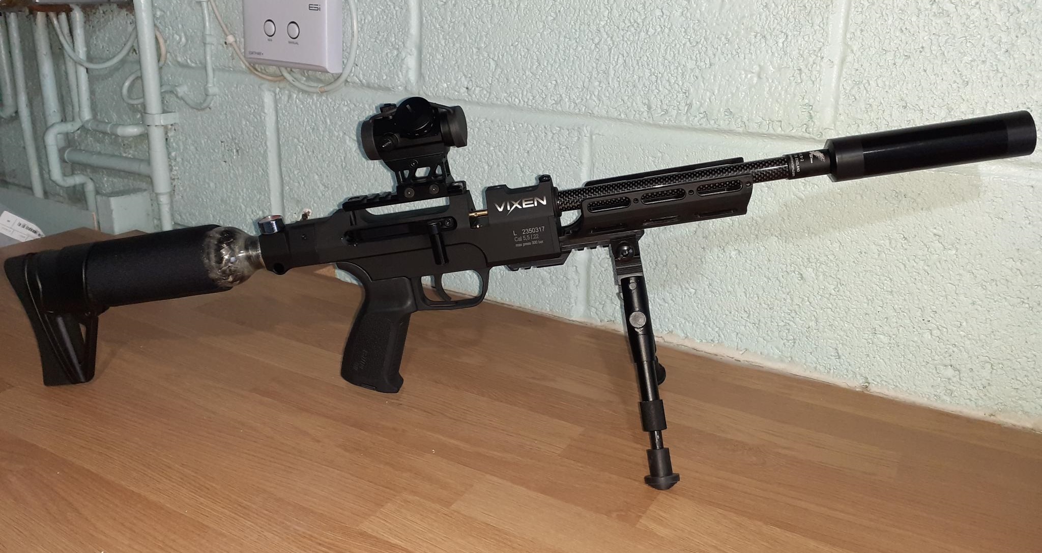

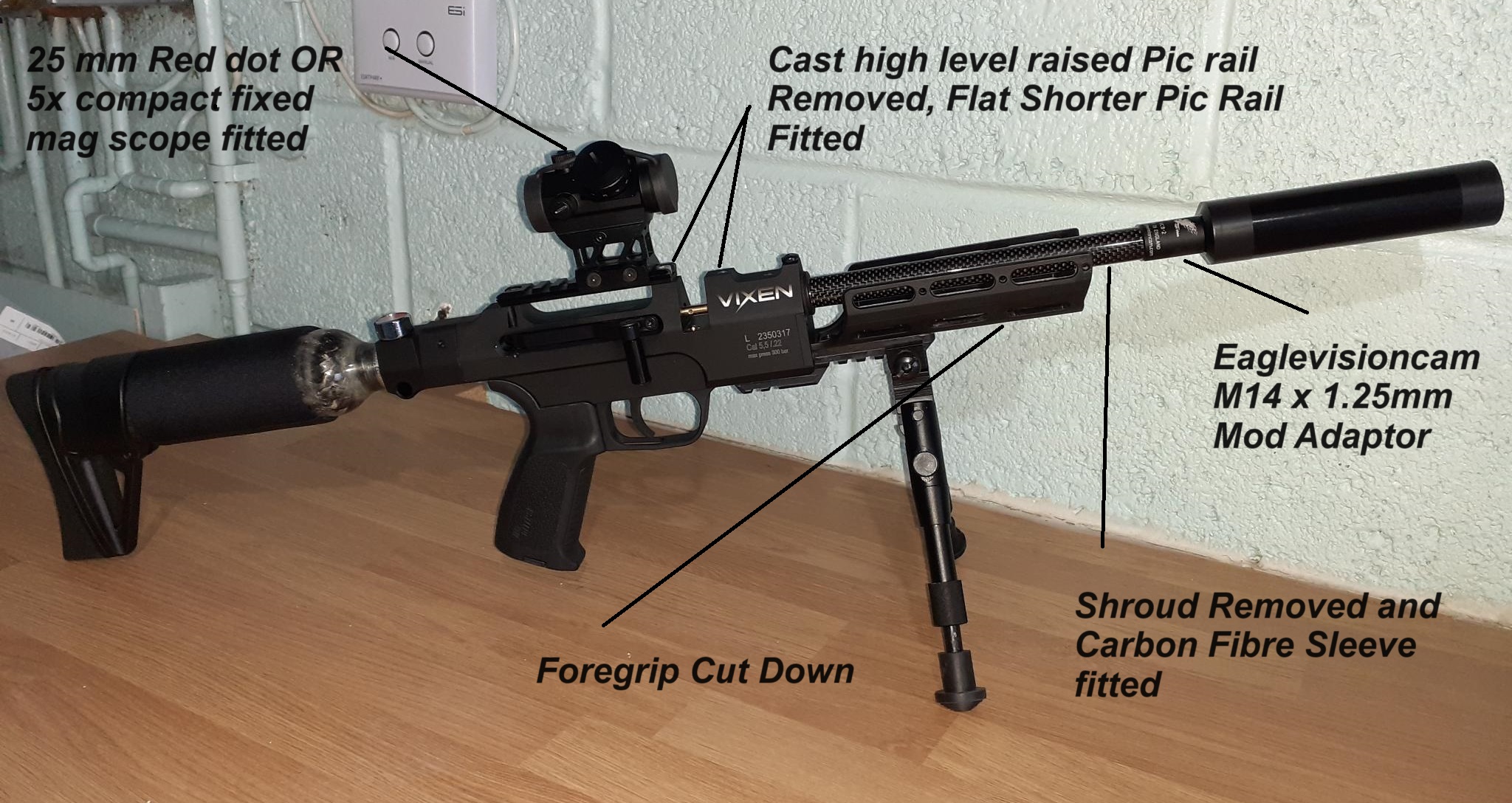

Hi guys, glad to join you, I recently added a VIXEN to my collection of Lightweight Carbines ( FX Dreamline lite, Webley Nemesis, Artemis PR900 gen 2 etc). I I have been told / advised that power adjustments / fine tuning for consistantly and tweeking regulator / hammer spring can be done two ways ? By transfer port restriction or by tuning / adjusting the Regulator / Hammer spring (using a chronograph) . I've seen the YT vids on regulator / hammer spring adjustment. BUT I can find NOTHING on the transfer port restrictor, Heck I dont even know where it is or how to inspect it. Can you guys please point me to the TP and tell me how to get to it.
