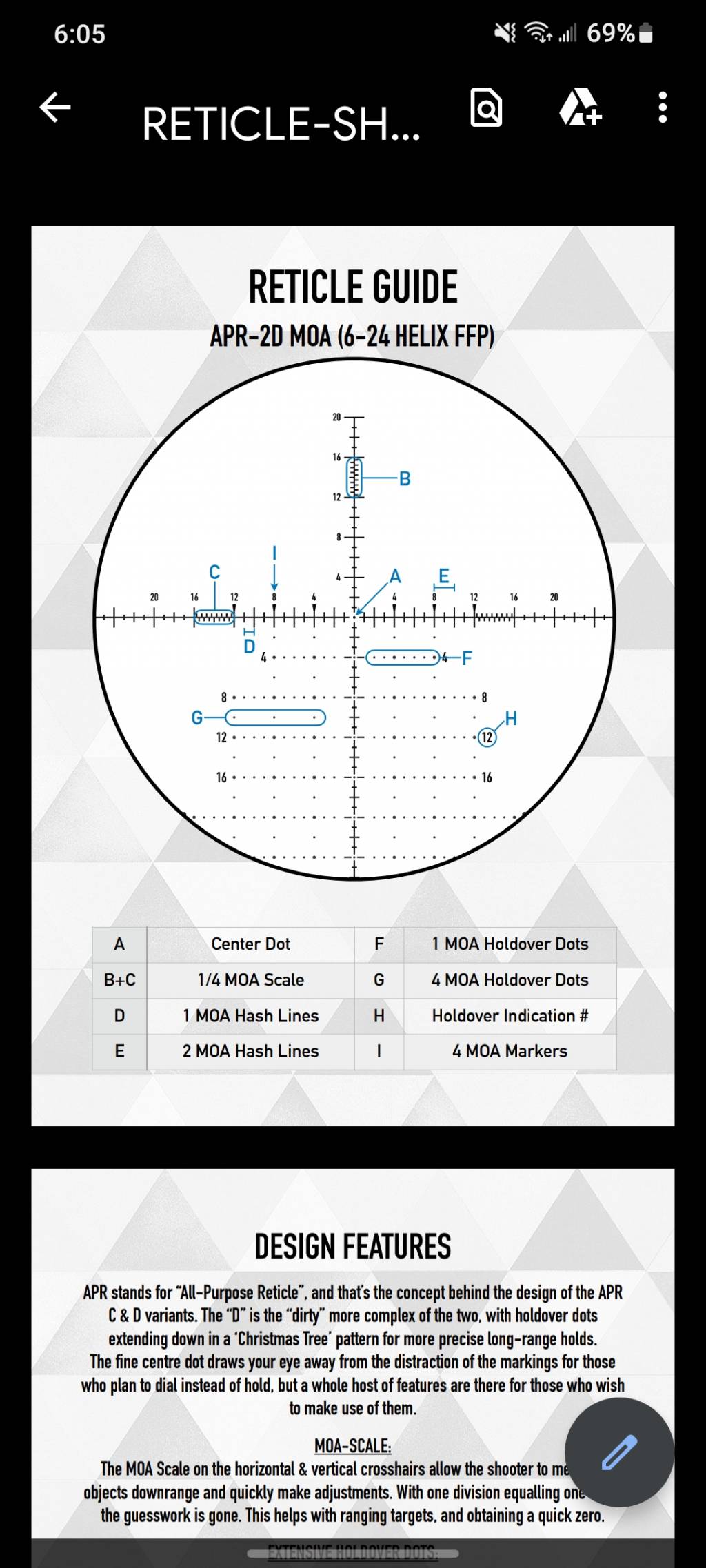

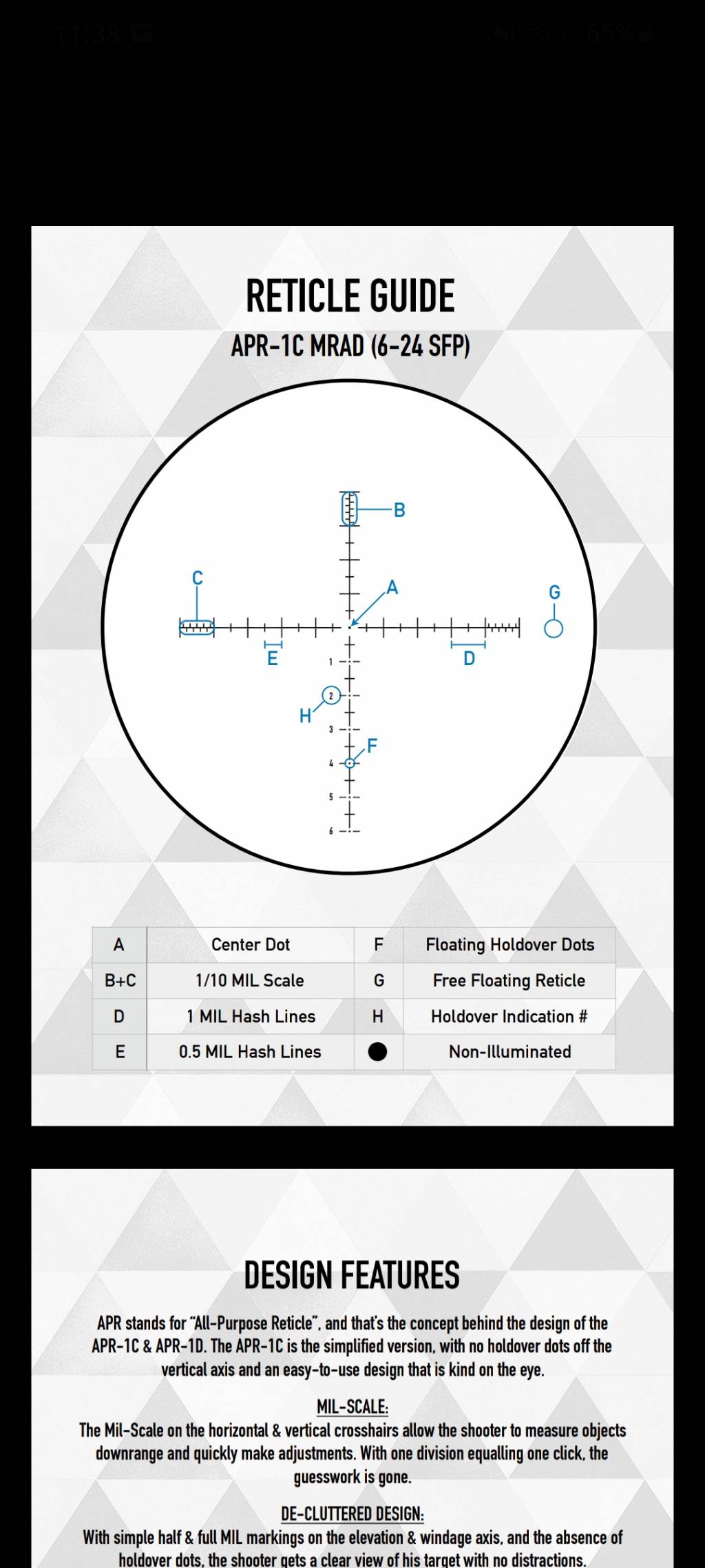

Sure thing. I got 2 scopes from this family. One is SFP with simple MRAD reticle and the second is FFP with dirty MOA reticle. Both shown below

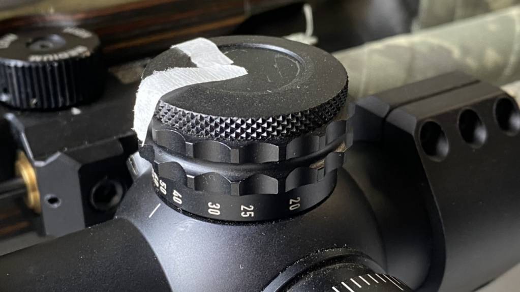

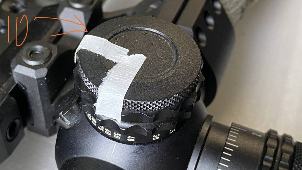

so I marked 10 yards and turned the knob to 55 yard or 50 meters on my scope and there is whopping full 3/4 of a turn! That’s solid 270 degrees!!!
also took a picture of the parallax wheel from another angle there is 1/4 of turn or 90 degrees of movement between 20-50 meters or 22 yards to 55 yards.
No sure if the 180 degrees of movement between 10-20 meter is all that useful though. The 90 degrees between 20-50 seems normal to me.
