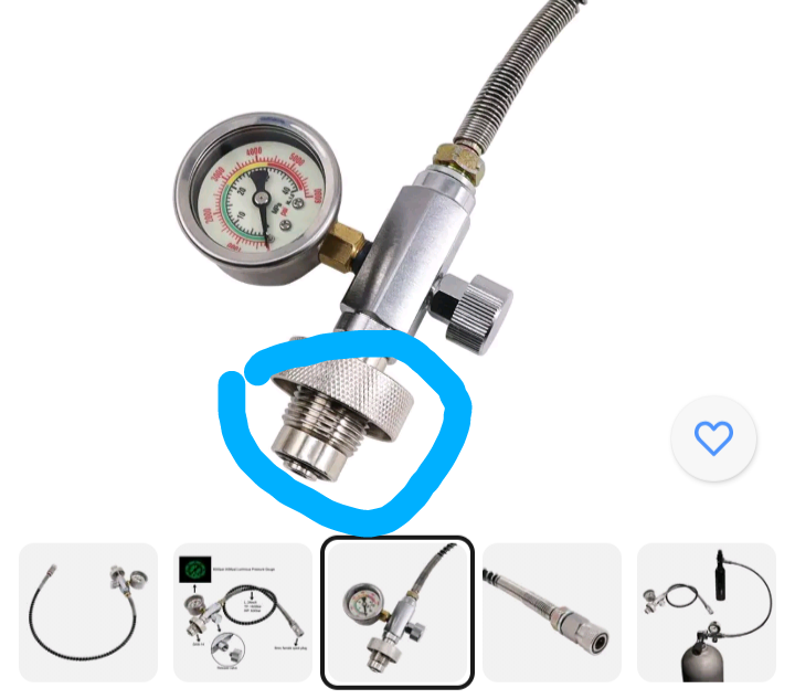

Yeah one time I testing my .401 airgun on it with balloon tank I held a air hose on it and the other end connected to the gun the power difference was insane but that doesn't work too well because it leaks on it on the air hose cause I have to hold it up on the fitting the balloon tanks are cga-580 I wonder if I could convert my cheap din 300 fill station to the cga-580 nut and then it would definitely work.
I don't know what the PSI is but probably less than 150 psi because the tanks are made of pretty thin steel.
I wonder if I could put the cga-580 nut and nipple into that fill station remove that fitting and put in the cga-580 nut and nipple.

Didn't really plan on feeding it through my 4500psin oil and water cooled Yong Heng compressor I was gonna try to hook up a fill station to a helium balloon tank.
For ignorant folks like myself, could you please define what you mean by "fill station"?
How are you going to get the necessary psi without a compressor? You definitely have me confused.
