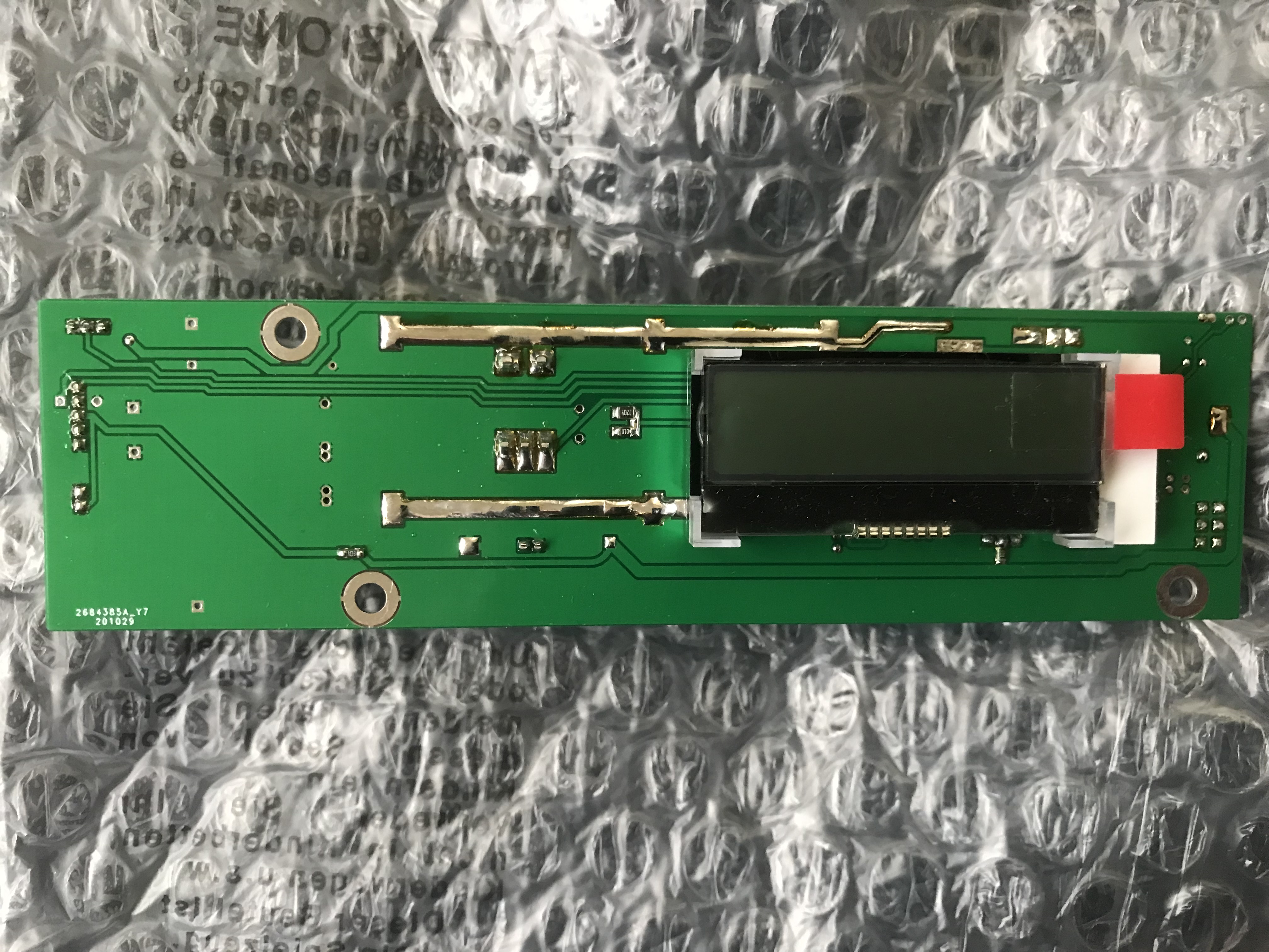

Bob, I want to be able to program my RW but not sure if the programer or a heli board are simple or complex
The Heliboard has 12 power levels that are fully independent and are programmed already in increasing power increments from Jack.... the manufacturer. The curves are pretty good already but you CAN work on them to flatten them a little more IF desired. Diminishing returns though. Changes can be made at any time with the trigger. I have them on our three rifles though it's really more about convenience than anything else. They also DO NOT time out so you can shoot without limitations on the timeout but it will KILL batteries if you don't shut it off. Ours are several years old and I understand the new ones have an Autotune feature that I've not had experience with. We also have experienced time limitations when fast firing from a magazine because it shuts the board off every time you open the bolt where the GCU2 does not but I have the potential fix in hand, just haven't tested yet. You can make velocity changes by changing the power level OR the voltage on the current power level. The voltage changes raise or lower the whole curve of that power level where dwell changes only affect the particular pressure point you choose to modify. There are 20 fixed pressure points.
The GCU2 has been updated and AoA can update the software in older ones. As far as I know, it does not have the time limitations and has more menu items, including settings for timeout.It does require minor disassembly and the programmer to make changes and only has 3 power levels. I highly encourage you to read through Spray1Mark's very complete tuning thread https://www.airgunnation.com/thread...out-properly-programming-the-redwolf.1047165/ and @Franklink had a good one on the Red Wolf Standard with GCU2 .
I have 4 calibers and a LOT of different ammo so the convenience of the Heliboard is important for me... not so much for the wife but she didn't like the timeouts.
You have to be the one to decide the pro's and con's for your own case.
Also, the Heliboard costs less than the programmer , so there's that .
Bob
The Heliboard has 12 power levels that are fully independent and are programmed already in increasing power increments from Jack.... the manufacturer. The curves are pretty good already but you CAN work on them to flatten them a little more IF desired. Diminishing returns though. Changes can be made at any time with the trigger. I have them on our three rifles though it's really more about convenience than anything else. They also DO NOT time out so you can shoot without limitations on the timeout but it will KILL batteries if you don't shut it off. Ours are several years old and I understand the new ones have an Autotune feature that I've not had experience with. We also have experienced time limitations when fast firing from a magazine because it shuts the board off every time you open the bolt where the GCU2 does not but I have the potential fix in hand, just haven't tested yet. You can make velocity changes by changing the power level OR the voltage on the current power level. The voltage changes raise or lower the whole curve of that power level where dwell changes only affect the particular pressure point you choose to modify. There are 20 fixed pressure levels.
The GCU2 has been updated and AoA can update the software in older ones. As far as I know, it does not have the time limitations and has more menu items, including settins for timeout.It does require minor disassembly and the programmer to make changes and only has 3 power levels. I highly encourage you to read through Spray1Mark's very complete tuning thread https://www.airgunnation.com/thread...out-properly-programming-the-redwolf.1047165/ and @Franklink had a good one on the Red Wolf Standard with GCU2 .
Bob

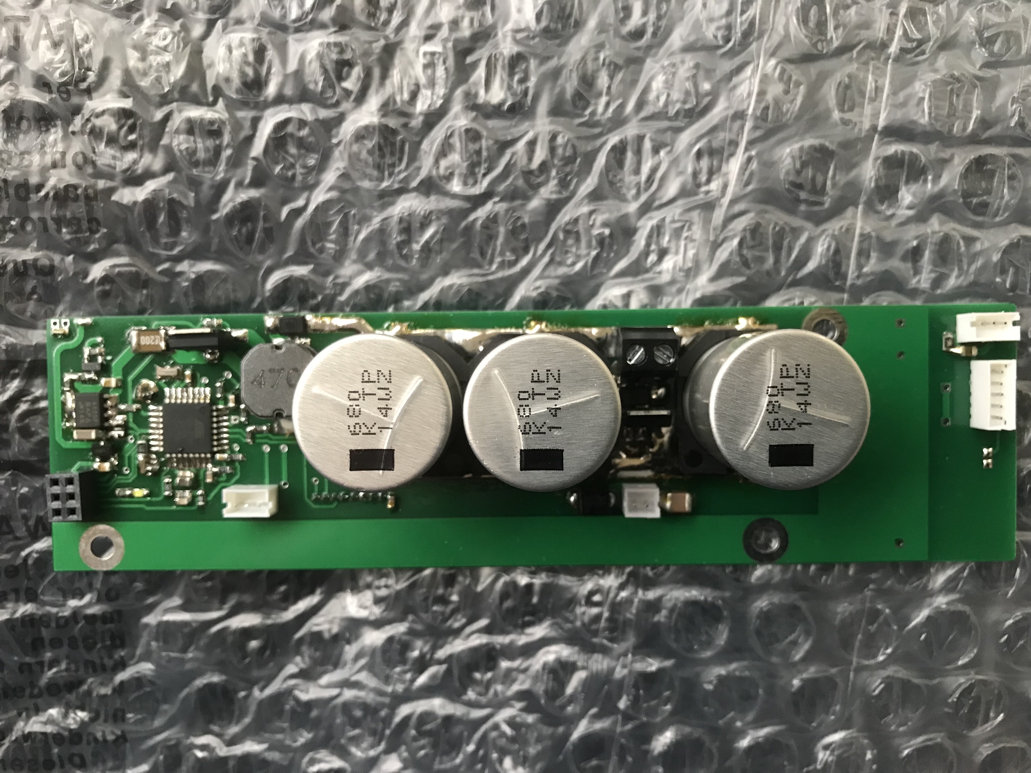

@Arzrover, is your potential fix for the heliboard timing out on each cycle of the cocking arm, the same as Lewis and I’s?
Our ‘fix’, which Lewis shared with me as he discovered it while we were engaged in a phone conversation, was to remove the cocking arm pivot screw, then retract lever/probe from the receiver, and lastly remove the large ball bearing (#37, 5mm diameter) that acts as a detent for the cocking lever in the closed position. Did you do this Bob?
With magazine shooting, and a fast trigger you could outrun the batteries’ ability to recharge the large capacitors, effectively putting the heliboard into programming mode. #37 Bearing removed, now the board does not shut off with each cycle of the lever, capacitor recovery is almost instantaneous, and if you were able to outrun the capacitor recovery, you would only be met with a dead trigger.
The trade off by removing the 5mm ball bearing is that you can dry fire the gun, with the cocking lever in any position. No worries here as my finger is off of the trigger whenever the action is open.
