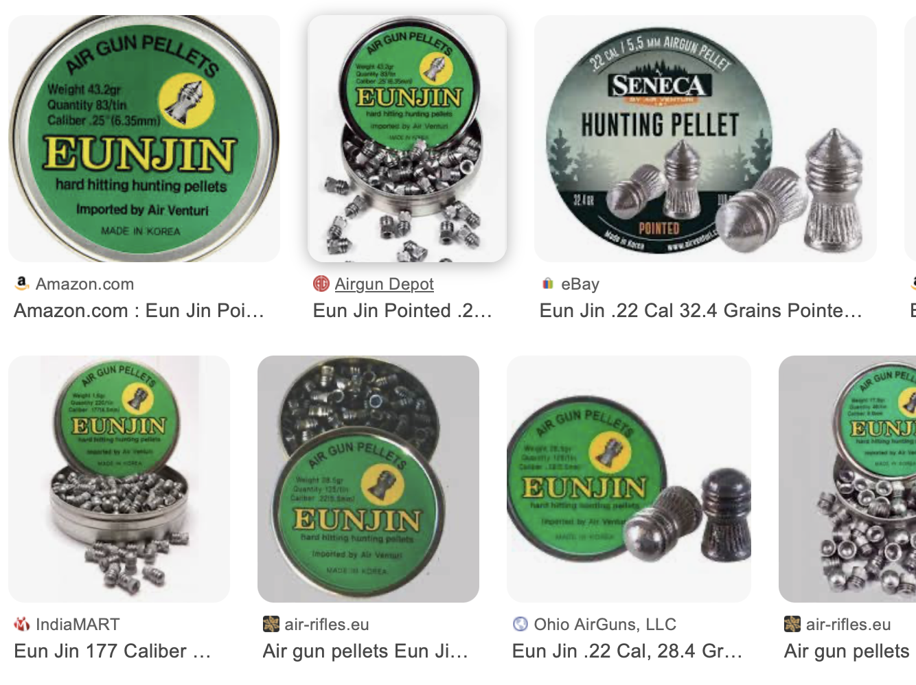

43.20gr
Seneca Hunting Pellet: Pointed
Rebranded by importer Air Ventury, from the original Eun Jin (South Korea).
➠ The point is just a stubby little rise of the tip.
35.80gr
Seneca Hunting Pellet: Semi-Wadcutter
Rebranded* by importer Air Ventury, from the original Eun Jin (South Korea).
➠ It's called "domed" but it's really a semi-wadcutter — which could provide for some interesting terminal performance.

43.20gr
35.80gr
