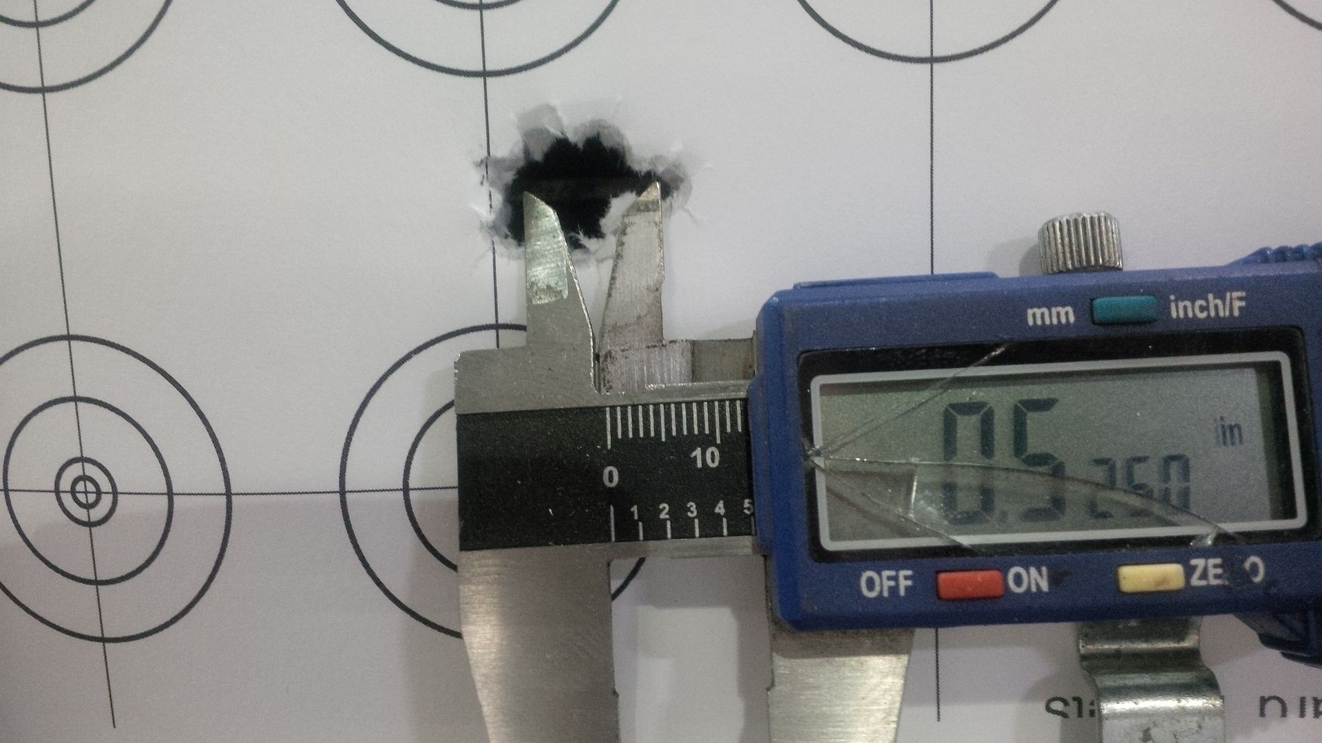

Does this equal accuracy or catastrophes. I have been testing and testing my cricket from 21 grains to 45 grains. It seems as though, the pellets don't do so well at higher speeds as well as the middle class pellets do. I thought I had found a pellet that really liked my barrel, the first five shots at 45 yds was right on point. Up there if not better then jsb's but after the first five it all fell apart. Pellets started going all over the place. I went from one raged hole to 11/2" grouping. I really was scratching my head on this one. 25.4 grns. To 31.0 grns. I'm not sure what I did different, so back to square one. What do you guys think? My gun is throwing these pellets out at around 975 fps. Best Steve

Sorry Scott, I should have been much more specific, my bad. I was originally shooting this gun at a speed of 975 fps w/JSB's I turned it down a bit worried I might of been pushing it to far. I tried to talk to Ernest with little luck. I reached out with several emails and he finally answered back and said he would call, but I never got that call. Anyway, so I tried to turn the gun down With just the hammer spring. It must of worked because the JSB 25.4 works really well. However, it did at the higher speed as well. 50 yds and I get a 3/8 hole pretty consistent. Then, I decided to see if there were heaver pellets that I could get the same accuracy out of and I would get a little more knock down power at longer ranges. So I set out to do just that. The ones in question, were the 31.02 Kodiak match. I really thought I had a winner. But after that first five. I cleaned my barrel with a pellet cleaner by Beeman, shot it out and and kept going on. Then I proceeded to shoot a ten shoot group with jsb's. Had no problems, loaded the gun with the kodiak's, first shot, money. second shot ok, I may have pulled it. Third shot went an inch in the opposite direction. Know I started scratching my skull. And so on, that's how my day went. Of course because I cleaned the barrel it could be that. But then why get the great accuracy from jsb's.
imagejpeg
