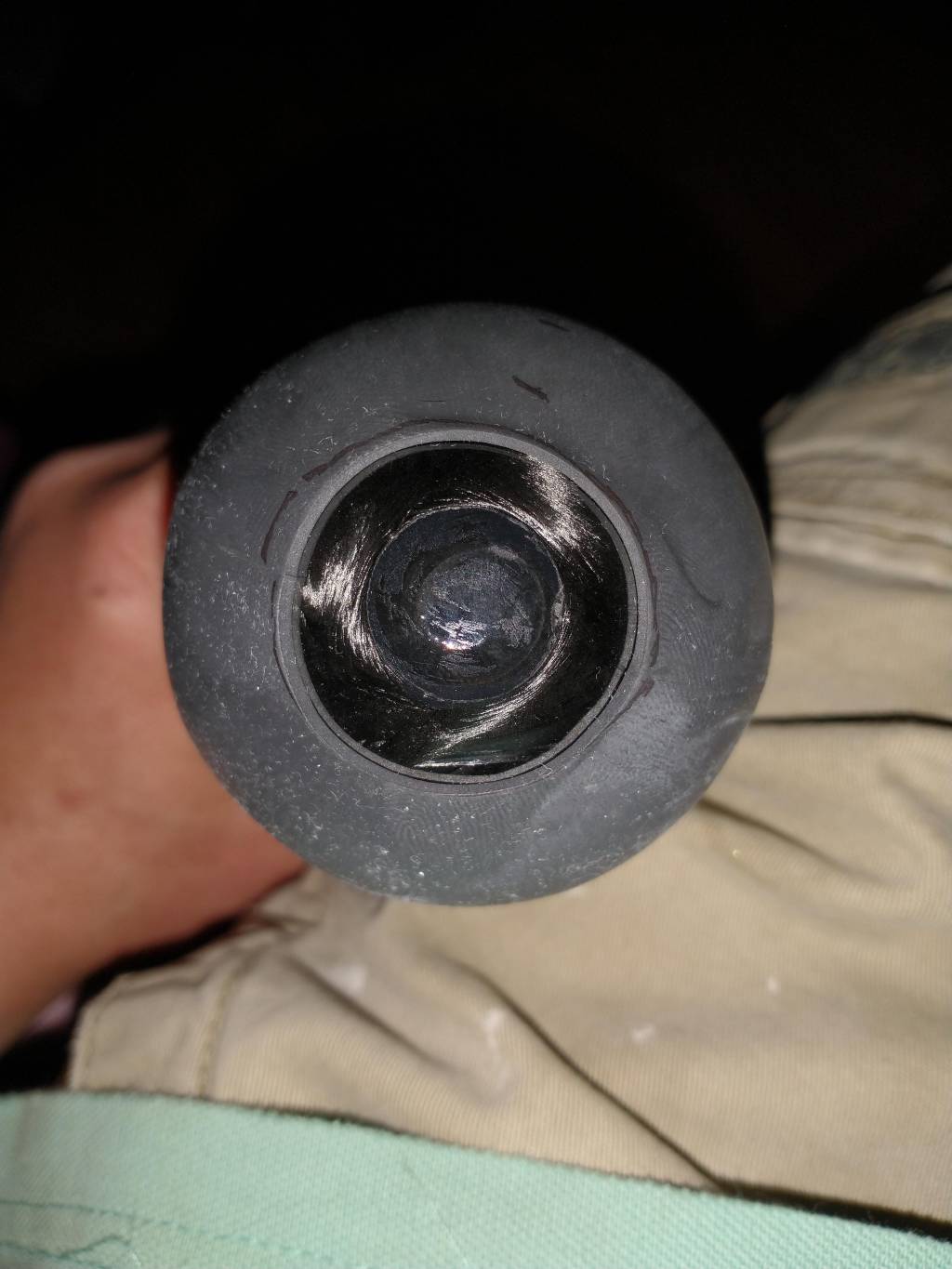

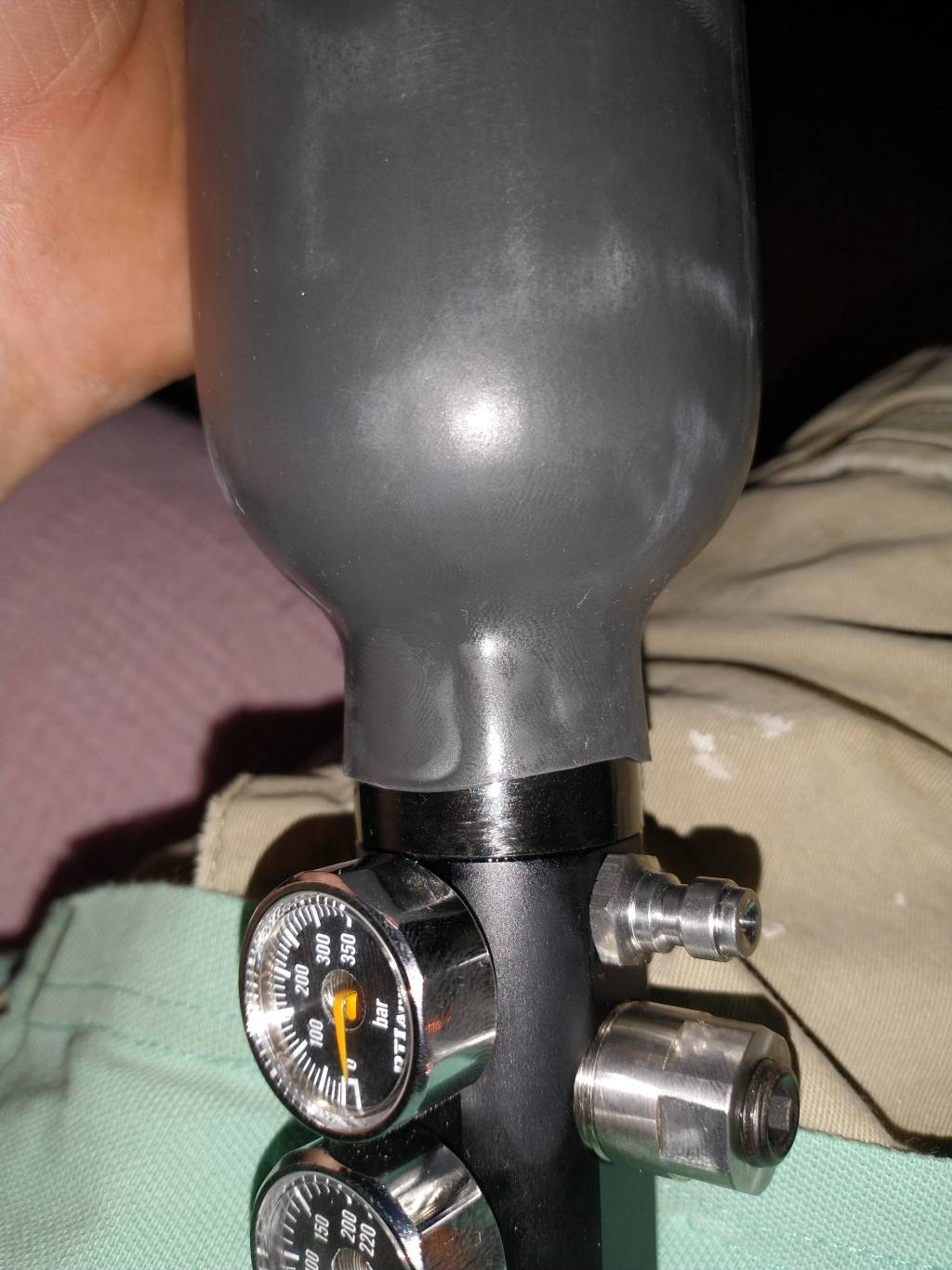

I know scratches and dings weaken carbon fiber bicycle frames so bottles probably are the same.
I'd been looking for a sleeve or wrap for protection. I think a British airgun co actually sells precut heat shrink for this purpose.
I ordered 3 to 1 non adhesive 3" diameter tube. A 5' section was $50 so not cheap but enough to do five bottles.
I thought it turned out pretty nice!
(In bold above), Absolutely correct.
Mike
So long as you always fill it yourself it is not a problem. Any Company that fills bottles needs to see the the date it was made and last hydro tested or they will not fill it.
Check with McMaster Carr -
"Clear" heat shrink tube is available. I just checked. And won't break the proverbial bank. Note the "after shrink" dimension !
https://www.mcmaster.com/heat-shrink-tubing/minimum-id-after-shrinking~range~~-5748746702503/
BUT, as biohazardman says, the people may still want the tubing removed for testing, but at least everyone can easily see the appropriate dates and pressures.
