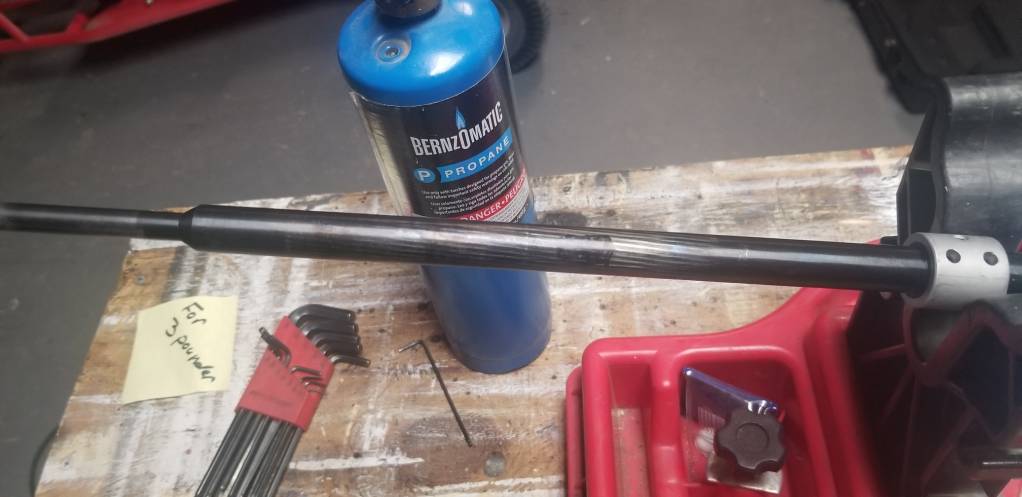

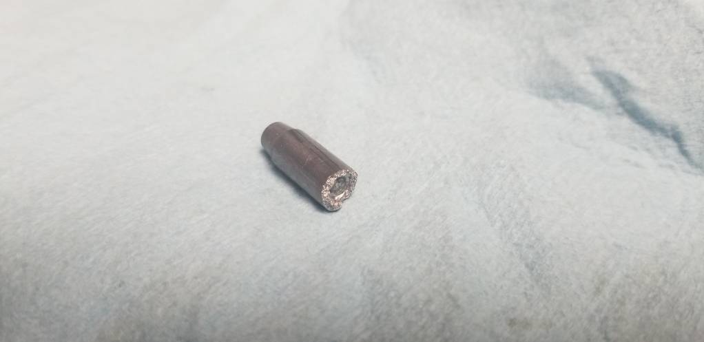

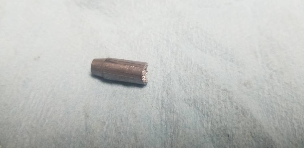

I got a slug stuck in my barrel on my .257 texan about a month ago and I decided to remove the slug tonight. I wasn't looking forward to removing the slug because I thought I double loaded two slugs and was thinking I had my work cut out for me. I removed the barrel and started hitting the cleaning rod hoping but I couldn't knock the slug out. I then started to carefully heat up the area where the slug was stuck but still the slug would not move. I had to applied a lot of heat to the barrel and I was finally able to remove one slug. I thought there were two slugs but was surprised there was only one. My question is: with the amount of heat I applied, did I just ruin my barrel? I don't think I did because these barrels are also used for PB's and they go through extreme heats with every shot.
To remove the temper from your barrel, you would have to heat it to nearly glowing hot. As stated, allow it it air cool naturally. If in doubt, apply additional heat to slow the cooling. It is best to heat a large area to spread the heat out rather than blast just the small area where the slug was stuck. Keep the heat gradient gentle.

Looking at the removed slug, it doesn't look like you got anywhere near the melting point. My guess is that you only warmed up the steel enough for it to expand enough to let the slug be driven out. You should be more than safe. Also if you have to melt out a slug you are left with a mess of lead to clean up in the lands and grooves. Your slug looks great.
