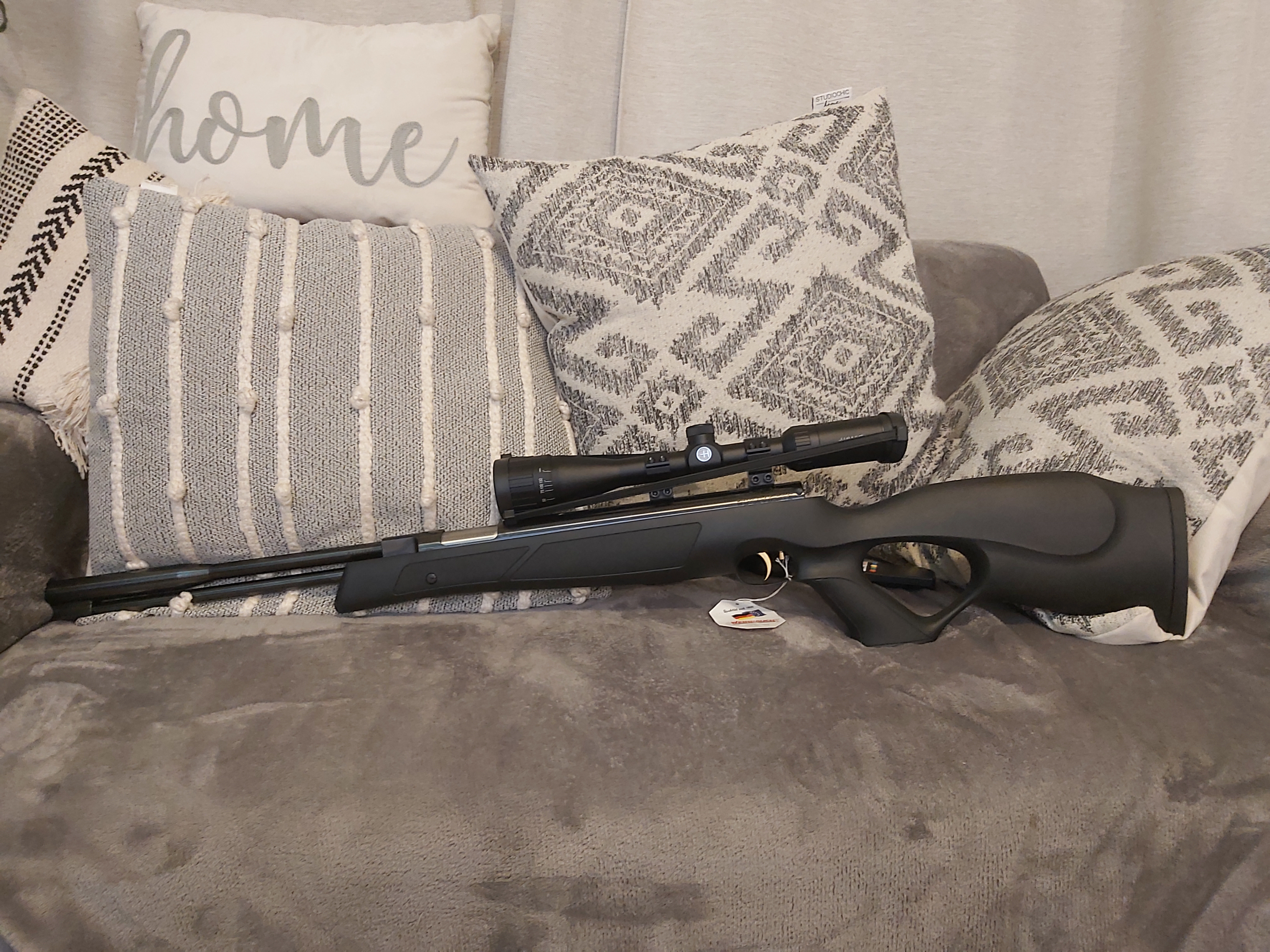

Hello friends of AGT.
Any recommendation for use in my hw97 .177 of pellets and head size, i know that each barrel is different but i think too that exist a commond or a majority.
