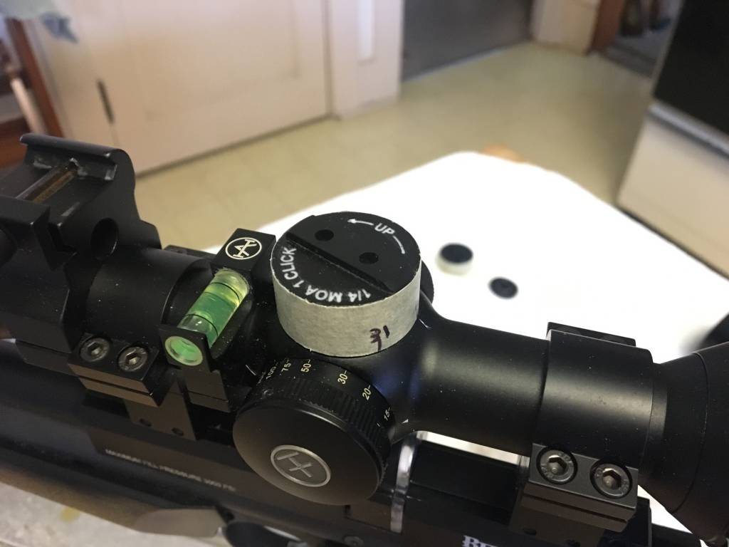

I made new bigger turret caps. So I could write the yardage down for hold over. If your interested in one. PM me.
