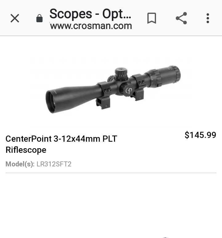

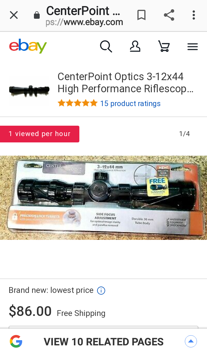

Believe it or not there are magnum Springer shooters who swear by their cheap UTG scopes on their guns. If thats believable I would opt for a Centerpoint version instead specifically this one and they carry a lifetime warranty too. Cheaper from EBay. It's a really nice cheap scope.
