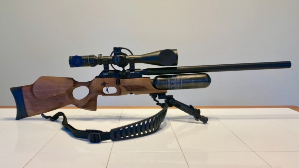

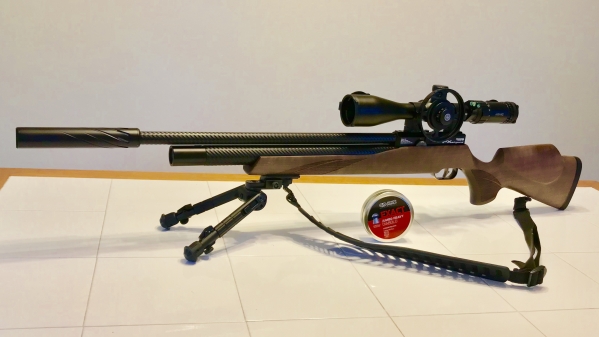

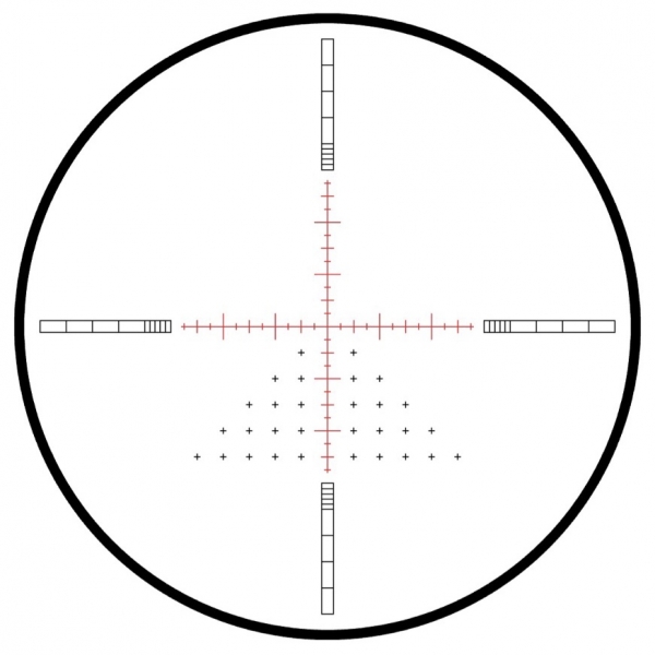

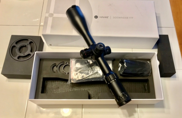

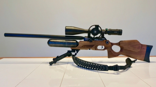

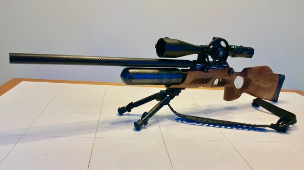

My game changer = the 2018 Hawke Sidewinder First Focal Plane 6-24 x 56!!! The scope I have been wishing for!!! I have been close to pulling the trigger on the Aztec Emerald scope because I really like its reticle and features, but this Hawke FFP has raised the bar with a very similar reticle but has illumination and its First Focal Plane! The reticle thickness is perfect zoomed in or out. Attached to my FX Crown Walnut .25 it is a match made in heaven! No more 10x zoom only, holding over at any magnification with no POI shift is magical!! How a scope should work. Oh boy! Anybody in the market for a new scope should take a serious look at these new Hawke Sidewinder First Focal Plane Scopes! I highly recommend them! The sidewinder platform has been around and is proven, may not be everyones cup of tea but I think its very good. Like it so much I ordered a second Sidewinder 4-16 x 50 FFP for my FX Streamline!
Pyramid Air links below:
https://www.pyramydair.com/s/a/Hawke_Sidewinder_FFP_6_24x56_Scope_FFP_MIL_IR_Reticle/8565
https://www.pyramydair.com/s/a/Hawke_Sidewinder_FFP_4_16x50_FFP_MIL_IR_Reticle/8564
Check out the pictures.

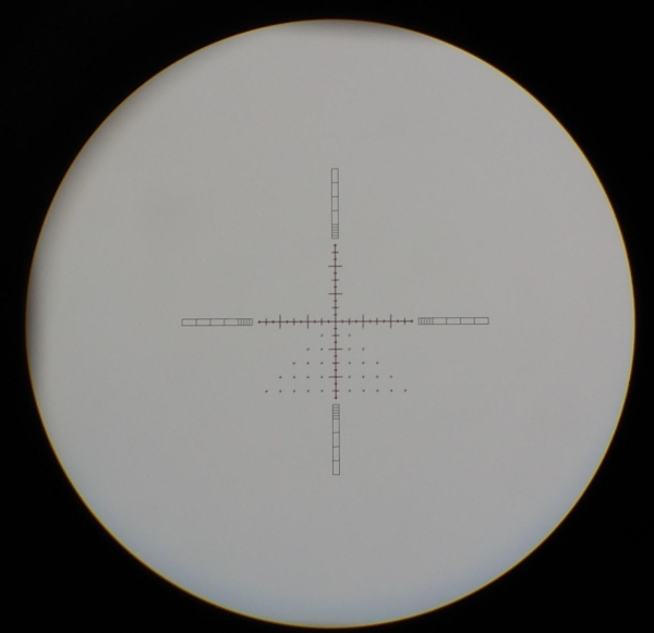

I have both the Athlon and the Hawke, and I like the reticle in the Athlon better. The numbers in the Athlon makes finding your holdovers much quicker. No counting marks, especially at lower magnification. I use the Hawke more as it has a threaded eyepiece that I can use to attach my Sony Camera. Otherwise, I would mount up the Athlon on my Impact. Coming from the smoke stick world, I miss the zero stop of the S&bs and Hensholdt scopes, but at 1/6 the price, I can learn to live without them. :)

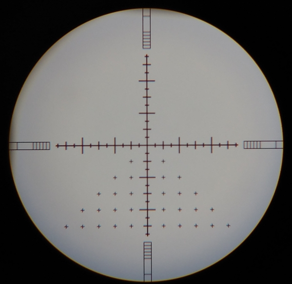

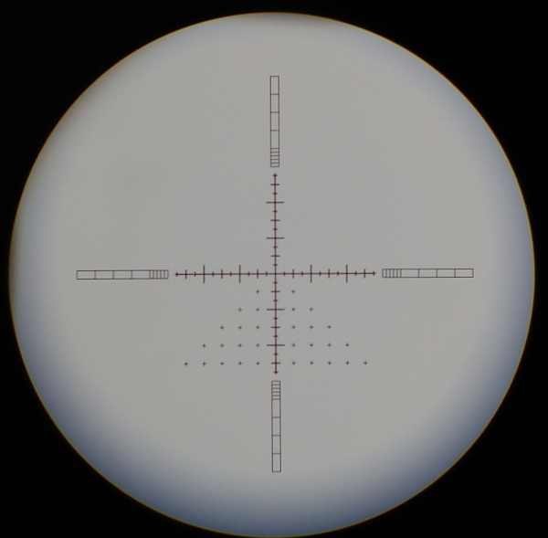

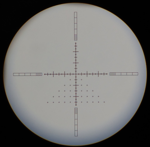

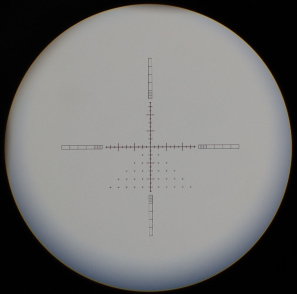

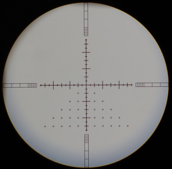

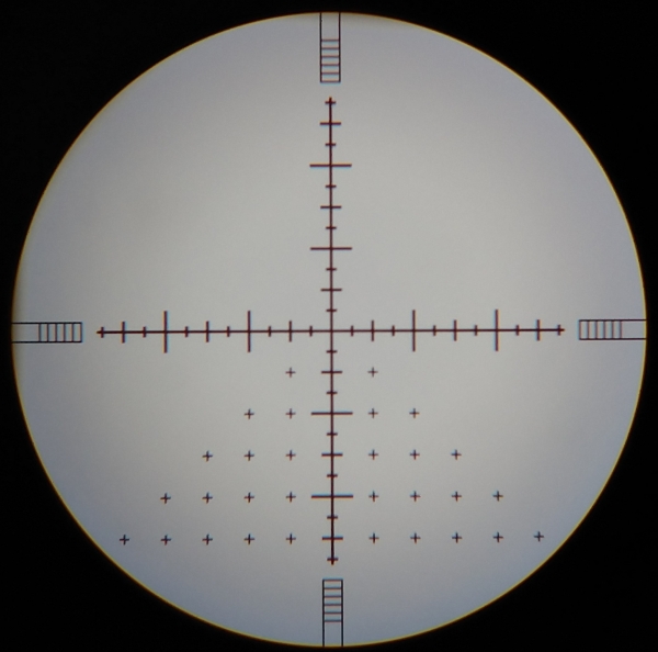

I've been asked what the reticle looks like at full magnification (24x), so here is a pic of that followed by what it looks like at the other magnifications.
24x
22x
20x
18x
16x
14x
12x
10x
8x
6x

I concur with Joe and Bob regarding the Hawke FFP scope. I've owned mine for several months now and absolutely love it! I just found an outstanding deal on a new one so I picked up a second one for my son's Wildcat build that I'm putting together for him. Anyway, right after I got the scope I did a pretty extensive comparison to the Athlon Argos BTR FFP scope (6-24x50) and the Hawke Airmax 6-24-50 scopes since I had them both at the same time. That post is here: https://www.airgunnation.com/topic/scope-review-hawke-sidewinder-ffp-6-24-x-56mm-vs-argos-airmax-30/ I do concur with the comment above too: I would prefer to have the numbers labeled on the full MIL hash marks for quicker reading (Looks like they've done this on the two newest FFP scopes Hawke just released)-but its a pretty minor complaint for an overall fantastic scope. Bob, There must have been a forum software change recently because none of my images or links are working either. Sean
