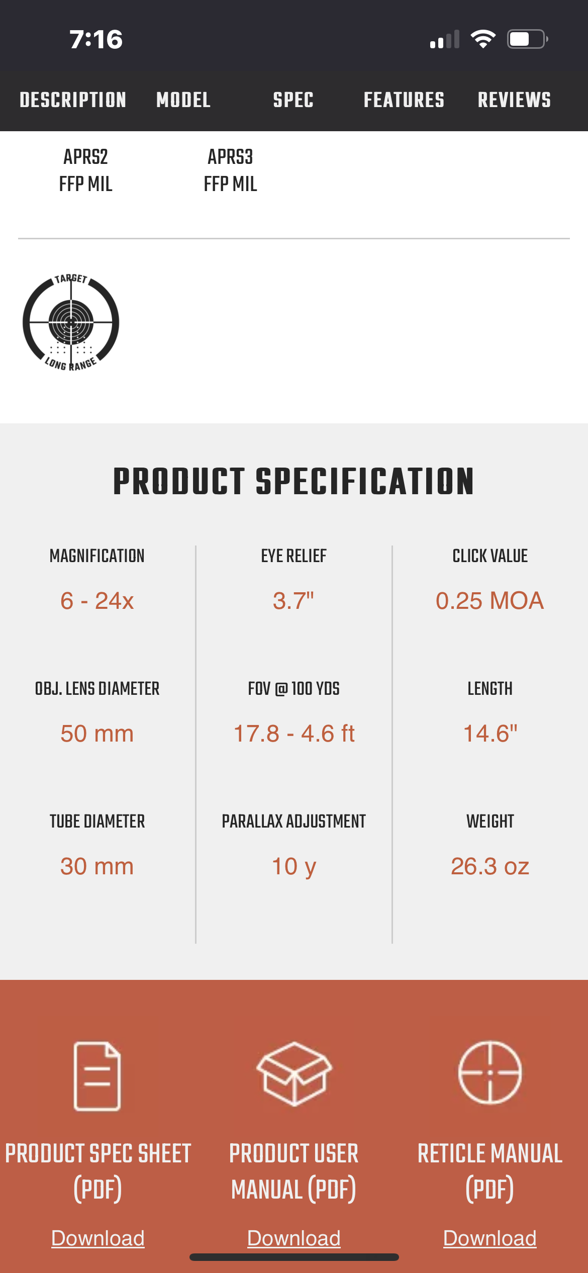

If shooting hft, the midas tac wouldn't be able to be used because according to AoA it's minimum parallax is 25 yards.
It’s 10y. Athlon website, and I have one.
Reactions: MysticalDragon
Ok good to know. I was in bed on the phone so couldnt look it up fully. I just went to AoA's site to look at it as I'm trying to decide on a second scope. I have an athlon argos on order and need a second one. Im considering the sidewinder and like that it comes with the parallax wheel already. I would love to do a $1000 scope but sadly getting started in pcp has been a bit expensive
