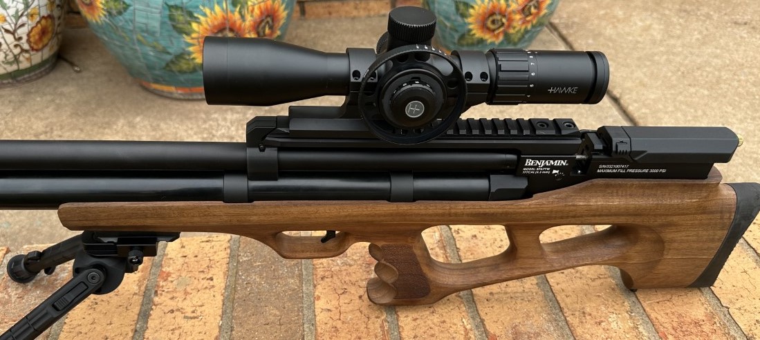

I am a big fan of the Hawke Airmax Compact SF 30mm scopes for all the reasons listed by bchannell's comprehensive post above. I have a 3X12-40 on my Benamin Akela bullpup and eye relief adjustment is critical. The long picatiny rail mounting point gives me plenty of adjustment, but not so much with my FX Crown Continuum where the adjustable comb height dials me right in. As bchannell mentioned above, using (for me BKL 300 high) 11mm dovetail rings on my Daystate is the ticket for proper eye relief. Since you already have a Hawke scope, you know how sweet is the illuminated reticle and side wheel parallax aduster. For the money, the compact version is my choice, in whatever power suits one's fancy.
