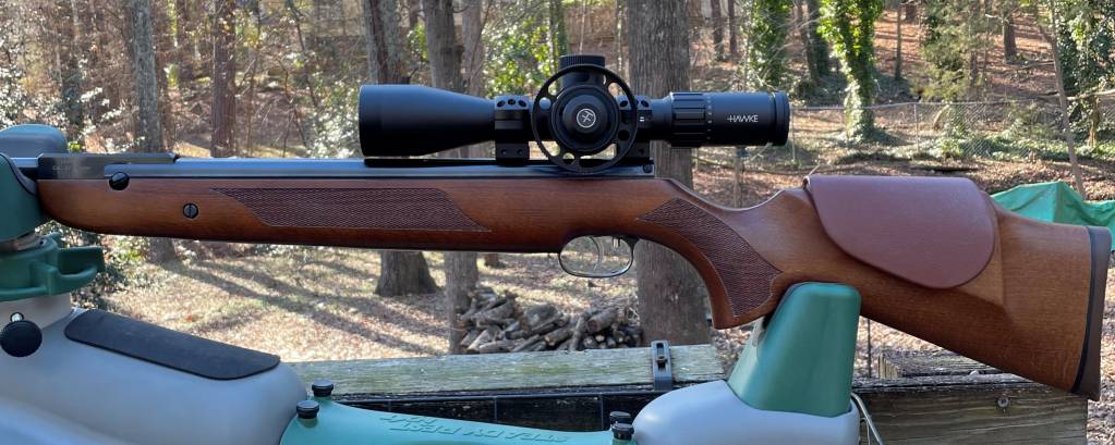

I installed a Hawke Airmax compact 4-16 x 44 mm IR, SF, scope on my HW85L. This is an excellent combo that is accurate and fun to shoot.
https://us.hawkeoptics.com/airmax-30-sf-compact-4-16x44-amx-ir.html
