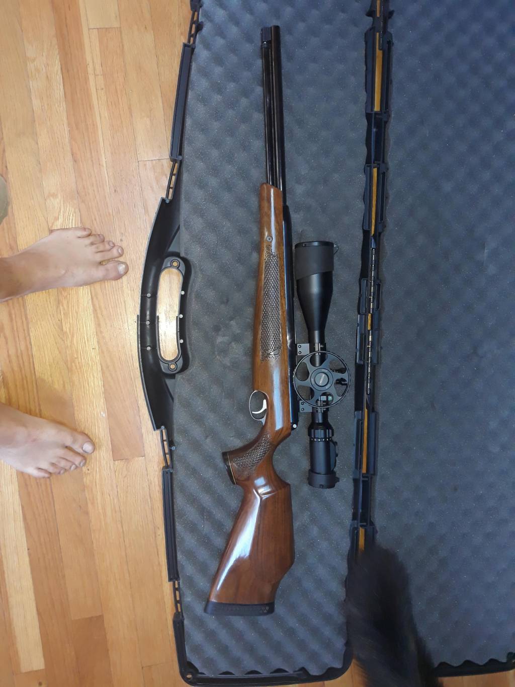

I have a utg 4x16x56 built in bubble level on my tx 200....I think if you go with the higher end utg your better off. This utg tracks perfect and as clear as my eyes can see plus it has a life warranty. If you are using a real hard recoil Springer then the utg would be my first choice but dont get the cheapest ones they sell.....pick the one you want online and shop around . I bought mine on amazon for $187 with prime free shipping . Ps try to get a 30mm model rather than a 1 inch version.
This is a pic of it ....I only own one utg and I have had zero buyers remorse . My friend has the same exact setup on his tx and keep in mind this exact setup won the US field target championship two yrs in a row a few yrs back.
