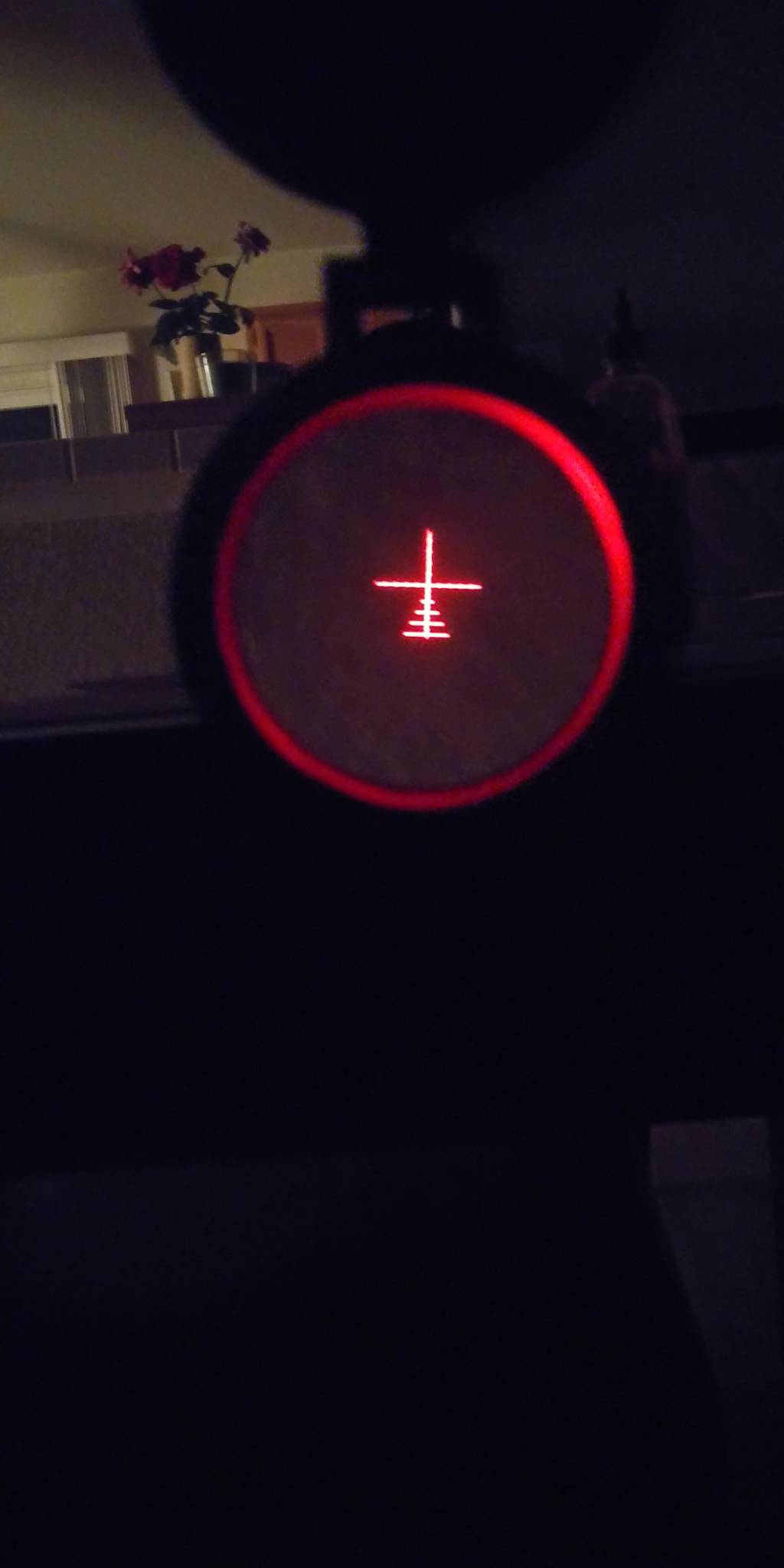

I just got the newly released Hawke Airmax 30 SF WA 6-24x50 and a little disappointed with the illumination of the reticle. The illumination lights up the whole eye / ocular lens creating a halo and I'm not sure it's supposed to be this way, or its a design flaw, or its a defect. This is my first Airmax so I don't know what to expect. I hope anybody with an Airmax with IR can chime in. See below picture for what I'm talking about.

I didn't get the chance to resolve the issue, But I saw another review on YouTube from Bakers Airgun with the same issue in the daylight situation on highest illumination setting. You won't see the full ring in daylight situation but there will be bright spots. My bright spot is on the upper right/ 2 o'clock position as shown in the original picture above while the Bakers Aigun you tube video is on the upper left/ 10 o'clock position.
